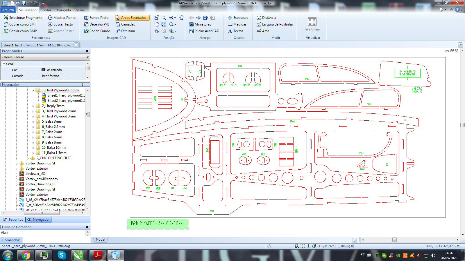

Hi Alex i have other question
On folderVortex_Drawings_BF \ Vortex_Drawings_BF \ 1_LASER CUTTING FILES \ 1_Hard Plywood 1.5mm
This folder 1_Hard Plywood 1.5mm for balsa 1.5mm he will connect with fuselagem 3mm why this folder is front part Vortex will work plug connect 1.5m to 3mm?
Attachment 2267487
Attachment 2267488
Alex Voicu 05-28-2020 10:48 AM
[QUOTE=AndersonR;12607801]Hi Alex i have other question
[QUOTE]
Sorry, i'm not sure i understand the question. As specified in the name of the sheet and folder, these parts are made of 1.5mm plywood, not balsa. The 3mm balsa sidewalls will cover the fuselage from firewall to tail, so that includes the 1.5mm plywood parts in your pictures.

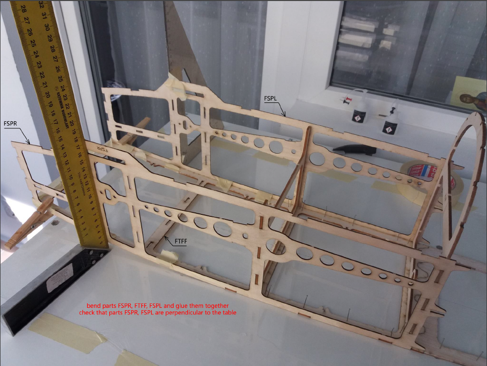

GorillaToast 09-21-2020 11:09 AM
Alex, I just want to say that this build thread is very informative. Thanks so much for posting it.
One quick question... in the first page, you have pictures of the fuselage construction and it looks like you are holding the bottom pieces down to a melamine topped building board with straight pins. Is that correct? I can't even begin to get a T-pin to go into melamine.
