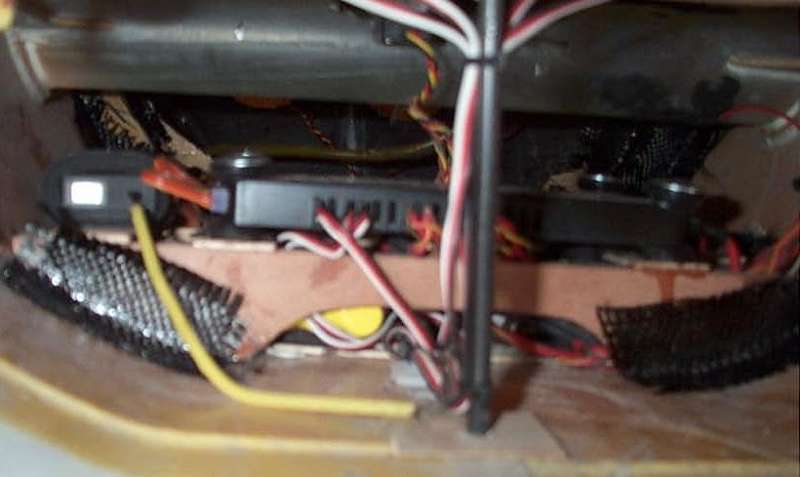

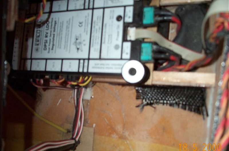

Okay, time for some installation pictures.
Photos here are of the Emcotec unit. Note the clean installation possible with the servo leads coming out the sides of the unit, how everything seems to "Fit" the airframe, and how there is plenty of room. the power leads and switch plug go in one end, the receiver leads go in the other, and the servo leads come out the sides. There is an airgap of about 3/8" between the Emcotec unit and the mounting frame, and the frame is about 1.25" tall overall, giving me a place to install the battery packs underneath the Emcotec.
I'll have details of how the unit works and some of it's features later.
Pic one shows a long view from behind the pilot figure, of the installation
Pic two shows the Receiver and leads to it
Pic three shows the power, electronic switch and servo leads along one side of the unit
Pic 4 shows the airgaps under the unit, as well as the batteries plainly visible underneath it.

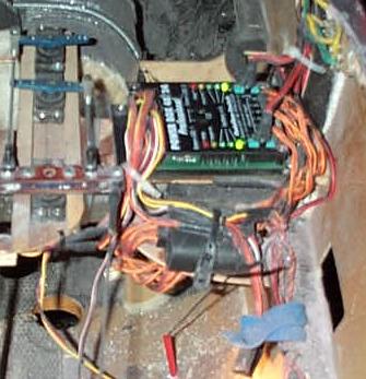

Now the installation of the Powerbox 40/24 unit. The powerbox itself is more compact, but the way the leads are routed makes it more difficult to get a "clean" looking installation, especially with a 10-15 servo setup and a single lead for each servo. Yes, somewhere in there is a powerbox, receiver, and the power wires from the switches. I'm sure the installation would look much neater if I put it on the floor of the plane in the same manner I mounted the Emcotec. In this plane, however, since it's a 40% Composite ARf (normal weight layup) powered by the ultra-lightweight BME110, I needed to shift the weight as far forward as possible. To that end the Powerbox was mounted on the wing tube sleeve, the batteries in the forward part of the motorbox, and even the receiver as far forward as accessibility and space would allow. It made for a rather "tight" installation.
I want everyone to know that these pictures were taken in the middle of a mild drizzle, as I pulled the plane out of my van, removed the canopy, took some quick shots, and then put everything back away. The things I do for this hobby ! ! !

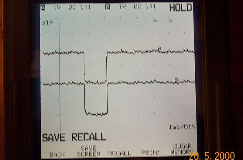

Agreed, Michael, Gerhard made a boo boo, as looking at the picture of the Powerbox "Competition" unit pictured on the Duralite website distinctly shows a "Logic cable" from t he switch assembly to the powerbox, meaning that the switching and power management are similar to the Emcotec unit.
The attached picture shows what you get when Emcotec says "amplified signal" This picture is of a Fluke 98 digital o-scope screen, showing input/output from the Emcotec unit on the Throttle channel. As you can see the pulse has very little, if any, amplification. The input signal (channel A) is about 1.8 volts in amplitude, and the signal out (Channel B) is 1.9-2 volts, though it's hard to see without a lot of study. This is not a lot of amplification, though the signal is definitely slightly different (note the "noise" spikes and how they do not coincide exactly) showing that it is definitely going through a filter/amplifier of some sort, which nullifies feedback along the signal wire. A straight-through signal would be an exact duplicate of it's partner.
So, yes, the signal goes through a "stage" inside the Emcotec box, that mildly amplifies it and nullifies feedback, though the effect of the amplification, in this instance, is a factor of less than 10%.
