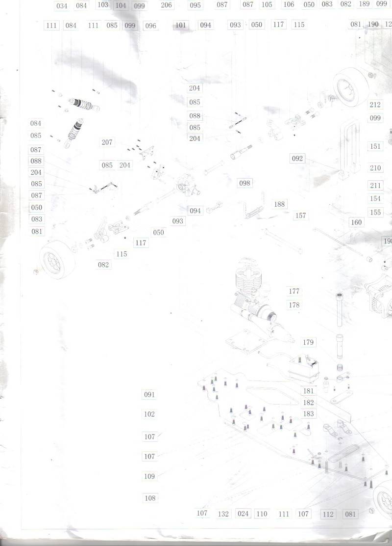

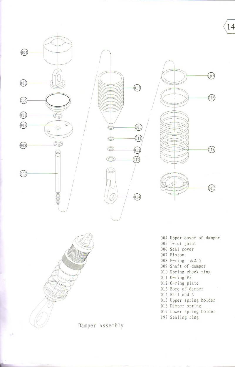

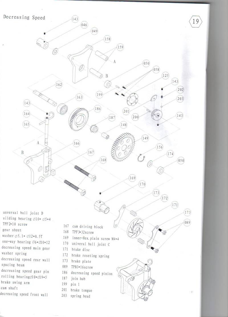

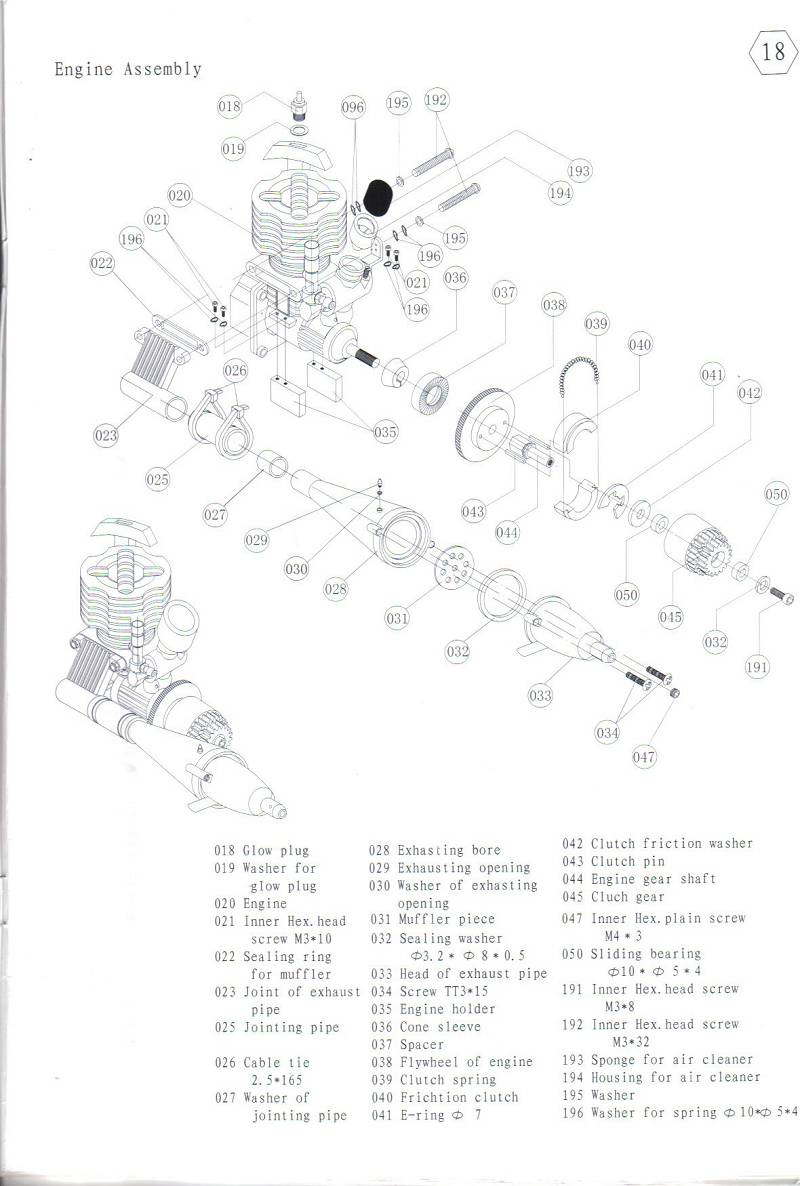

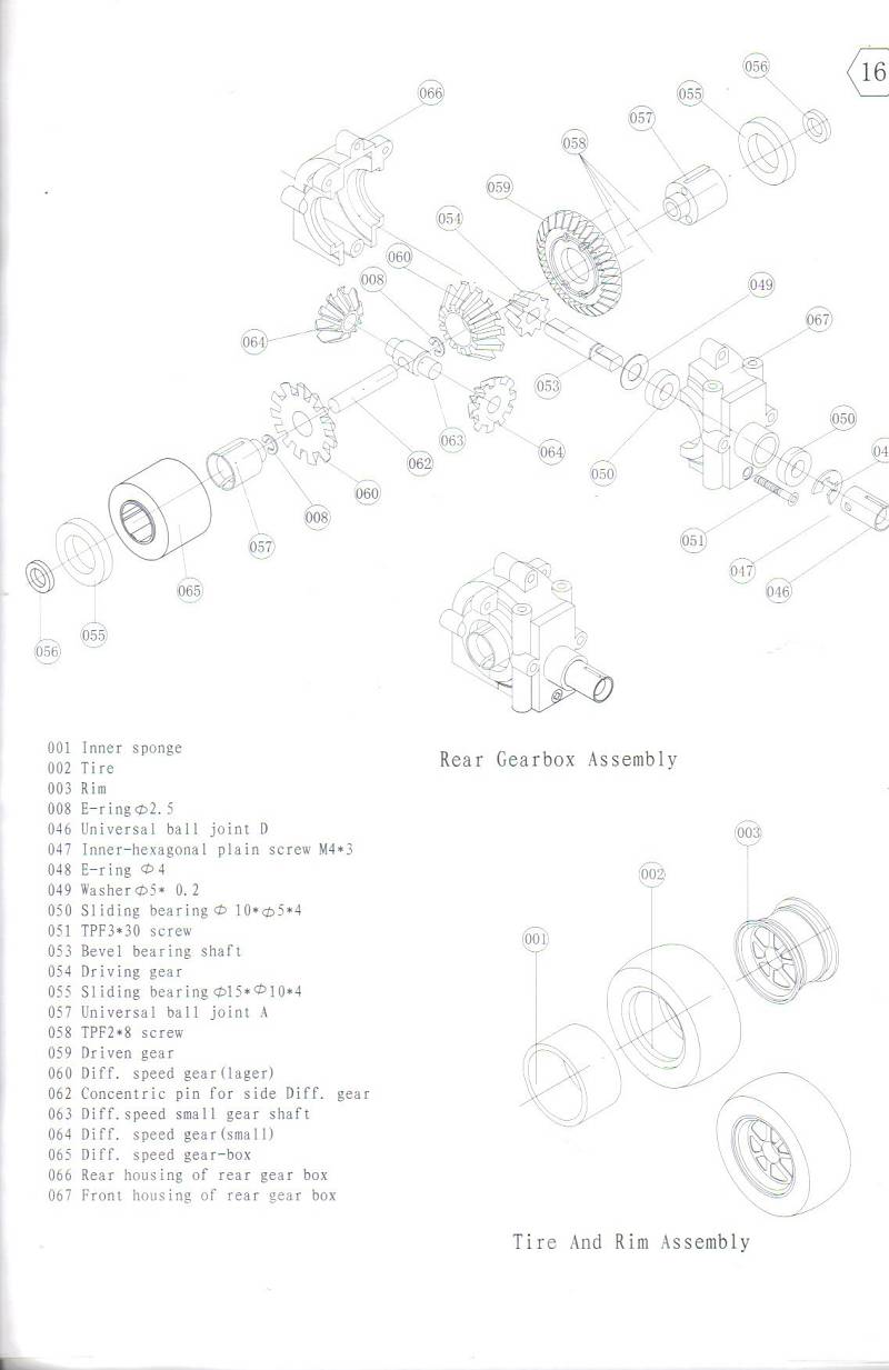

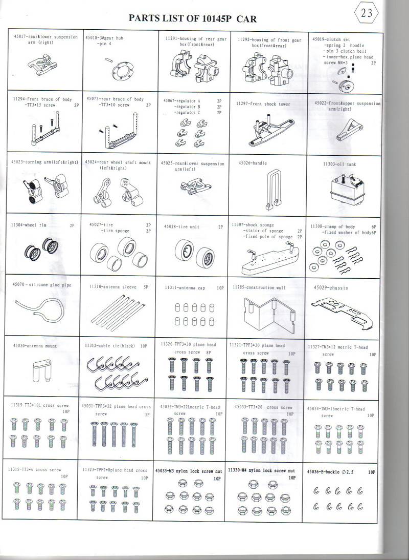

next
ID:	400894   Click image for larger version
ID:	400895   Click image for larger version
ID:	400896   Click image for larger version
Old 02-02-2006 | 11:09 PM
  #1502
popparipper's Avatar
Joined: Nov 2005
Posts: 272
From: toronto, ON, CANADA
Default RE: Official Smartech Thread
next
ID:	400898   Click image for larger version
ID:	400899   Click image for larger version
ID:	400900   Click image for larger version
Old 02-02-2006 | 11:11 PM
  #1503
Joined: Nov 2005
Posts: 272
next
ID:	400902   Click image for larger version
ID:	400903   Click image for larger version
ID:	400904   Click image for larger version
Old 02-02-2006 | 11:13 PM
  #1504
Joined: Nov 2005
Posts: 272
next
ID:	400906   Click image for larger version
ID:	400907   Click image for larger version
ID:	400908   Click image for larger version
Old 02-02-2006 | 11:15 PM
  #1505
Joined: Nov 2005
Posts: 272

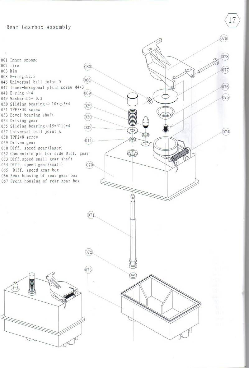

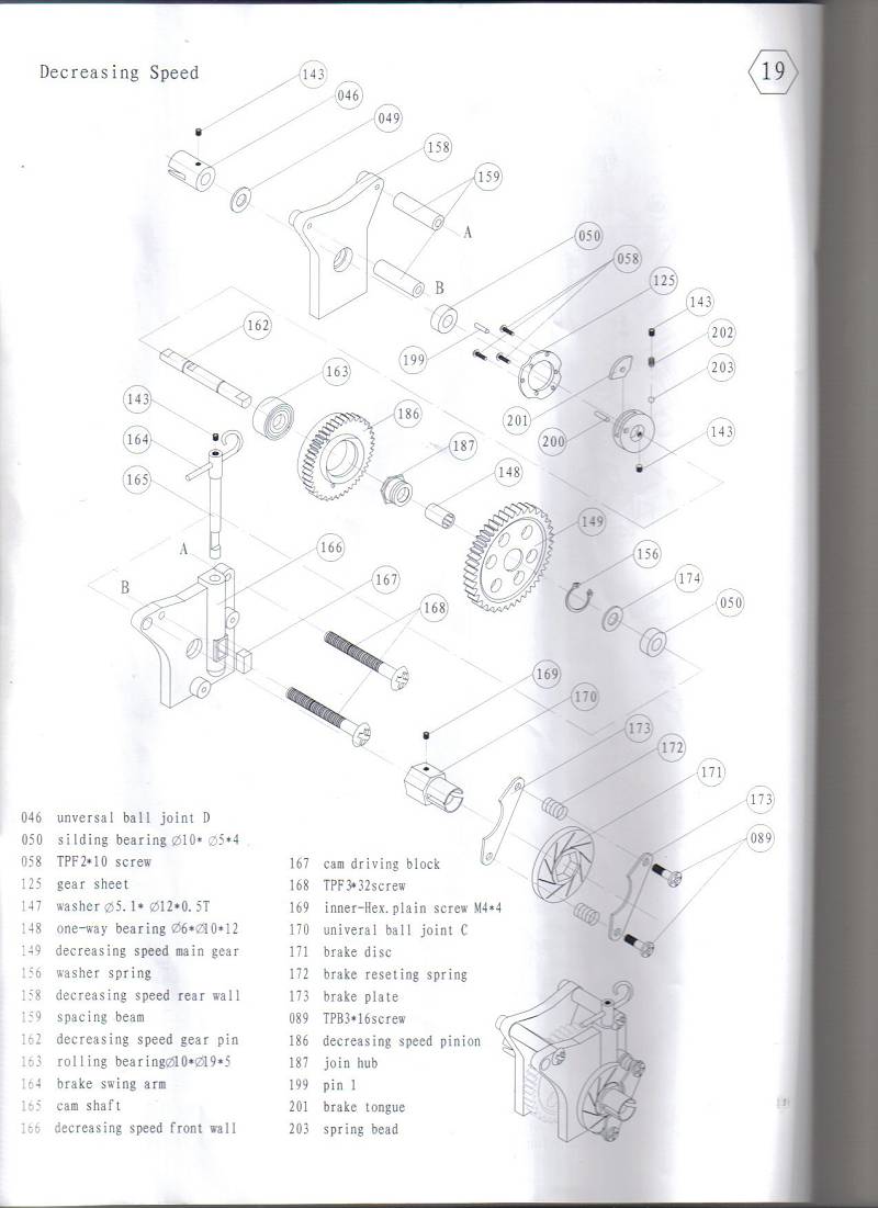

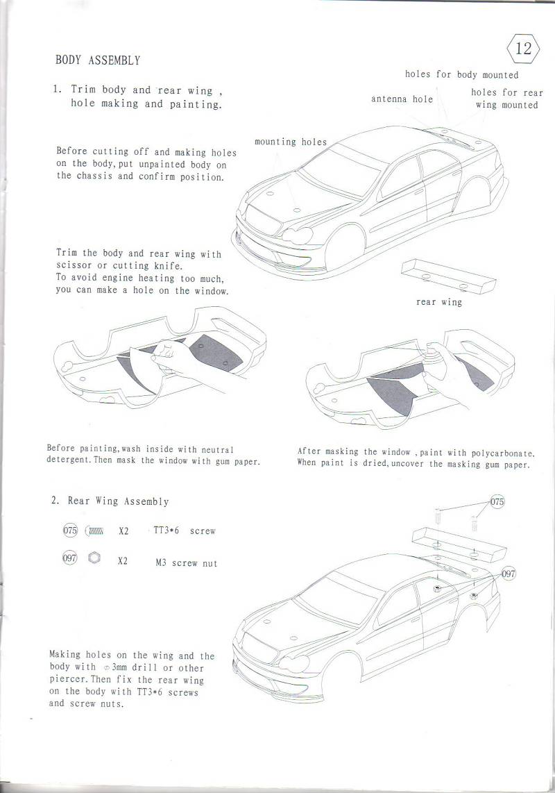

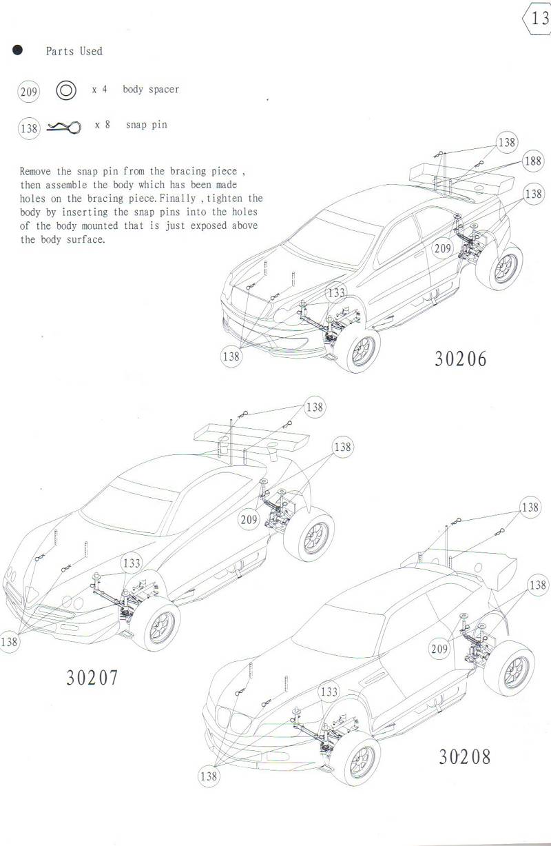

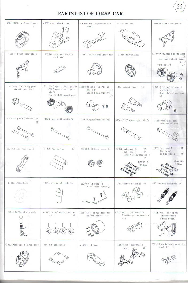

last 1s hope this helps you guys and gals out there
ID:	400910   Click image for larger version

popparipper....
I have my FSM(factor service manual) but I couldn't read some of your scans (even exploded)
well i know but the service manual is done very lightly if you need somthing just ask and ill flip through find it the rewrite it
