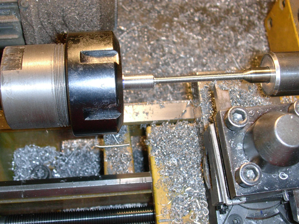

Hi mustang I,m building my own electric retracts for a 90" span model could you tell me what motors and gearboxes you used and where to source them.<div>
</div><div>I have built mine using precision rolled 5mm ACME lead screws but to keep costs down made my own lead srew nuts. I did this because I know a couple of modellers that have fitted commercial units and suffered lock up or lock down which I think is due to them being fitted with standard screw threads, which is of course what screw threads are supposed to do when they are tightened.</div><div>
</div><div>Thanks</div>

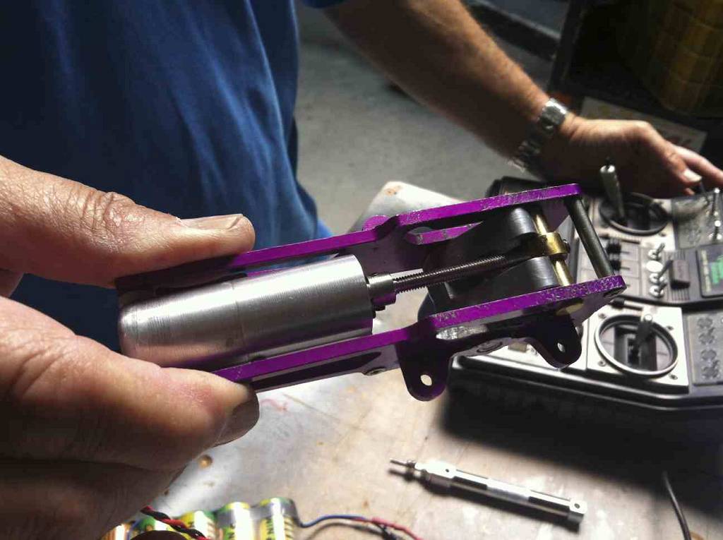

Hi Windy, I have converted to electric a BVM gear for mi scratch Balsa Bandit and I have make my own M-4x70 thread rods in the lathe. I have logged 3 fligths, today and tomorrow a few more
, and no issues. I attach some pics.
BR
Jesus A. Serrano
, and no issues. I attach some pics.BR
Jesus A. Serrano

I haven't converted anything I just made the whole lot. I'll try to get some pics and post them.
What motors are you using. I,m using some of the Pololu motors and gearboxs can't rememember what ratios though.
As I said I am using acme lead screws as these aren't to expensive I could have cut my own screw threads as you have I just felt proper lead screws would be more reliable. The problem is the nuts for these are really expensive so I made my own nuts from acetal and it took just a couple of minutes each to form the acme thread. A breeze really.
I do have a couple of friends that have fitted commercial units with standard threads and they say on occasion when they hit the end stops they do some times get jammed. So I thought I'd try to avoid that from the word go. And they work great. I have intentionally driven them into the end stops to the point of almost destroying the motor and gearbox as a test and they have never yet got stuck.
Windy
Windy
Hi Windy,
the gear motors are from Pololu at 1:35 gear reduction:
http://www.pololu.com/catalog/product/1091
and the electronics is RB-45 from Electron retracts. I put a couple of "O" rings at each end stops in the threaded rod and any issues. The thread rod is made of F-210 (foral steel)
and the pin from brass.
Jesus A.Serrano
Jesus A.Serrano

Jesus a couple of pics of my retracts as promised I think your using the same motors as me then, I think with a different ratio though but can't be sure though as I can't remember .
The other thing I also chose to do was to use a curved locking pin guide slot as I wasn't to sure of the power of the motors and with a curved slot the leaverage is basically constant over the full movement of the retract, this does make the unit a bit bulkier but I wasn't to worried about this as there's plenty of room in the wing. The oleos you see are for the moment just solid aluminium bar 20mm dia.. The wheels are Dubro 4.5" dia. not the lightest in the world but they'll do. I intend to remove the plastic hubs and make my own from ali with brakes.
The model these are intended for is a 90" span Fairey Gannet. I have already made the contra prop unit which also has variable pitch to both props. The next challenge will be the electric folding wings, these fold in two places which should prove interesting. I intend to use a similar system to the retracts for these again controlled by the Arduino.
Windy, don't worry about the power of this Pololu gear motors, but for your Fairey I guess you must select a 50:1 reduction. I have had any minor issues with the BVM gear conversion, so my next proyect, a 2,20 m. scratch build Viper jet will fit my own retracts with a linear pin guide and a thread rod supported by two small ball bearings. Is the system used by Electron Retracts and this guys have a lot of experience. Just my 2 cents.
Jesus A. Serrano

Windy i bought my motors from Uxcell online 6v 220 rpm. i use a standard m4 threaded bar. i run the motors on a three cell lipo so i'm puting more voltage through them than recommended but to date they are still wotking fine.

Cheers for that Mustang I must admit I have run mine on 3 cells but thought it a bit fast so have used it on 2 cells since, but everything thing seems fine so far. Nice to hear your ok on 4mm thread I'll probably stick with the acme though because there not that expensive and are really smooth in operation and the way I make the nuts there's no backlash at all and as I said i can form the thread in each nut in less than 2 mins. Although machining the the outer part of the nut and the guide pin block takes a bit of time so all in all probably works out about the same overall time as cutting my own screws.
The pitch on these screws is a bit courser though at 1.25mm as opposed to 0.7 for 4mm thread. but they are beautifully made though, precision rolled from 303 stainless and a 125mm length is just £14. The price of a nut though was a bit high, I think about 50 odd pounds each, which is why I decided to experiment with making my own nuts from acetal (the bought nuts are made from some plastic also), and it proved to be remarkably easy to do. And I think that the loads that these are likely to be subjected to acetal is more than adequate.
I,m gonna copy your sketch and give it a try. This is my first foray into the Arduino and programming.
Windy
