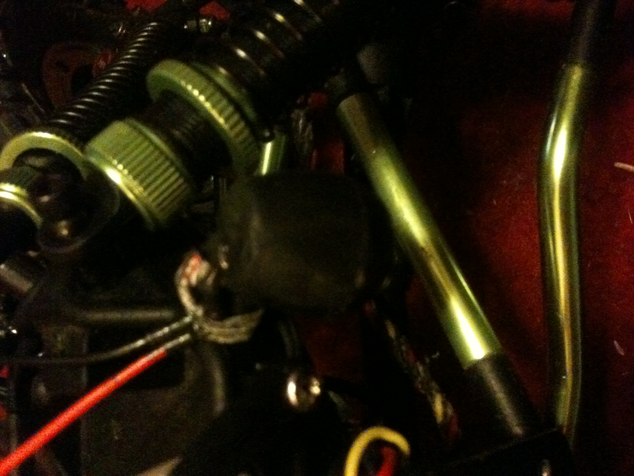

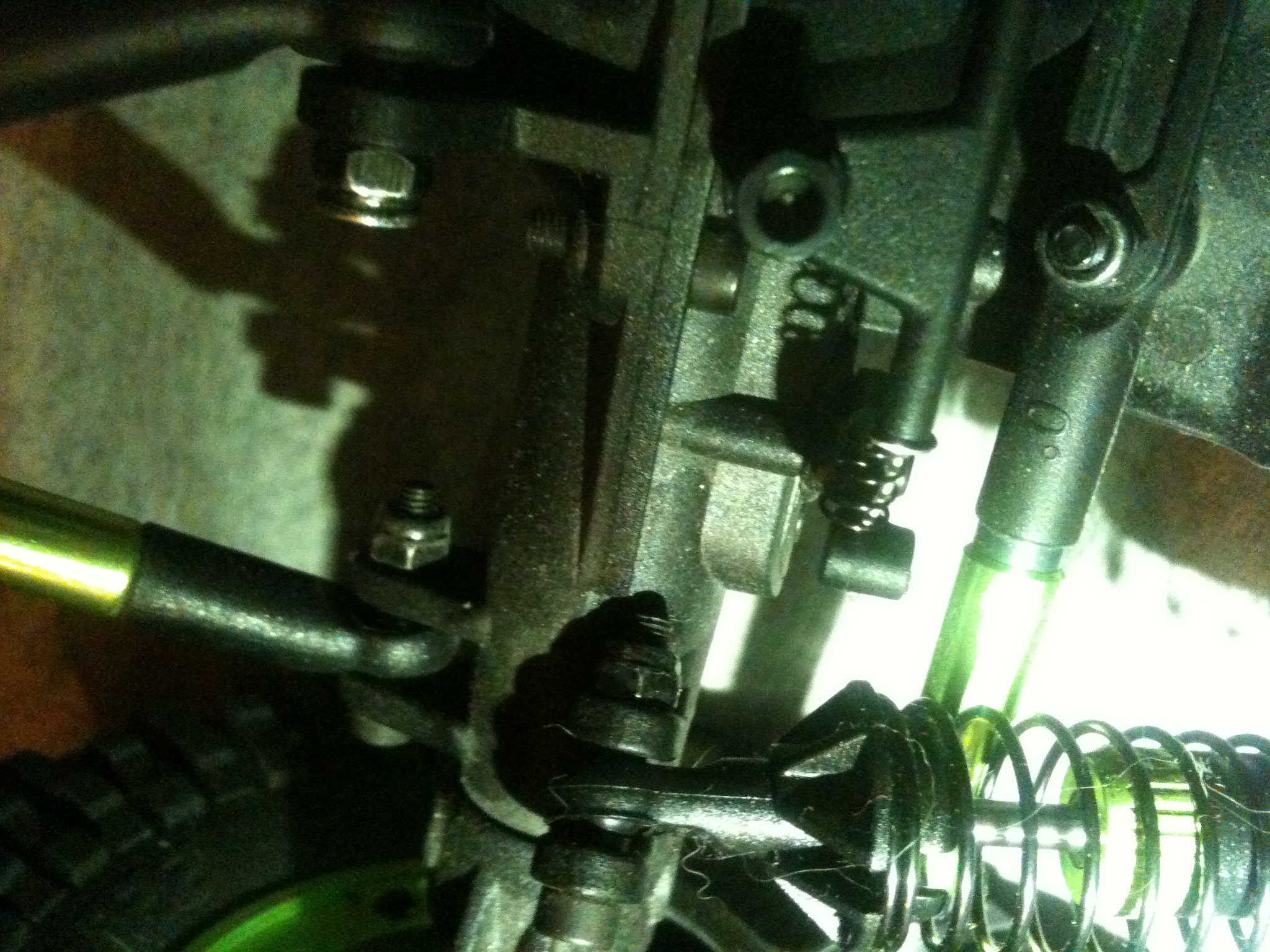

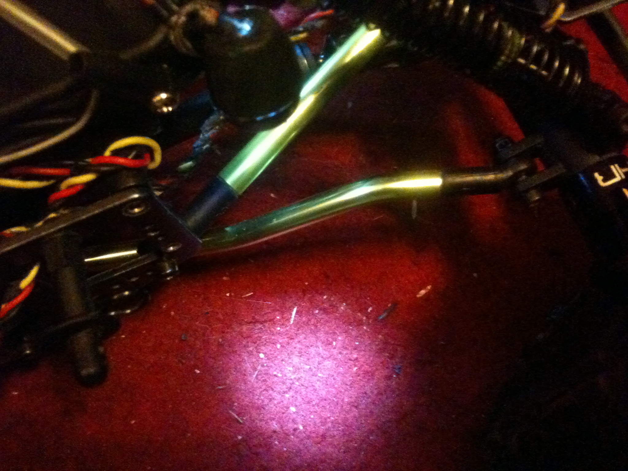

just a few pic's of some creeper work.
another short cable.i don't think they measure the cable or the tube before the send them out.
the little spring by the switch lever needs to be a bit bigger.
wonder if they make a mg mini servo to replace the stock one with.

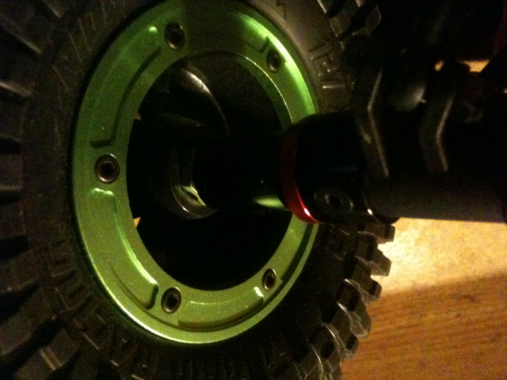

need a bearing for one of the rear lock outs.
kinda hard to see but that is a lot of room for that axle to be moving.
so a bearing for that and shims for both rear lock outs. the axles slide in and out a bit to much.

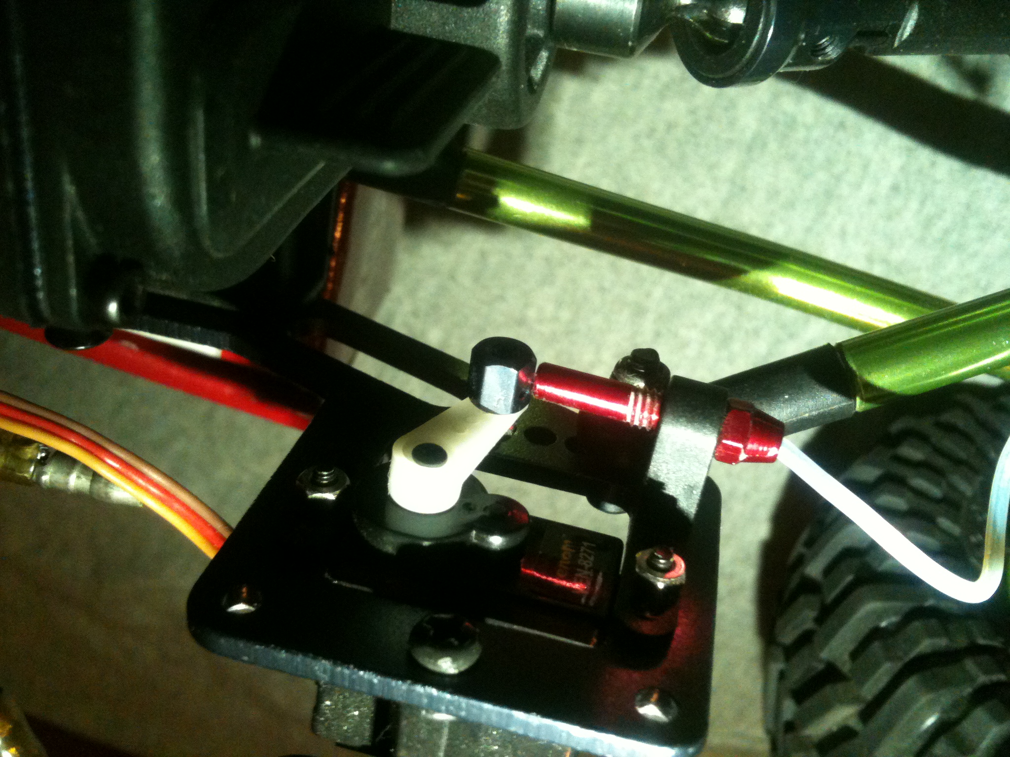

The rear lock outs are shimmed and new bearings are in. nice to get it running again.
go the DIG working some today too. still need to mess with the settings a little more. i can get all 4 wheels to move and just the rear to lock up but can't get the rear to free spin.
now that the dig is working i might put the diff lock kit away for a different time.
now i need to find some lockers for the axles. i tried to contact a company called FLM but got no response yet. i just don't want to use the jb weld method but might go with the washer mod th keep the axle locked if i can't find a true lock set up for these axles.

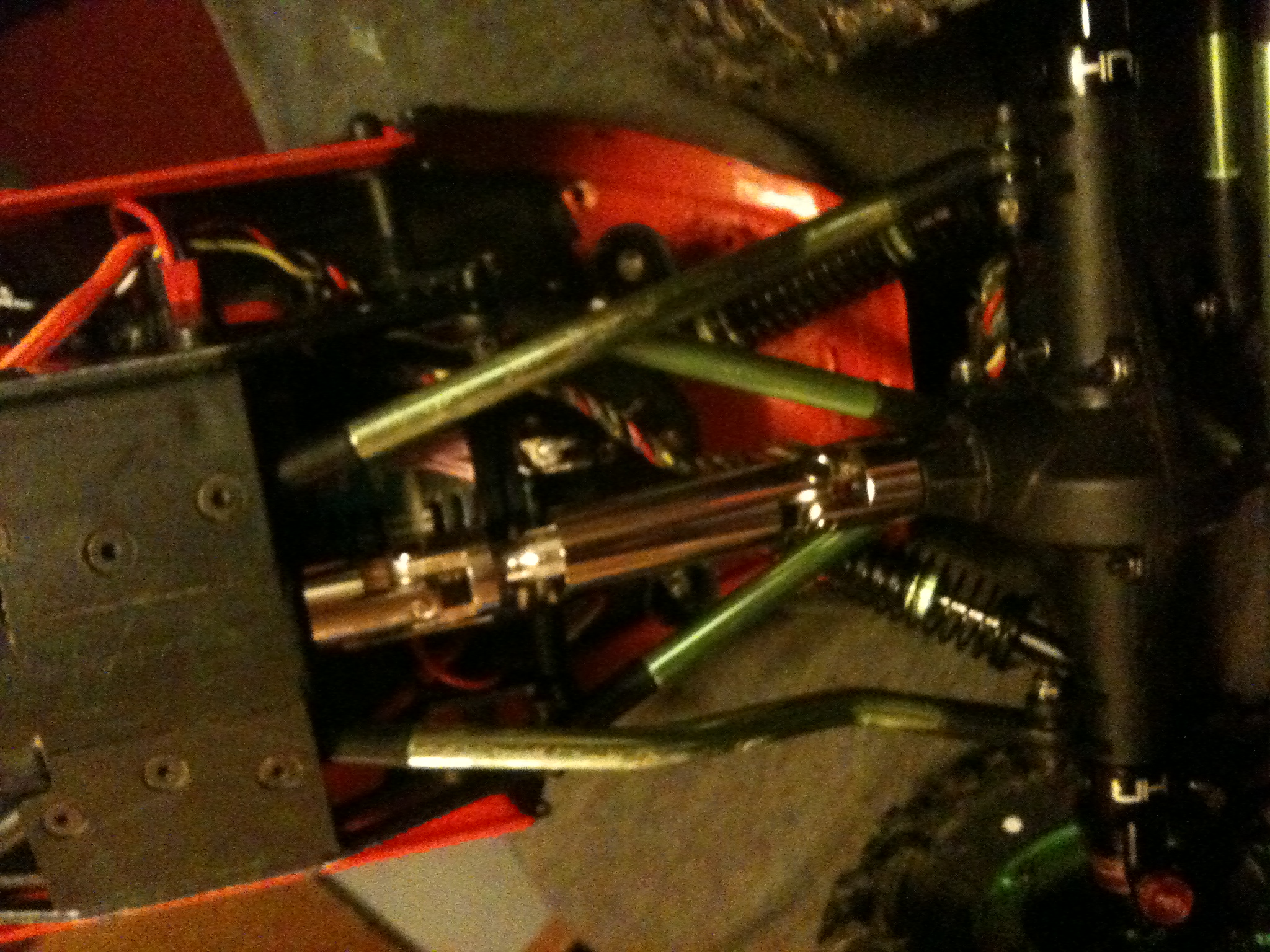

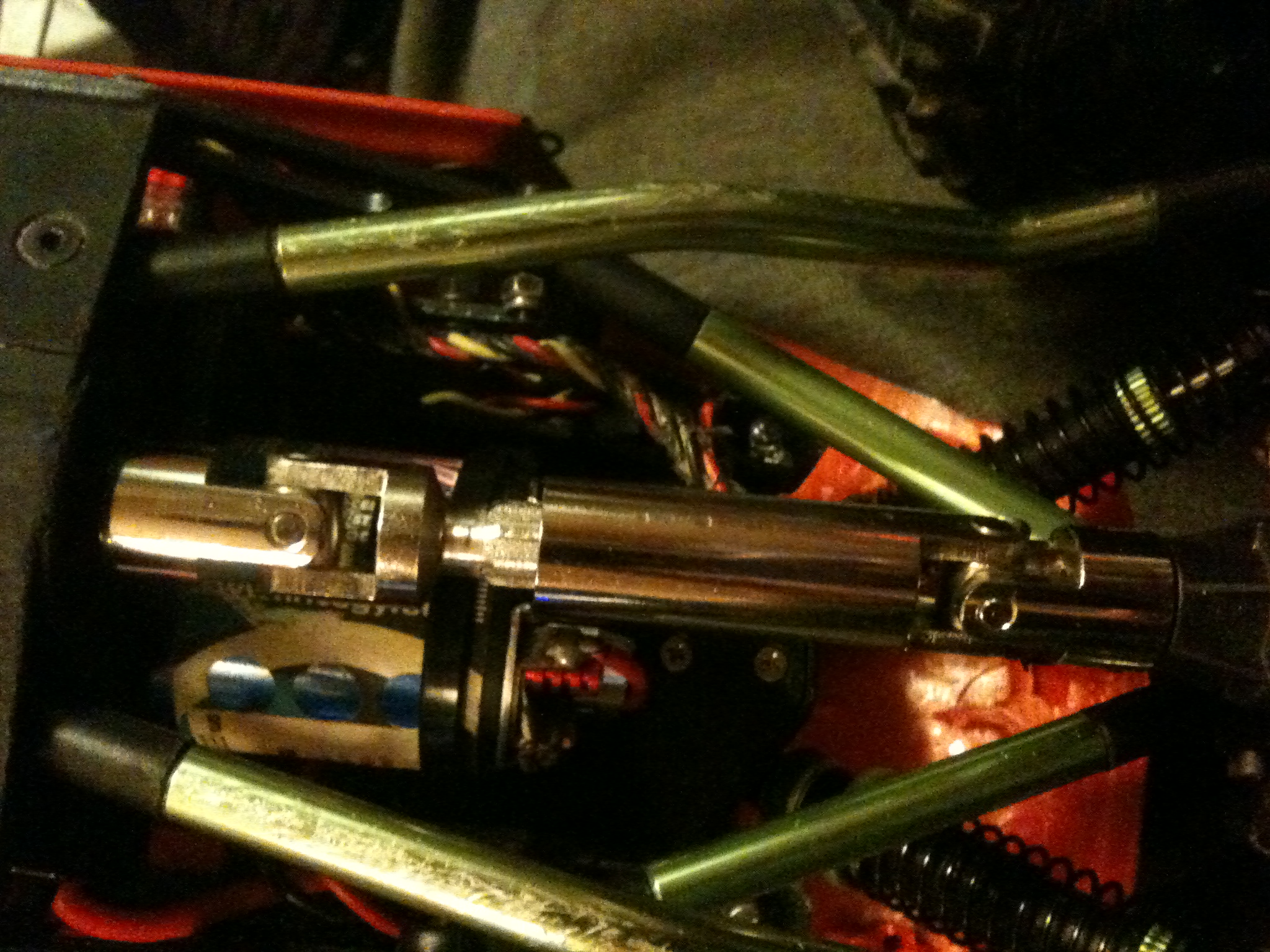

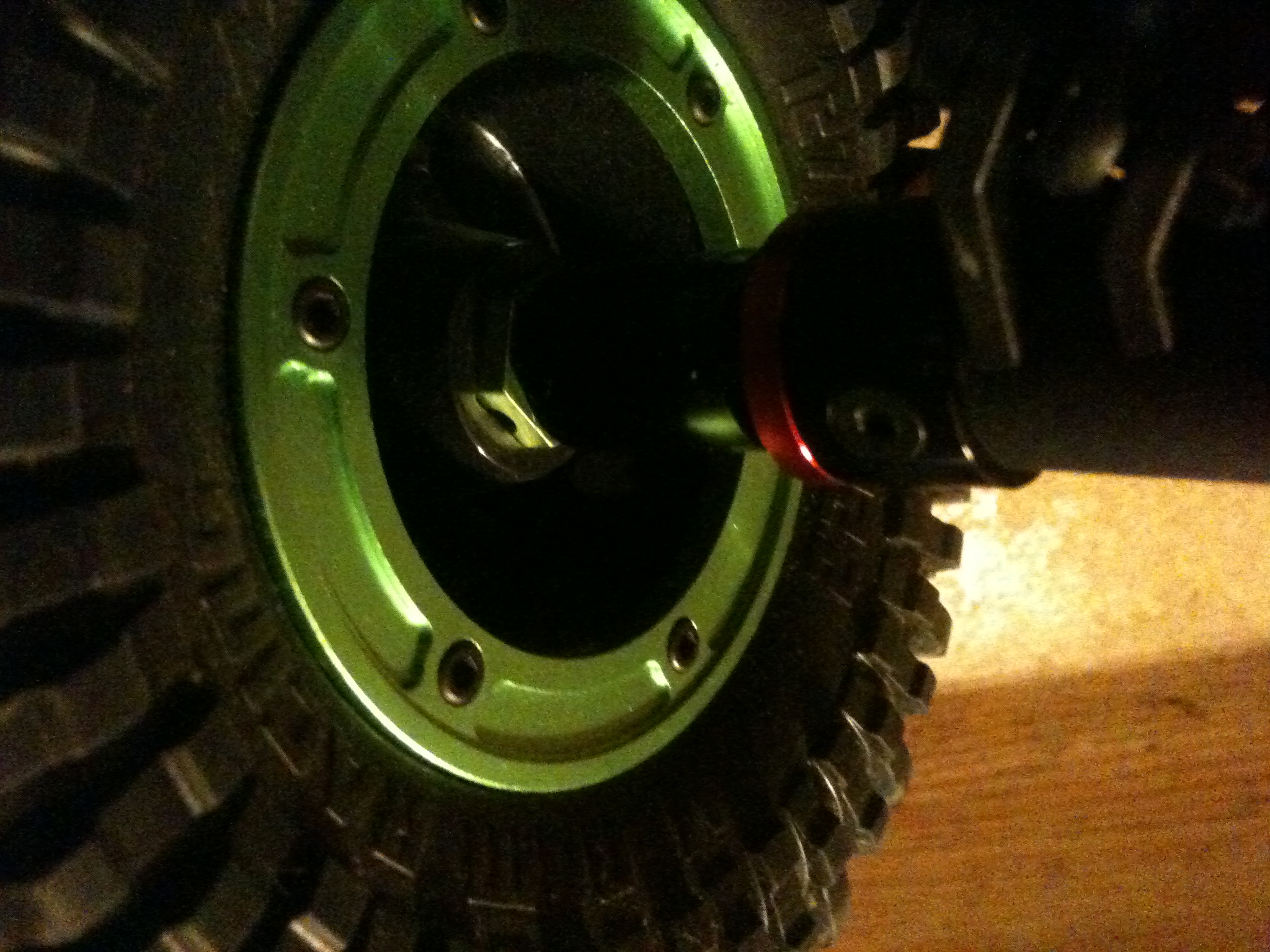

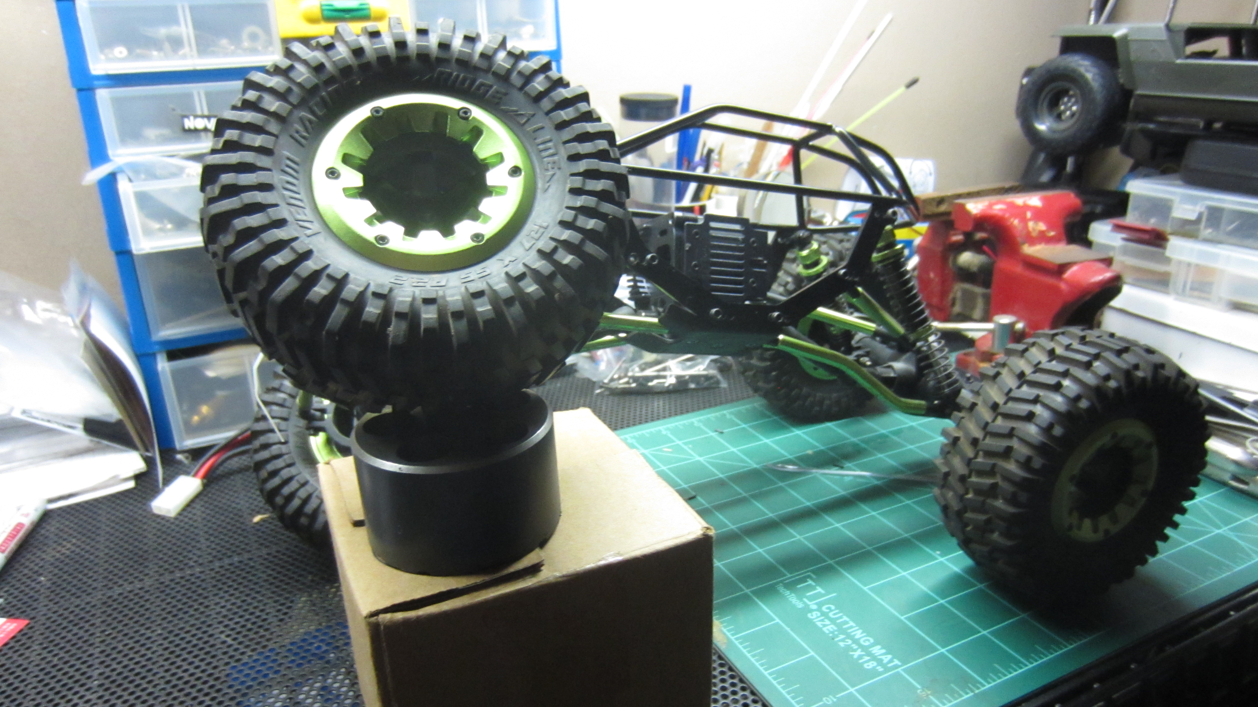

While i wait for the major parts. i went and got some punisher shafts. first one came today and in 2 mins i had this.
the rear should be here soon.
im also doing some rock lights. i need to finish the back ones but it's coming along.
still going to get a few more parts. getting close to completion.

Old 07-16-2015 | 04:14 PM
Mike Flea's Avatar
Joined: Mar 2013
Posts: 370
From: Streamwood, IL
Those Punisher shafts are nice. The rear axle on the Jeep uses one, much longer than yours, but it takes abuse, and keeps running. I've heard some guys complain that the pins fall out, but, knock on wood, I haven't had any problems. It's big and beefy, and all scratched to hell, it must be 3/8 diameter, and gets hung up on the rocks, but no damage other than a few scratches.

They are nice looking shafts.i hope the pins don't give any problems. a lot better then the plastic ones. the second shaft came in today so i go it connected to the tranny only. i have to wait to get the rear axle back before i can test them out but i think they should work out good.

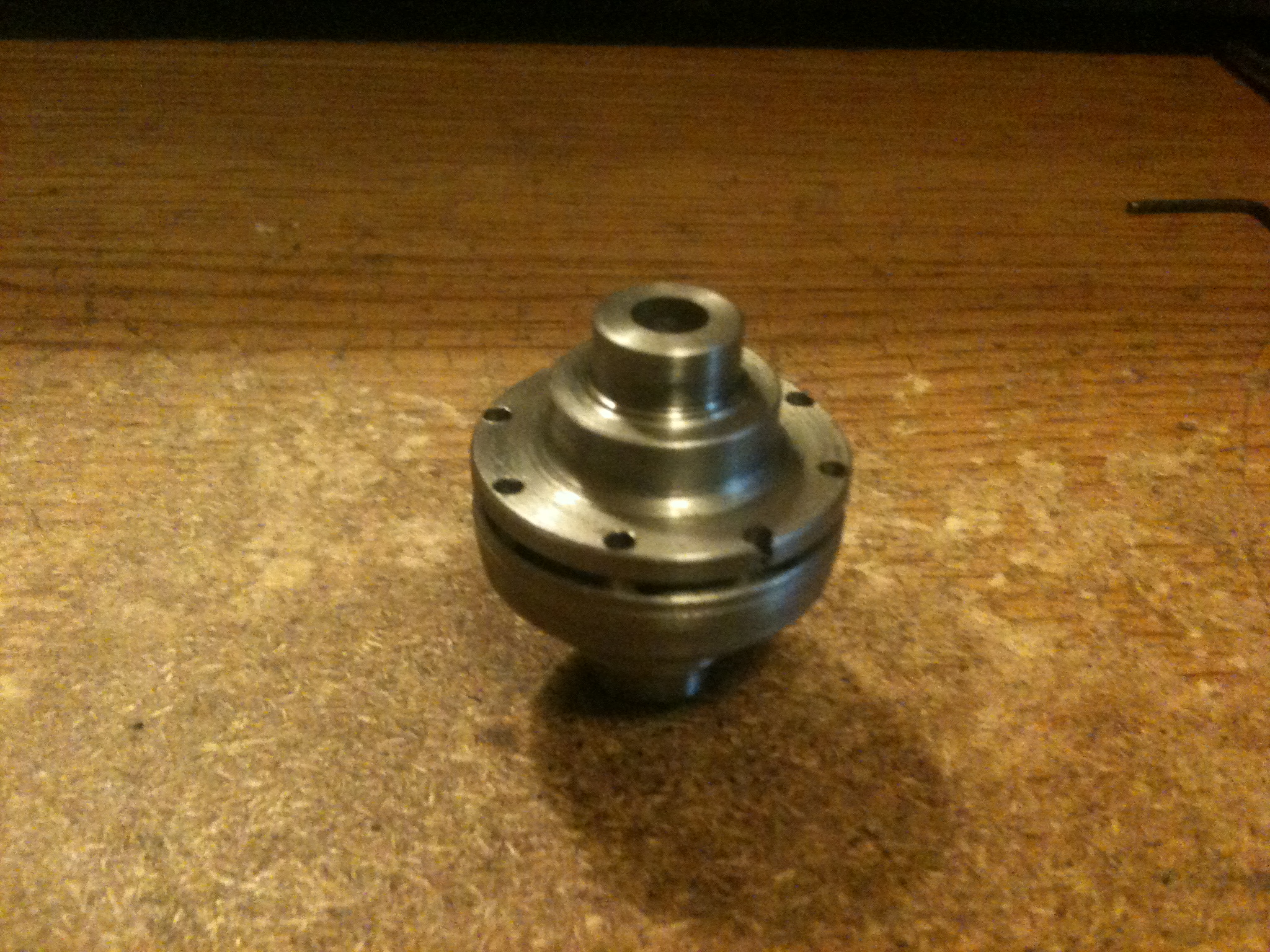

UPDATE for the creeper.
after a bit of a wait. i got to run the creeper again. for the past week i have been testing a locker that is custom made for the creeper axles. all is going good and the part seems strong enough for the beating i have been and will be putting it through.
here's a peek of the prototype.
the final parts may look slightly different but will be just what i needed to bullet proof the creeper axles.

Old 10-25-2015 | 04:33 PM

Old 10-25-2015 | 09:50 PM
RustedRC's Avatar
Joined: Aug 2014
Posts: 712
From: Johnstown, pa
Soon as the parts get here i'll let you know.

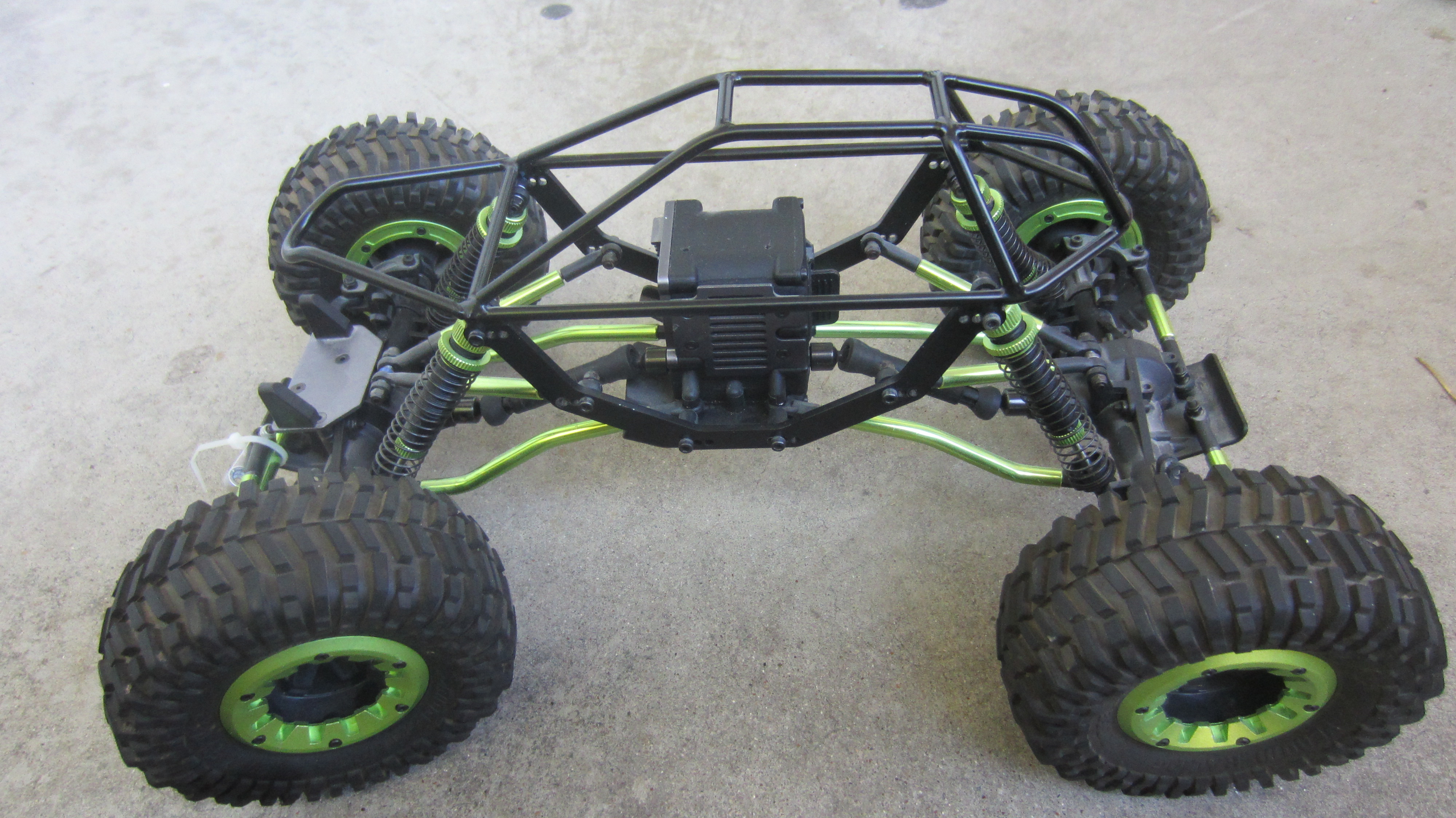

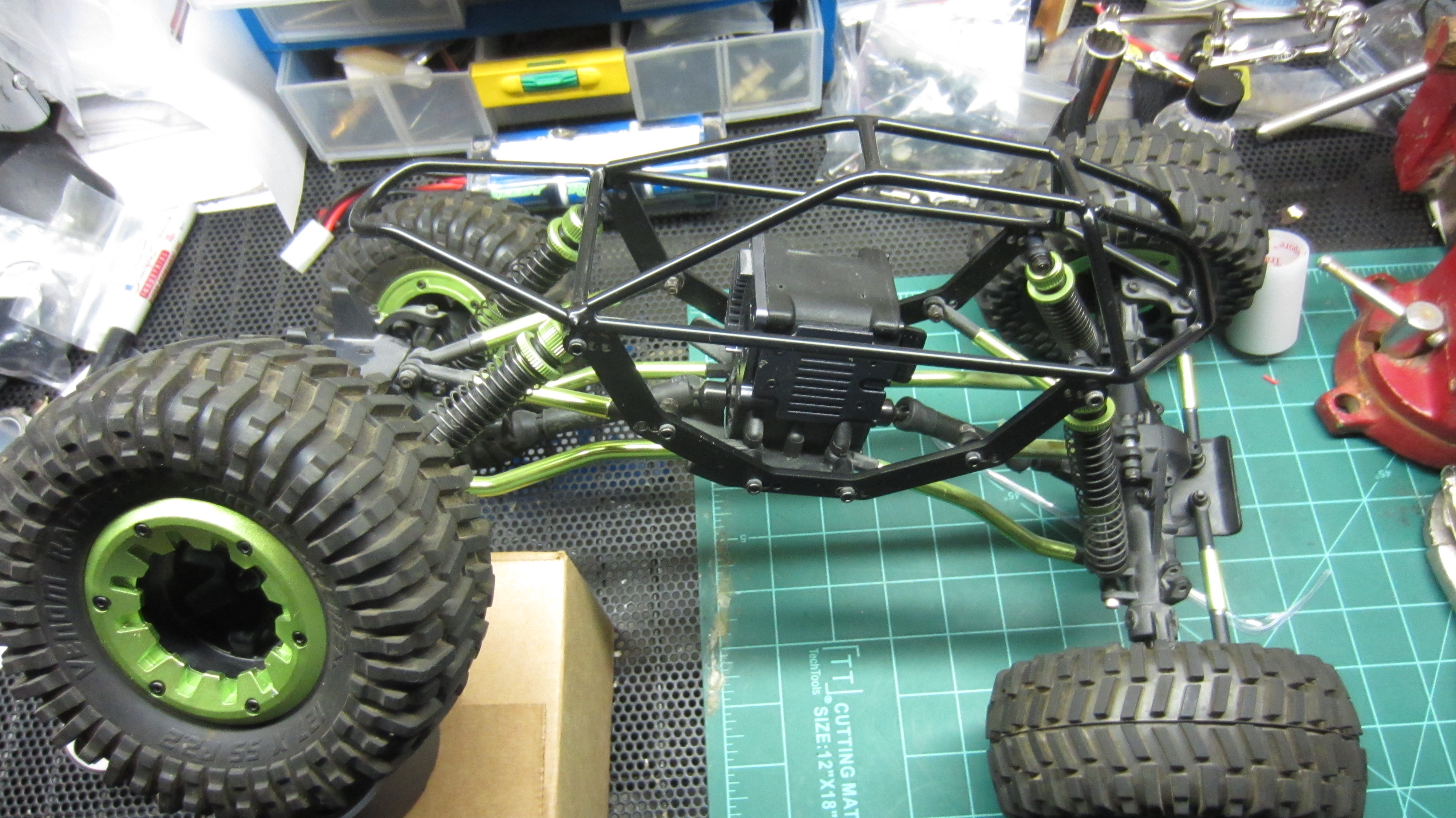

Here ya go, pretty much stock except the FLM solid spool lockers and TCS tuber frame. I had to cut down the stock drive shafts to work with the frame, plan on upgrading later, it's been kind'a packed away for awhile.

Old 11-01-2015 | 12:45 PM
RustedRC's Avatar
Joined: Aug 2014
Posts: 712
From: Johnstown, pa
That frame looks cool. i see there is a bit more flex than my stock frame from the top shock mount position. i wonder if there is enuff room under there for the dig unit.
