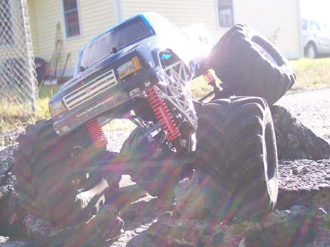

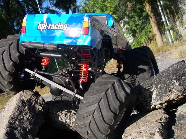

well we went climbing last sunday truck really took a beating but the wk and the new set of wheels that dogman said to use really work out great thanks dogman ,they climb good on rock and hard drit with small rocks ,i would like to get a better set of shocks i blew one on some bad falls and the rods kept pulling out of the plactic rods that goes from the frame to the axles i aslo would like to move the battery to the front how can i do this,plactic ties to the rods in front? anyways i fogot the camara so no picture until next week thanks rye

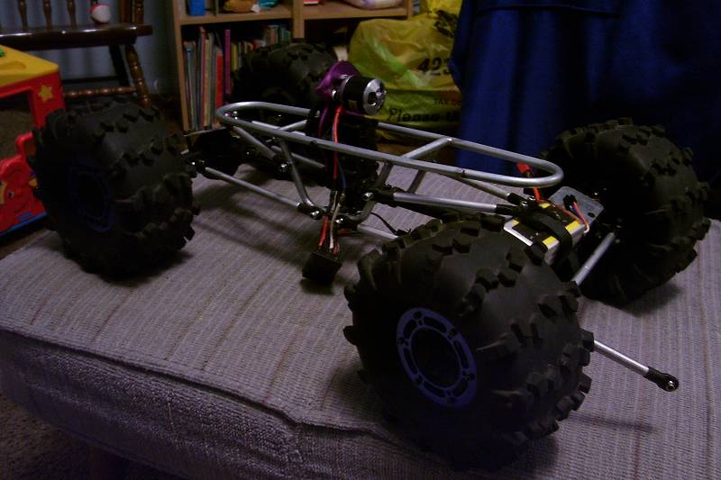

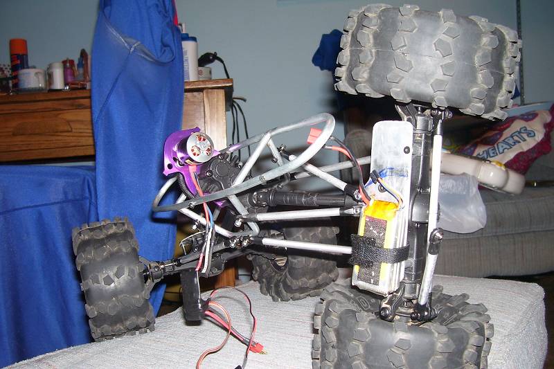

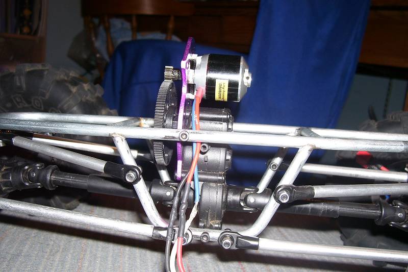

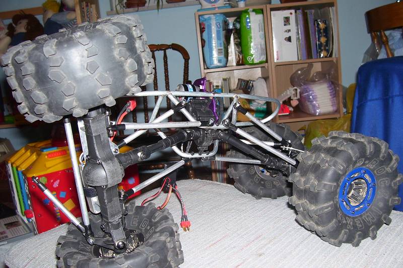

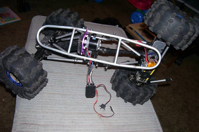

Back to my project status I finally got around to finishing the links and axle plates tonight and got in all mounted up. I also got the brushless motor I mentioned mounted and wired. Unfortunately I miss-calculated and now have a 13 inch wheel base[sm=omg_smile.gif],oops. also I lost one of my stub axles[:@], the damndest thing is I just saw it like 2 hours ago. Maybe I will find it tommorow when I shorten those links. Well one step closer I guess.
To Do:
Mount shocks
Complete tube chassis(cab)
Setup steering servo mount and linkage
Lock rear steer
Mount up electronics
Make body panels
Most of the had stuff is out of the way, here are some new pics.

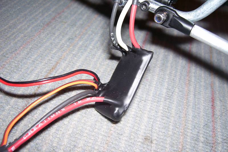

Whoa Whoa Whoa! Since when is it water proof. I would think that that would be advertised or stated somewhere I just checked Castles web site Horizon and Tower, none make any mention of it being waterproof. Further more I was recently running one of my boats and flipped it, the boat filled with water and when it returned to shore the esc was no longer working. [sm=confused.gif]
#160
Joined: Sep 2007
Posts: 39
From: St. louis,
MO
Well I just saw the video with the mamba underwater. However I assure you that that one of mine was fried by water when in use in my boat. There was no other reason for it to fry I did not over-amp it or anything and it was not the motor or RX. I replaced only the ESC and every thing works again. I agree that there is a positive case out there for it being waterproof. But I assure you all I fried mine in this manner.
Whatever I still feel more comfortable with a extra layer of protection.

That's the only thing that matters!! I am curious to see how the plastic-dip holds up, I would think a liquid silicone would be more suitable(Flexable, Heat restistant ect..)

Yeah well I am not really impressed with it so far it has kind of peeled back from the silicone wires[&o]. But it seems to be tough. The other problem is heat. I have always had problems with these overheating on me when I use large servos. I had this in a micro rs4 prior. I powered it up once so far and it got really hot really fast. I guess with the coating it keeps out all the air and therfore all the cooling. As far as the dip goes I saw another guy use it on a forum and he said it worked well so iIdecided to give it a shot. I will keep you posted. I also was not aware that a liquid silicone exsited that would be apropriate, I only can think of silicone caulk which is way to thick to be workable unless you could thin it, but with what? What kind of silicone are you talking about and where can I get some? I am willing to try anything and I have many more aplications, plus like I said I am not to thrilled with the dip's performance so far.

Dont use "normal" silicon sealant. That vinegar smell you smell when you apply silicon sealant? That's acetic acid, its corrosive, bad for electronics... If you can find an electronics grade silicon sealant (neutral cure) thas OK (it wont have the vinegar smell). But honestly, I cant see any kind of liquid rubber working out well for an ESC since the rubber will hold in heat and thats bad for ESC's...
many people have had good luck with a product called Corrosion-X... its a spray thats made to stop corrosion... but works great to waterproof electronics without a thick coating and the associated heat buildup...
Here is a silicon sealant made for electronics http://www.mgchemicals.com/products/422a.html (click on "where to buy" at the top if you want to buy some...
