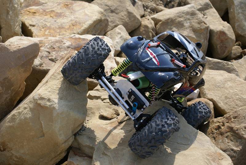

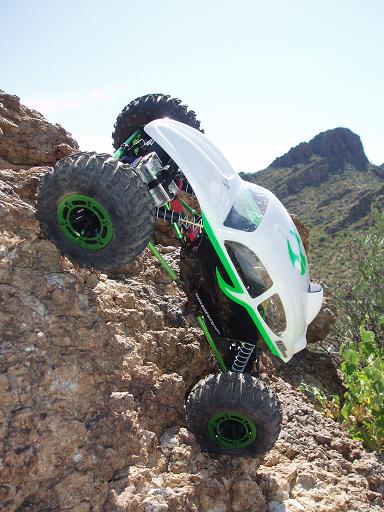

Here are some pic's from Today. Had a blast

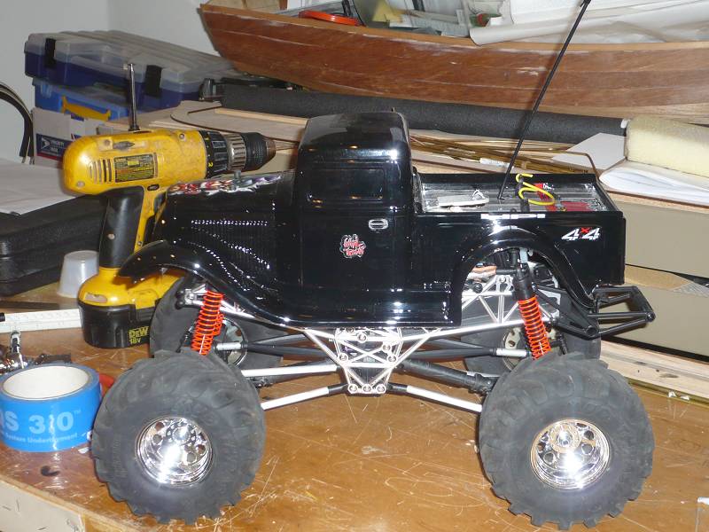

hi guys
just got done with the wheely king converen it climbs better then when it was stock but!, here what i dont like, streeing is not very wide, motor is to fast for this speed controller get to hot and tries are not any good for climbing any one have any ideas on these trouble parts ,i really dont like the radio with the neutral trigger ,i found these tries will they be good for climbing and will they fit thanks rye

here the truck ,i forgot to load it rye

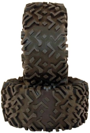

yeah those will work but these are way better!!!!
[link=http://www.killerhobbies.com/items/wheels~tires/tires/team-losi-rock-claws-2-2-tires-w-foam-2-losa7682b-detail.htm]Losi Rock Claws[/link]

so, the losi tires will fit directly onto stock rims? maybe i should buy narrower rims... not sure. I'm gettin mine tomorrow and am instantly gonna upgrade!!

Get either the losi claws or the trusty ol masher 2ks. The mashers took 1st in the last comp I was in and the losi tires took 2nd. The losi claws did have better traction on slopes but I feel the mashers still have a better tread design for uneven/jagged stuff.

Those are some cool pictures. Is that a Suburban body in the top pic? From the looks of it, I'd say it was having fun [8D]

yup that was the burban body! and yes it was having some fun

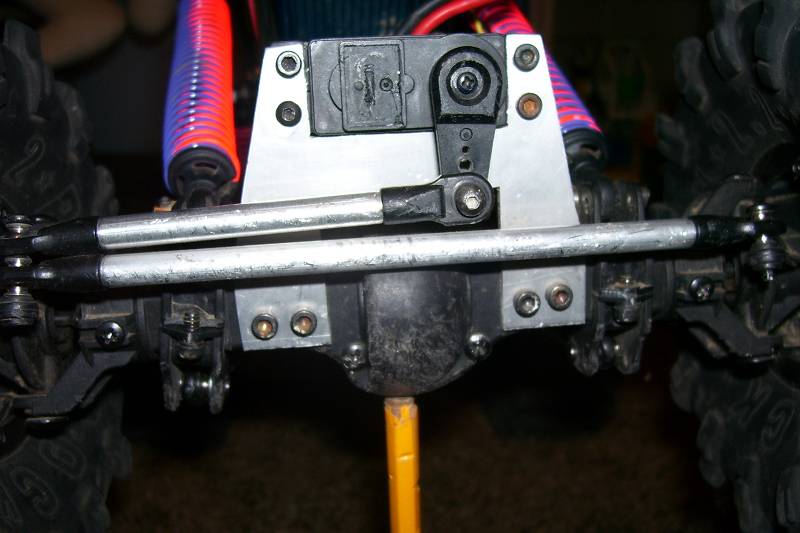

I found the red rocks make up for their less grippy compound with flexibility and rugged knobs.
Also check out these other pics. I have had the truck since it first came out. I have been addicted ever since.
I originally picked my WK up for a change of pace. I bought a second days later to upgrade to 4wd 4ws.
Now upgrades include:
custom lower links
custom steering rods
custom servo bracket
65t integy lathe motor
Pro-boat waterproof speed control
JR rs310 syn rx
Hitec 645 mg for steering and second for winch
Traxxas T-maxx Lower control arms for the upper links
T-maxx driveshafts
locked Diffs
Hardened steel final drives
savage shocks
custom adjustable shock mounts
Axial bead locks W/rock rings
Imex Red rock tires
I still have a little ways to go though before i am satisfied.
