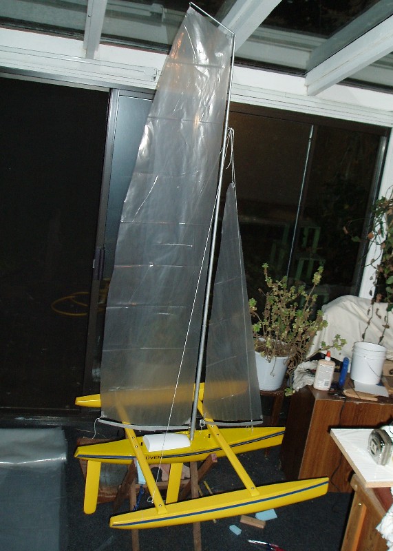

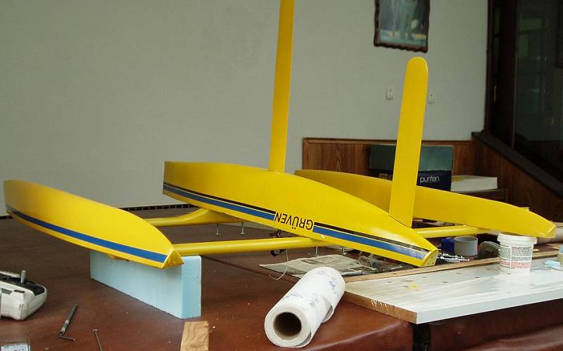

Hello all!
I found this site while searching for what little there appears to be about RC Multihulls.
I'm in Oregon USA.
I've been building and racing OneMeters for 15 years, and recently (on a lark) decided to try a tri. I used one of my old OneMeters, it's very narrow for a mono but a bit fat for a tri, and added to it. The main hull is glass over balsa strip, the float hulls are glass over foam. I made no real attempt at extreme light weight, the idea was simply quick build and go try it out. One meter long and one meter wide.
The trial rig has 1000 sq inches of sail. These ugly things are only temporary sails as I sort out the rig.
I also have a wingsail I built for a landsailer that I intend to try.
Here's pics (if I can get them to post.)
I'm in Oregon USA.

I finally took the RC trimaran out for its maiden voyage.
All in all I am very happy. New boat usually takes a while to sort out the rig and stuff.
The tri sailed beautifully, it's well balanced and tracks straight, no noticeable weather helm or lee helm either for that matter. Steering is very responsive but not so sensitive it's quirky, the keel and rudder seem about right. The rig is fairly well balanced, but the boat is so light it stops head-to-wind on most every tack. I need to rake the mast aft a bit more, but the sailplan seemed to balance pretty well, but the temporary sails started stretching and blowing out quickly - it was just too windy. Big gusts, was blowing 15 with gusts above 20 out on the lake.
It accellerates like crazy! From a standing start - in 5 feet it's going faster than my US One Meters ever went!
So I believe the sailplan is viable, and will build better sails and it should be good to go.
All in all, a great proof-of-concept. For a one-off "that-looks-about-right" design, it was very good first time out.
Capsized a bunch of times, but as luck would have it we didn't get any capsize on film nor any of the best high speed runs.
Between gusts the wind typically died to nothing, so it was either hove-to during a gust, or not moving for most of the vid shots. Murphy's law of photography, the best stuff happens when the camera is off....
(experimented with posting - can't post a vid and no way to host one...)

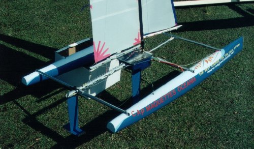

#239

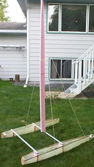

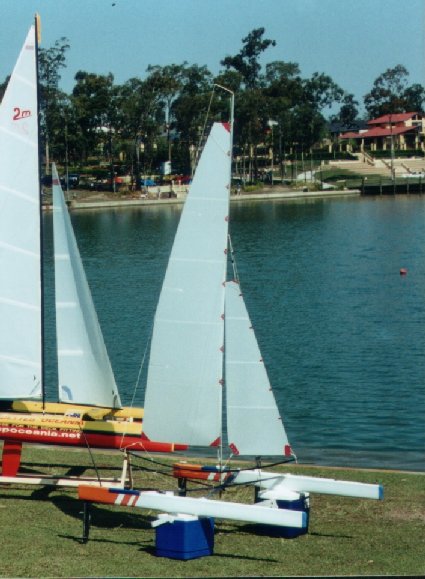

Dream -
you will probably have to come up with your own lines, since most r/c boats are of the trimaran configuration. Even at 1.2 meters (48 inches) you may find the hulls too narrow to house a winch. It might require a central "pod" and for that reason, many don't build cause they don't like the looks. A builder from the UK had one (and the only one) that I've seen photos of that actually was a nice looking boat.
Just like big cats, the little ones suffer from pitch-pole and over-canvassing. Since you aren't aboard, you can't feel weather hull go light until it's out of the water and too late. Movable ballast is possible, but again, it will be reactive - not proactive. Ad in the inability to back wind the jib easily (you can with a second winch/radio channel) and it probably explains lack of interest or numbers of a cat configuration. I started on a 1/2 meter of my own cat, but got disillusioned with trying to make it "look nice".
These two from Australia.
And two from US - mine has the pink wing-mast.

there are three international size classes of multihulls most commonly built ...
1. a 1.2 meter MINI40/F-48 size,
2. a 2 Meter size and the
3. 1 Meter size ........... is quickly catching on.
Staying within one of these will result in a boat that can be raced, and will probably be sellable.
All are development class boats, and the F-48 has the least restrictive rules of the bunch. Speaking of this size, the class allows 1.2 meter (48 inches) length maximum, 1.2 meter width (48 inches) maximum, 2 or more hulls, and .93 sq. meters (1400 sq. inches) of sail area maximum. Working within the very unrestriced size rules, you are free to build what you think is fast. The MINI40 Class has a few contradictory rules, and the 1 Meter is similar to the F-48, except for size.
The 2 Meter class is obviously a bigger boat and the main difference in rules (and size) is the the 2 Meter class has a maximum mast height, and sail area is unlimited - just opposite of the MINI40/F-48 mast/sail concept.
I originally started with a NACRA 18 Square (see photo) as my base boat - 5.5 meters (18 feet) long, 3.35 meters (11 feet) wide and 18 sq. meters (194 sq. feet) of sail area - main only - no jib. This "real" boat gave me suggested scale sizes for my first r/c model. The hulls are approximately 0.076 meters wide hulls x 1.2 meters in length. (3 inches x 48 inches) You can start there, and most drum winches will fit inside the hulls. Arm winches won't.
