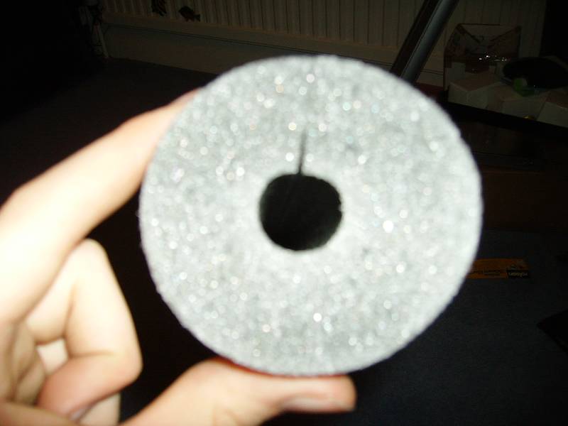

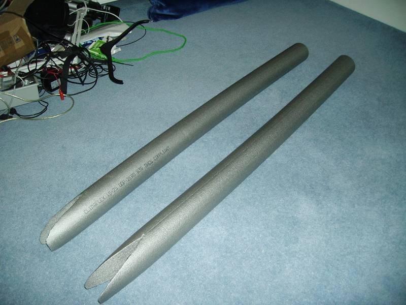

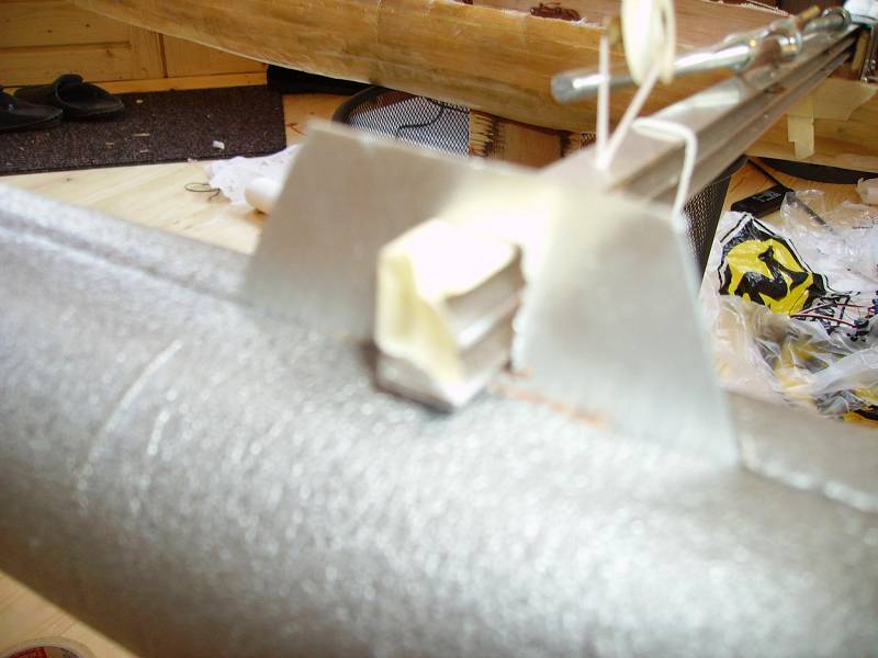

Right!

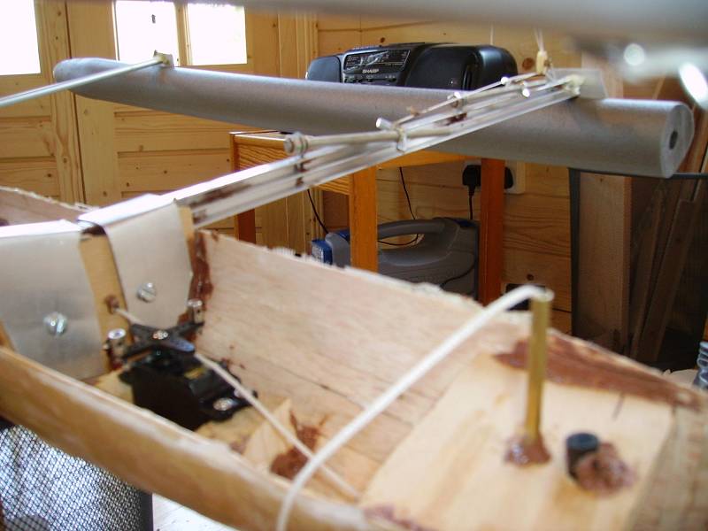

I have just returned from B&Q, with a 2 meter bit of insulation.
It is 63mm wide (diameter), and the hole is 16mm. I now need to mke it into sponsons. One question I havefr trict, is on your pictures, on diagram 'fittings 2', on the cross section sideview, what is:
The rectangle with the solid black outline,
The shaded item that is inside the rectangle
and also, what is the plastic tubeyou mentioned? Is this the black rectangle? Also, can the yellow thing be made out of 1mm aluminium?
Many thanks,
Andrew

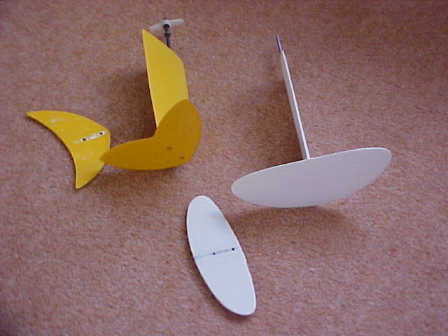

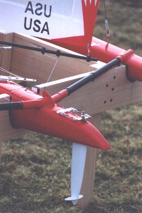

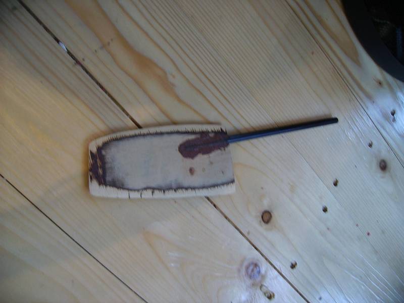

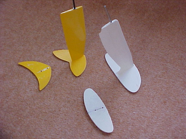

Any ideas on the rudder foil?
The bottom of the rudder is angled backwards slightly (so if a plate was put on the back it would pull the back down).
Should I just glue a bit of plywood to the bottom so t looks like the attached image of the black boat? (obviously on my rudder sketch, the angle has been emphisised.
Does the foil have to be an areofoil? If so, can someone draw me a crosssection?

Yes, it would be a problem to transport - but my goodness, set up with minitaure Harken winches, travellers and blocks, along with static (non-working) bits and pieces you must admit it would be a wonderful sight.
Here is a photo of a rudder foil on a scaled down 1 Meter US boat (State of Washington) built from the Mini40/F-48 plans obtained from Mike Friend (a fellow UK multihull enthusiast) It is "PULSE" and I believe it was UK Championship in late 1990's as I recall. You can see that there isn't a need for huge foils, just enough to start downward pressure as water flow moves over the foil. At slow speeds, (light wind) you don't need the foil, so very little negative angle is required. As wind picks up, boat speeds up and more water/pressure takes place to begin to try to force the stern down and keep bows up.
In my old 1 Meter, I had a small foil that had only 1 degree negative angle. Some will use up to -3 degrees. Hope this helps.
I thought you would like the size. ! Yes, it would be a problem to transport - but my goodness, set up with minitaure Harken winches, travellers and blocks, along with static (non-working) bits and pieces you must admit it would be a wonderful sight.

Thanks Dick!
So it is just a piece of flat material.
Tricat - I have bought the pipe insulation, designed the bows (as you showed with your picture), and expoyed in the things to connect to the crossbeams.
Thanks for all your help!

Hi Cowana,The cross section shows where a slit for the triangular fitting will fit and be locked in by as mentioned,by taping up the the thin saw cut made to let the triangular fitting be slotted into place.The shaded area is where I just tape up the cut end so secure the fitting in place.The tape will not come off as it will be trapped inside the foam tube,with the fitting in place.The tubing mentioned is ordinary plastic pipe used in plumming of 1/2"[12.7mm]dia.should be a close fit to the hole in the foam.The triangular fitting must have a minimum width of 5mm otherwise it has too much freedom
for the cross beam to slop around resulting in the float doing the same,although once under pressure
it is held steady by the side pressure.Well done Cowana I see you are pressing ahead ok,hope the info is ok for you.Just noticed notes on the foil.The angle refers to the water surface as Dick says it only needs a small angle of negative angle otherwise you get something like a submarine[Yes OK I've done it and found out the hard way!!!!!????]In those days I had no contacts to put me right
Regards Scotty

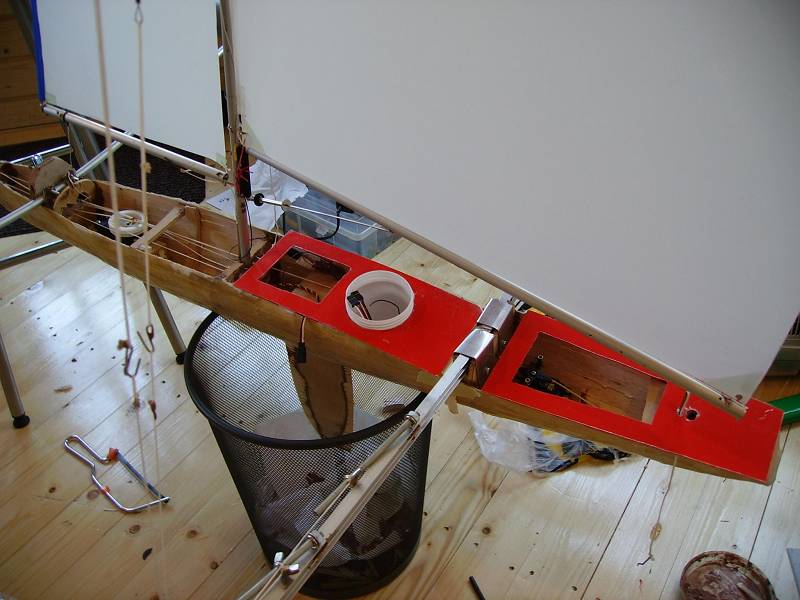

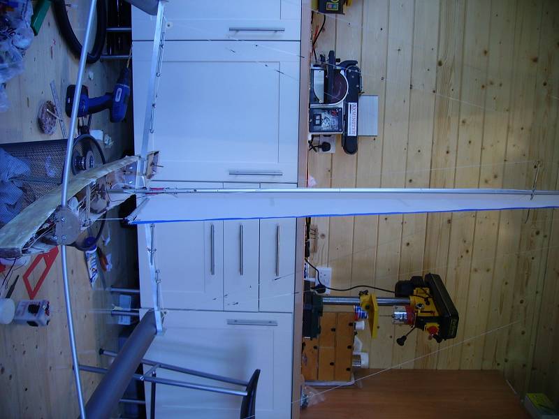

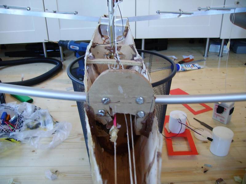

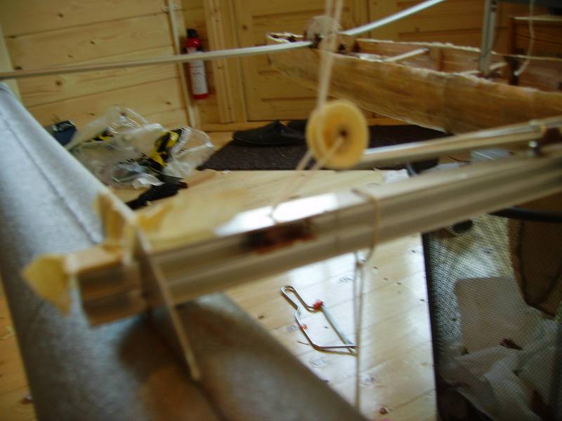

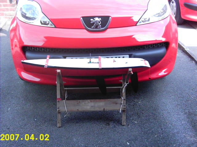

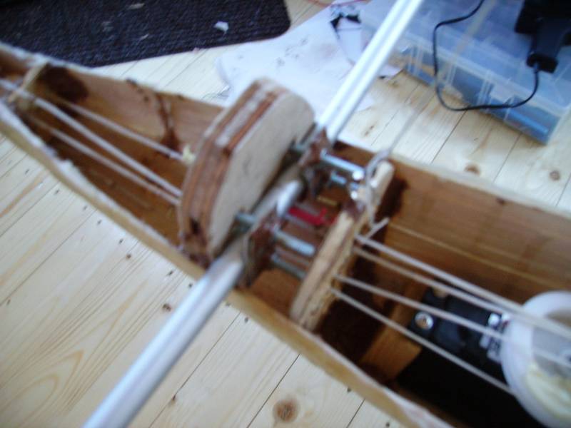

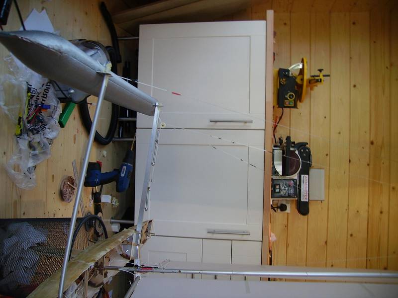

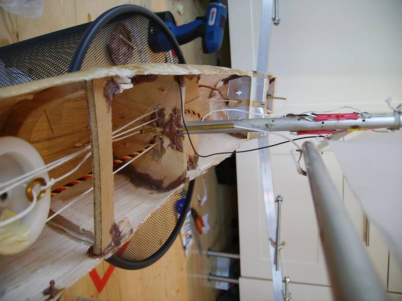

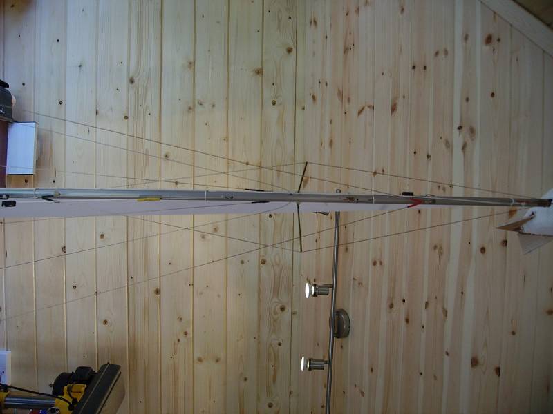

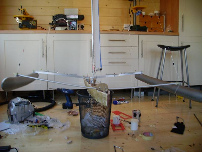

Here are some pictures of my trimaran so far, with Tricat's floats.
I know it isn't the best boat ever, and it would be no good racing, but... you try building a trimaran for less than about £20!
Should be fun to sail! The lines going from the top of the mast to the front of the sponsons are because when I tilted it on its side, the front dropped because the boat twisted. These lines are tight enogh to stop the twisting, but loose enough to not bend the mast any more. They are not nearly as tight as the shrouds, and do not support the mast at all.
