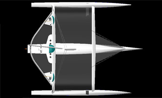

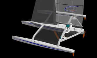

Anyone interested in the new MOD 70 Class - Multihull One Design?
I thought about a 1/10 scale model,
which would be 2.12 m length overall and 1.68 cm width then.
Should look quite impressive on the water.
Here is the official homepage:
http://www.multionedesign.com/en/
Including lots of construction pics - hot!

Important update on the new MOD 60 Trimarans!!!
Through some secret channels from my old times as a shipwright
I just received precise plans which are NOT available via the Internet!
These plans are so precise,
they can be redrawn now to build a true 1:10 scale model,
or for the Mini40 class, as well as for the 2M class.
But this time they will not be for free.
Please tell me if/how much of you are interested!
[email protected]
General dimensions of the real ones:
Length overall 21,2 m
Beam overall 16,8 m
Hull draft 4,50 m
Mast rake 4°
Air draft 29 m
Light deplacement 6,3 T
Up-wind sail area 310 m2
Down wind sail area 409 m2
