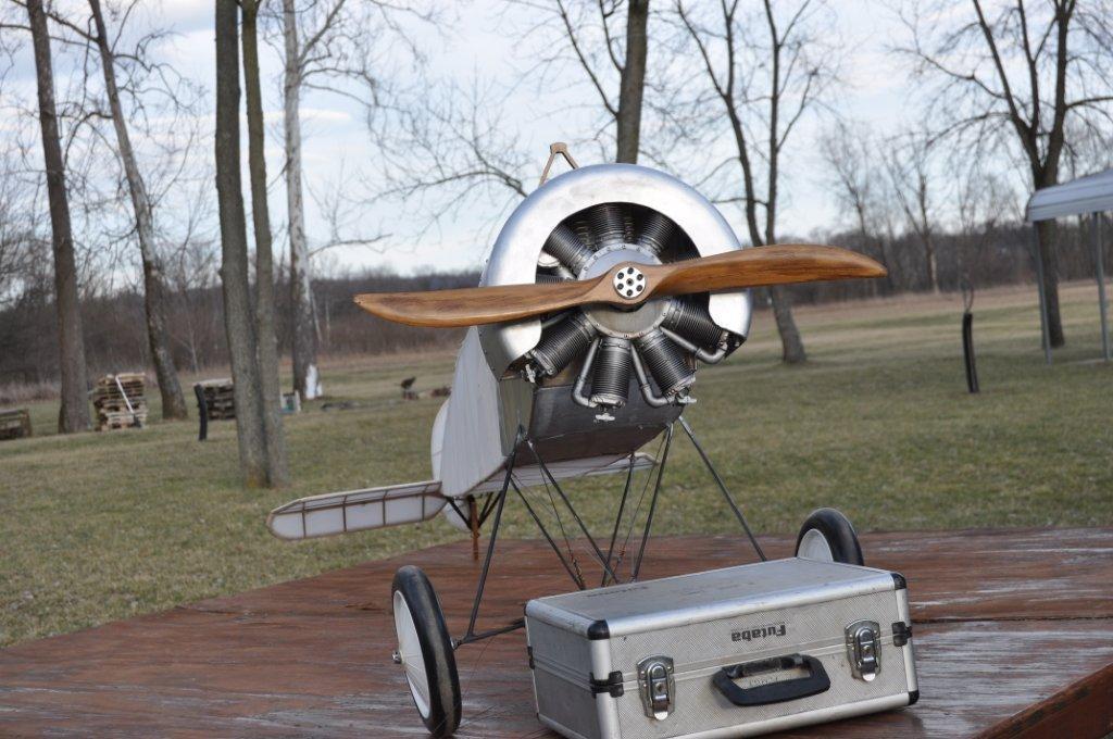

I enjoyed the visit to your shop and especially all the kibitzing
that I got in while you were getting your Eindecker ready for it's maiden flight.
Rhonda snapped a few pictures of the trip out to the field, the set up and some flight shots........heck, there's even some video.(can't get the video uploaded)
I realize that our presence (Larry and me) probably sped up your time table considerably and I also know the weather wasn't ideal. But (there's that dredded but again) but the show did indeed go on!
The temps were in the 50s, but with the wind in the teens and gusting well into the 25 mph range and overcast (no solar warmth) it felt much cooler. We were all bundled up except for Paul - his anticipation level was high and with his adrenalin flowing he didn't need "no stinkin' coat!"
Here are some pictures........
that I got in while you were getting your Eindecker ready for it's maiden flight.Rhonda snapped a few pictures of the trip out to the field, the set up and some flight shots........heck, there's even some video.(can't get the video uploaded)

This is the original prototype that I was framing up that Paul bought instead of a cut kit.
The wing is plenty strong but there is not much resistance to twisting due to it's size so flying wires will be required.[
The wing span is 135" with a 23 1/2" wing cord.
I believe he covered it with Coverall.
It was windy with some strong gusts.
I am coming up with a system for the flying wires so they are easy to connect and disconnect. Plus it's not an Eindecker without flying wires.
Larry
]The wing span is 135" with a 23 1/2" wing cord.
Larry

I keep waiting for the pilot or the designer to chime in here.........but in their absence I will expand on the flight just a little bit.
First of all, we learned a great deal about the airplane and the design. At 3172 suare inches of wing area and 39.4 pounds ready to fly less fuel, it was very light on its wing.........so weight isn't a problem.
Secondly we learned (as previously stated by Larry) flying wires are going to be required for normal flying. I am a little dissappointed about this because I wanted a very quick to get ready for flight "plug & fly" type of model. But since everyone else was planning to add the flying wires, no one else was bummed out about that......soooooo, I will fit functional flying wires to my model. It won't add too much tothe assembly time and will add immensely to the appearance of the model! Wires are a very prominent feature of the Fokker Eindecker series.
And lastly, we discovered that the stab was

As Art was about to discuss the stab.
I designed the stab with 3/8" material for the spars with no sheeting top or bottom. Under flight loads the elevator was not very responsive and in checking it out on the ground with full up elevator
the stab was twisting which seemed to be negating the elevator response. The stab has a 39" span and there are no brace wires.
Remember the full scale had a flying tail so it would not be subject to this twisting effect.
On my new build I have sheeted the top and bottom of the stab and elevators and the stab is now rock solid. I have added 1/8"x1/4" cap strips where the ribs are to maintain
the scale look of the stab and elevators.
The rudder was very effective and will not need any changes.
On another note I fly my 1/3 scale Super Cub, which has the same airfoil, with differential on the ailerons. Lots of up aileron and very little down aileron.
The rudder is also mixed with the ailerons at 20% which helps the tail to track through turns much better.
With these adjustments and some further flight testing, on calmer days, it can be trimmed out to be a gentle flyer but also a responsive flyer that will be fun to fly.
Larry

Sorry about the delay, but I got a call I had to take.......
And we discovered that the stab was strong enough but not stiff enough.......as the elevator was pulled to the up position I gently pushed it back toward the neutral popsition and noticed that the front of the stab was twisting up.......we also discovered (the call was from Paul) that the stab incidence was at a positive 3 degrees. What we deduced was happening was this condition was causing a lot of drag and turbulance but not imparting much of a pitching action to the airframe - thus it was slow to gain altitude. Also Paul checked balance again back at the shop after the flight and the result was that it was tending toward a tail heavy condition.
The fix here is relocate the stab to a zero incidence reading and brace the stab to prohibit twisting.
The next test flight will indicate if these fixes were correct.
