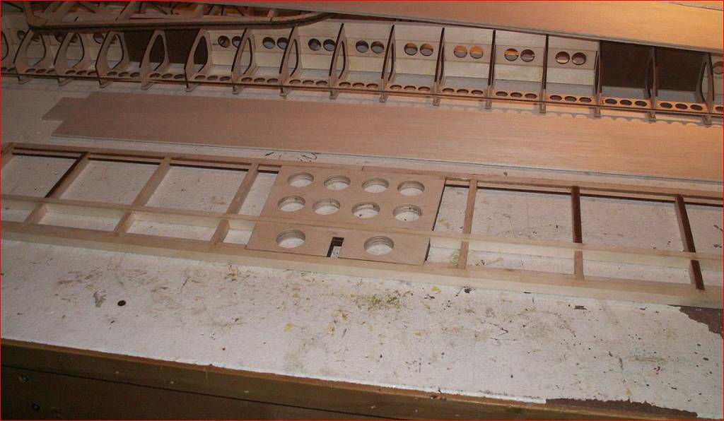

Stab Update
Finished sheeting the stab that I already had framed up.
Put lightning holes in center section and sheeted with 3/32" balsa.
Hinged with large Robart point hinges.
This is much stiffer and resists twisting.
Now back to finishing hinging the ailerons and finishing up with the wings.

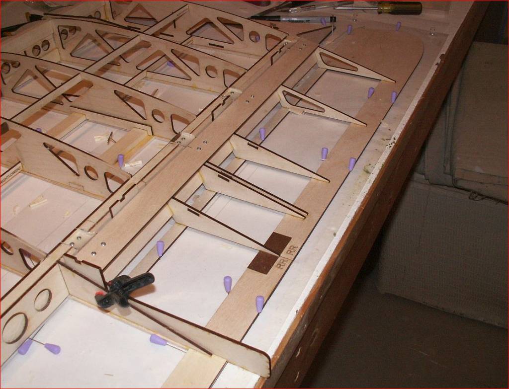

I am looking forward to getting mine airborn!
OK, the mods are underway!
I removed the laminate which was orignally glued to the spars (front & back) in the bays where the wing wires would be attached and in their place epoxied 3/32" aircraft plywood sheer webs. As I stated earlier in the thread, anytime I drill into or through the spars to attach anything, this is the process that I use.

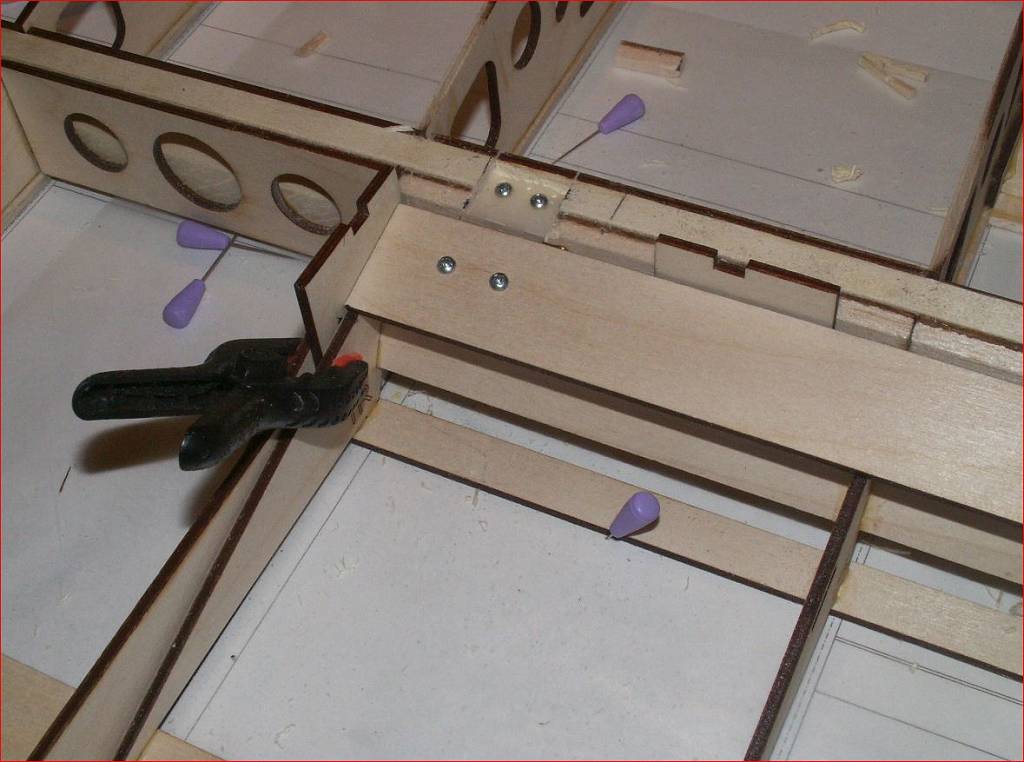

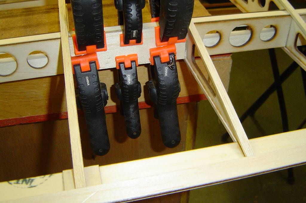

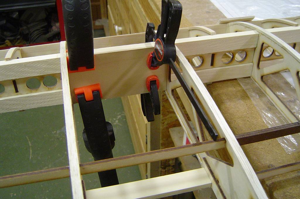

Spent the weekend working on the right wing panel.
Some small design changes to the aileron and now it is all hinged.
I can remove the screws from the top of the aileron and it is removable.
Used large dubro hinges and they are screwed into the top of the spar with a cap strip over top.
The control horn rib can be glued in place when it is time to cover,

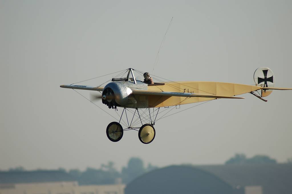

You are right! It would be a very interesting plane with wing warping and a full flying stab and rudder.
Here's a shot of my third scale EI from a couple of years ago.....it had wing warping and a full flying tail.
