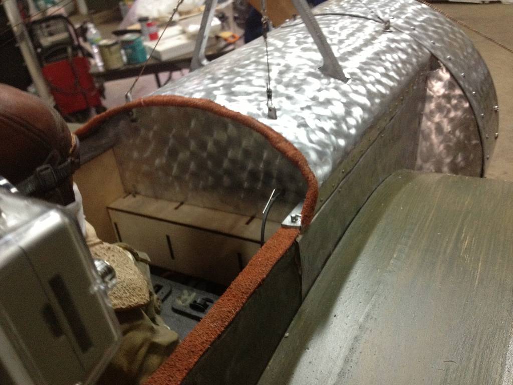

Next test flight this weekend! I will have a Go PRO mounted because we are going to put the Eiii thru its paces!
[/quote]
Paul.......starting to look like an airplane now.......your metal work has breathed like into the Beast!
I just checked this morning's weather forecast and it is not supposed to get above freezing this weekend - high of 30 on Sat and 32 on Sun - brrrrrrrr
Larry - GoPro is an on board video camera - if it gets exciting, we will have a bird's eye view of the carnage!

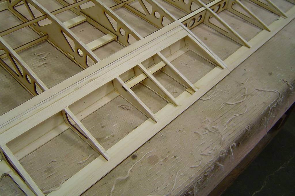

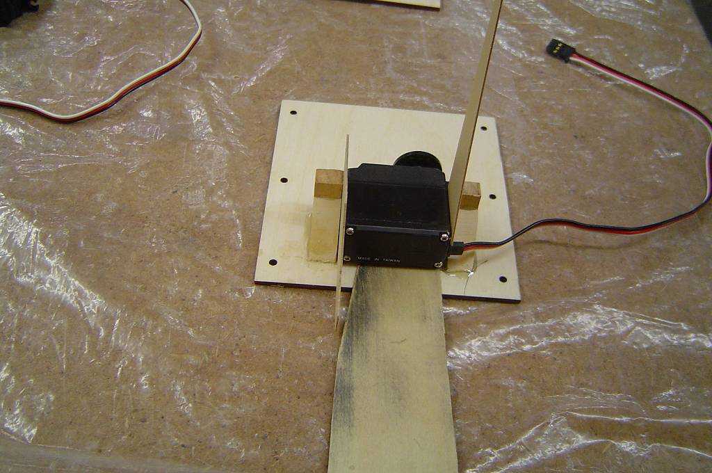

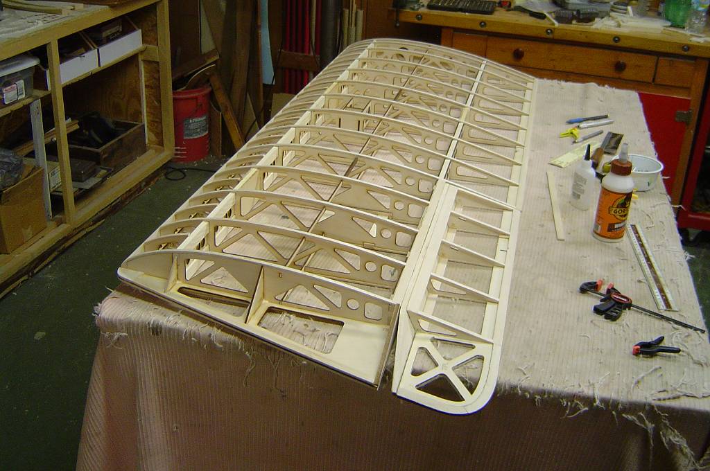

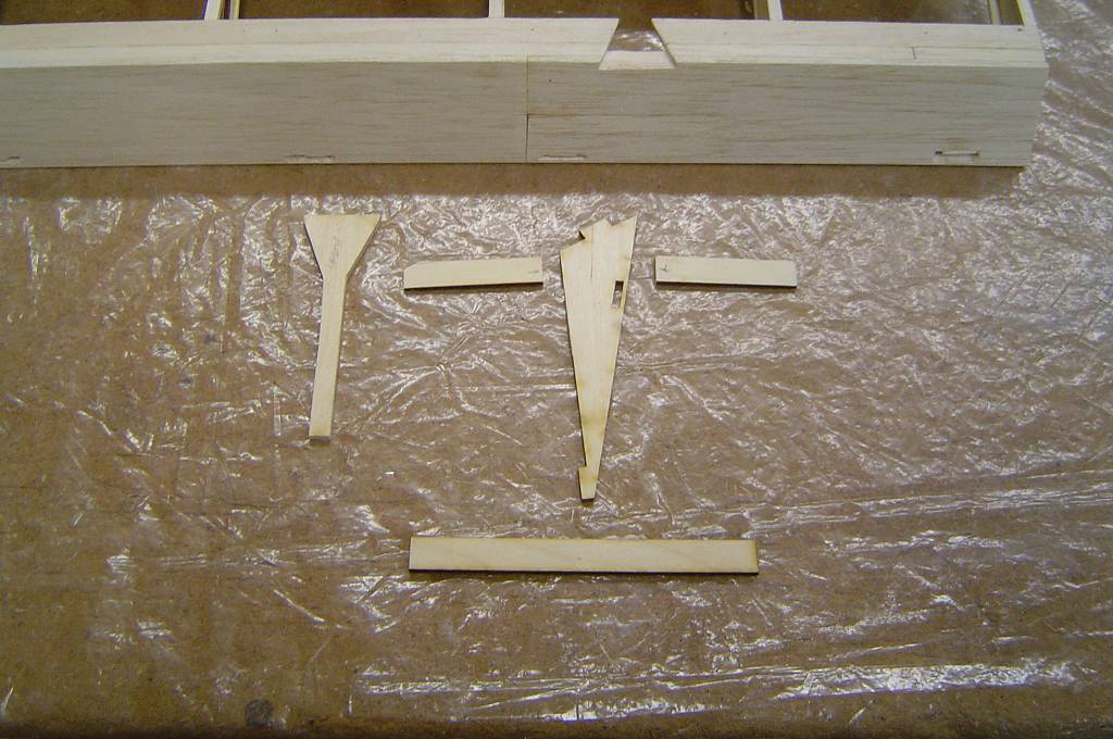

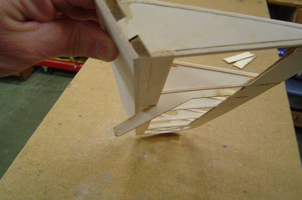

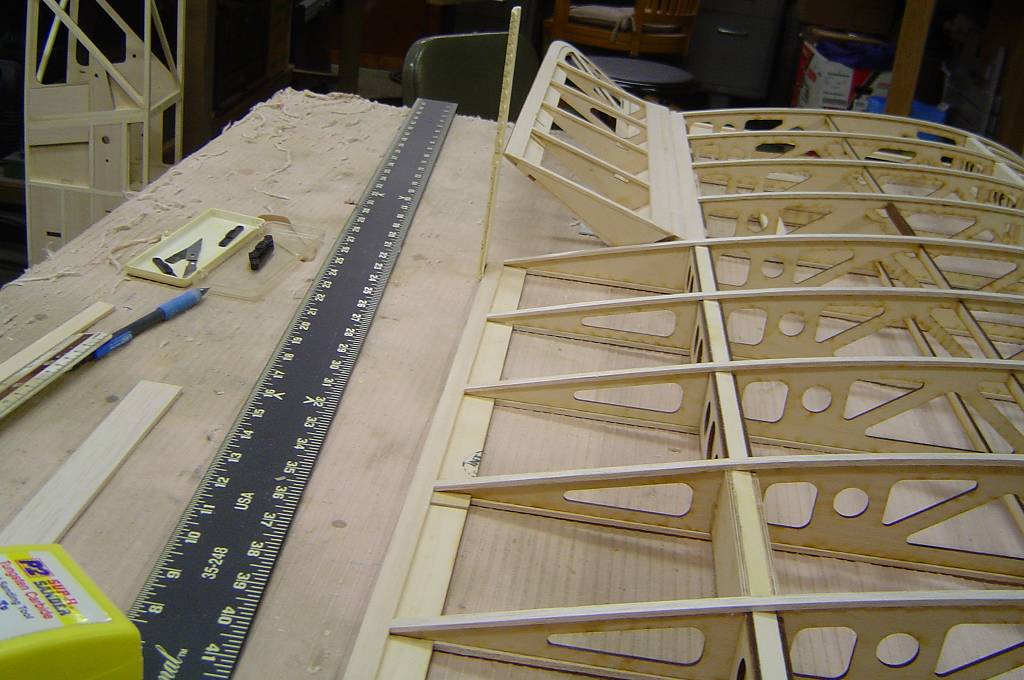

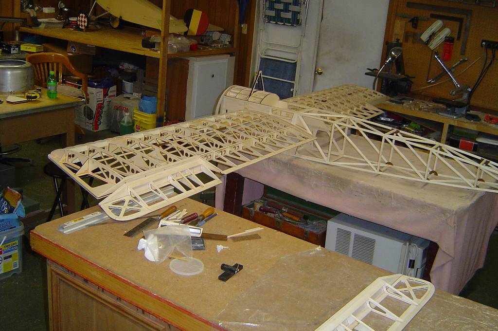

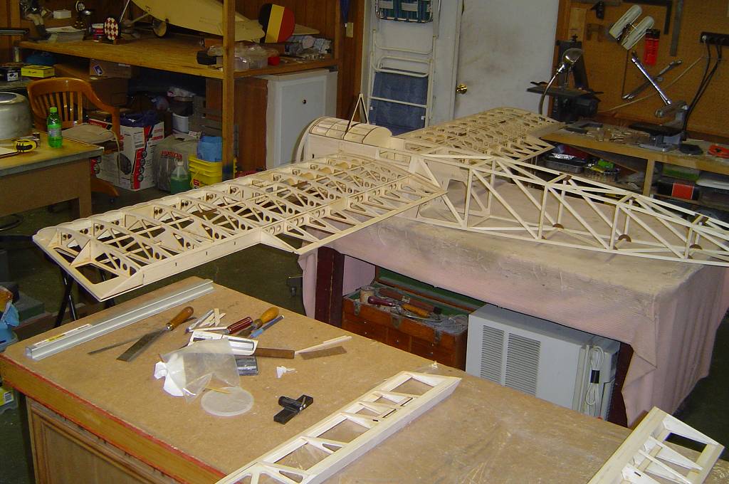

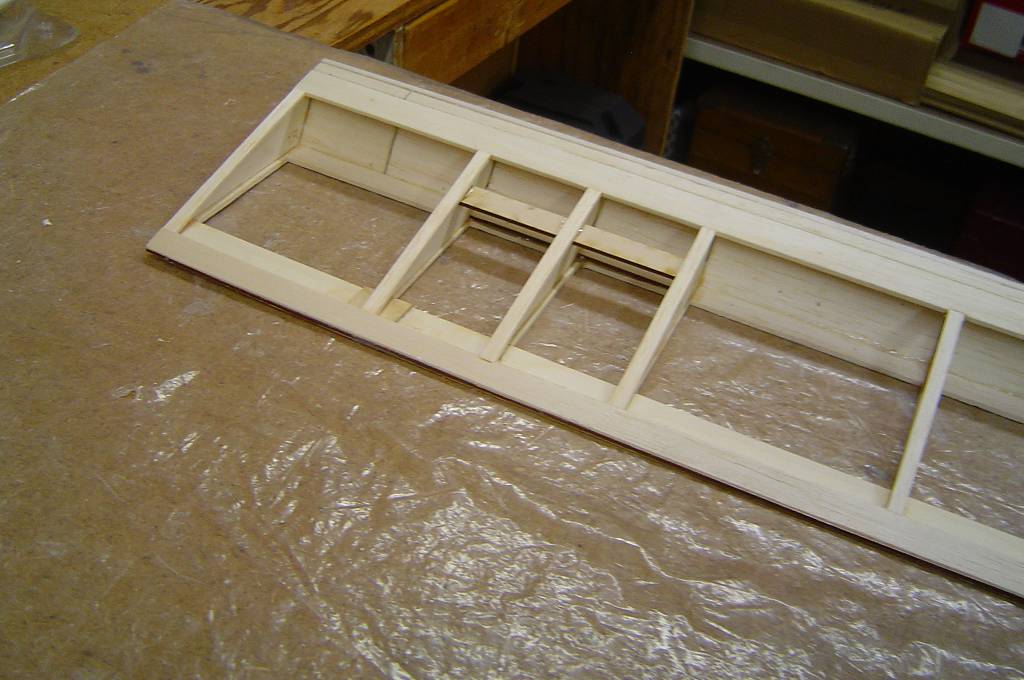

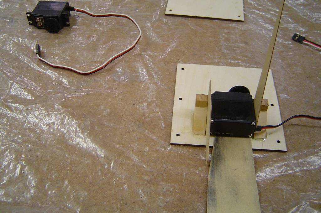

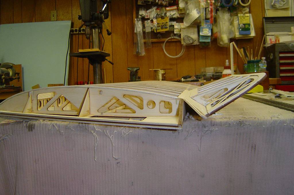

Step by step, little by little.......that is the way to get a project completed. Even if you are tired or running low on artistic juices, this process works!
Hey Larry, you did know that I am a slow builder, right?
The wing tip edges have been reinforced and glued on and gussetts added to strengthen the tip for when I gouge it into the gound - oh wait a minute.......the never happens, does it?
Next up the ailerons need to be fitted and hinged, servos installed, push rods cut and fit, aileron horn installed, wing tube installed......and the list goes on. The more I get accomplished, the more I find I need to do.......

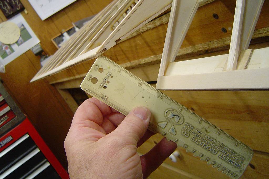

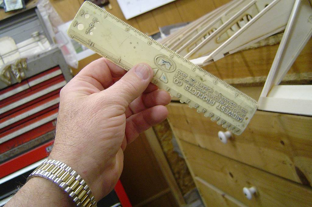

Turtle Report

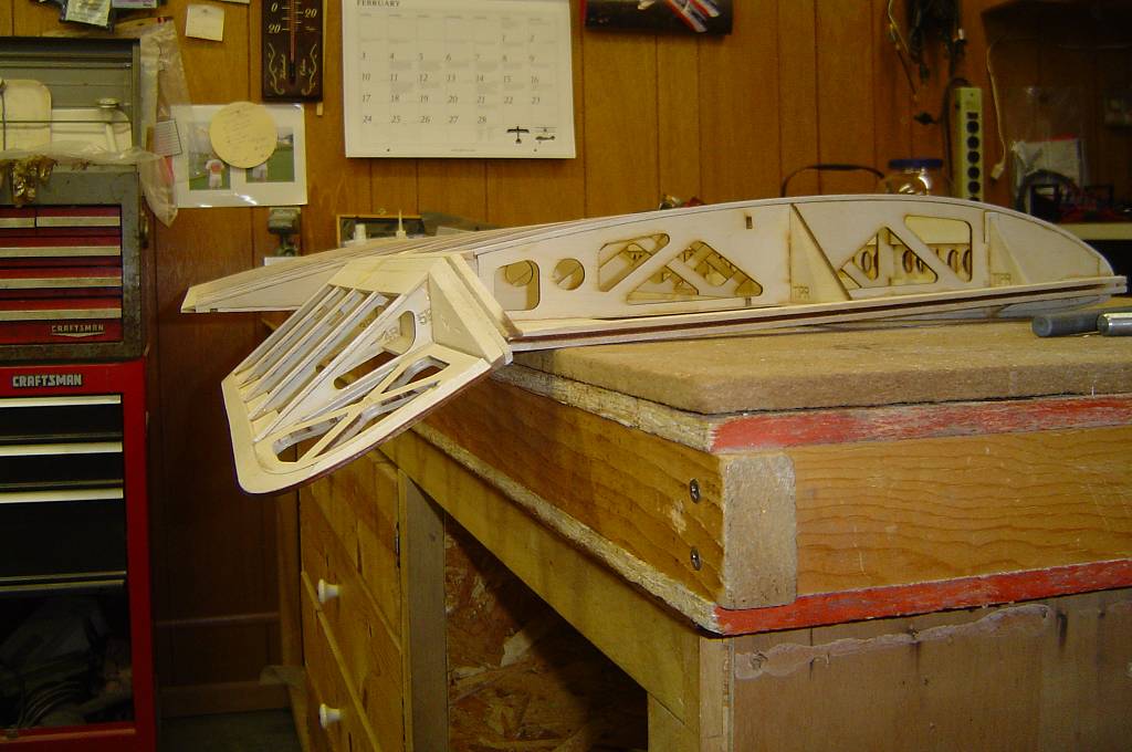

I finally got the ailerons hinged........I HATE [:@] hinges! [:'(] When I get to a part of the build that I don't like I tend to procrastinate.....[:-] and, uh, er, well that's the reason for the turtle reports.
Just for kicks, I checked to see how much movement the design allowed - WOW - an easy 2.5 inches up and down.
I'll probably leave that much up travel and put in maybe a half to 3/4 of an inch down.......a big flat bottomed wing rolls better with a good amount of differential dialed in to the ailerons.

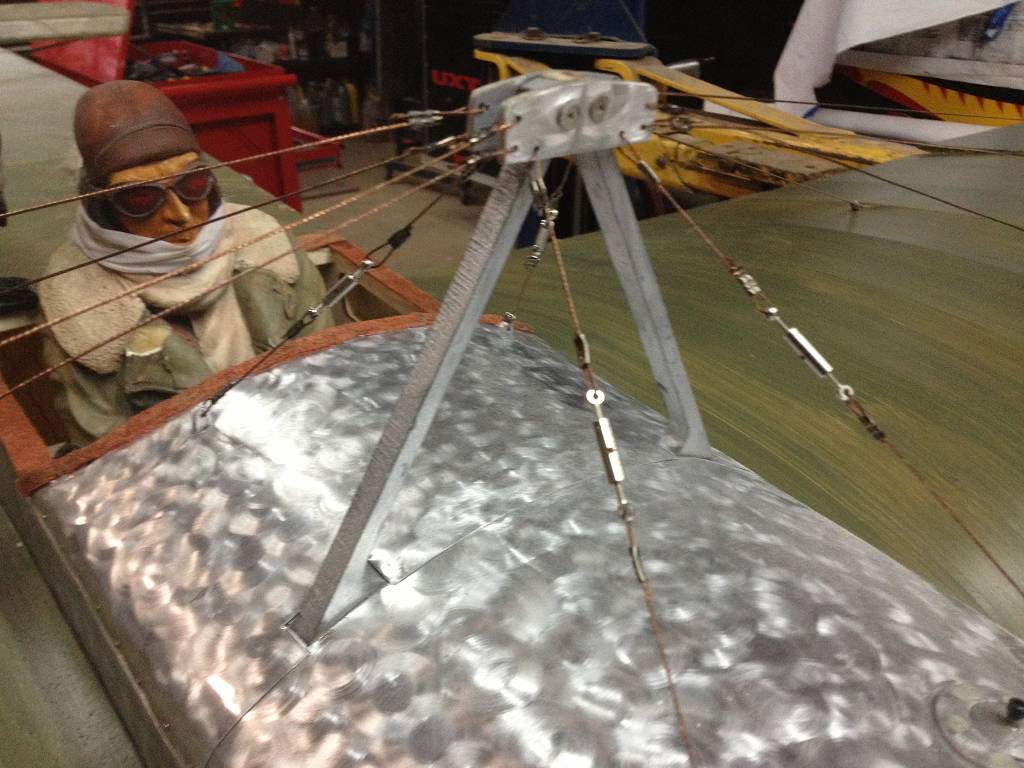

Here are some pics of the EIII going up this Saturday.
We will have alot of pics and video..........
Maybe Art will stop by and we can get him on the sticks...........

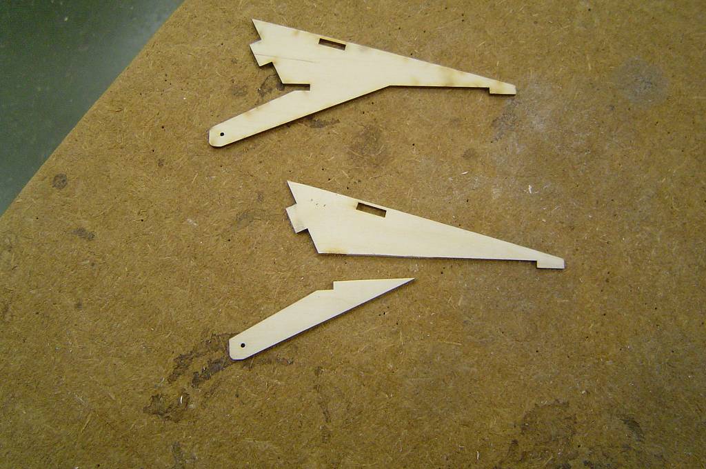

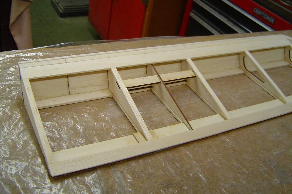

I modified the ailerons. I cut away the built in control horns, laid in a/c ply and will use conventional control horns.
The reasons were two fold - first I thought that the original horn was a little weak (easily bent to the side) and second, I just know that somewhere down the line I would break the horn loading the wings into the van........I have done things like that before.
So now when that happens, I can just unscrew the broken horn and replace it with a new one.

Are both the flying wires AND the landing wires supposed to be functional? I ask because if the landing wires are also to be functional (or at least semi-functional) then I wonder whether using ply for the top pylon is sufficient. I certainly wouldn't trust it. At the very least, I'd want to sandwich a piece of music wire between the ply parts.
But, otherwise, it's looking very good indeed. I almost (almost) don't notice the "split" rudder. It would be nice though if the wing roots had a scale "notch" in them, however, to allow for the proper shape cowl cheeks.

Abu,
The flying wires are semi-funtional, they were put on to keep the wings from twisting.
The 4 cables were installed to the plywoood "A" post to keep it from a twisting load.......it is plenty strong.
I certianly trust it and we will put it thru the paces Saturday and I'm sure it will be fine.

HPA, I see now that you have support cables (with turnbuckles) on the rear side of the A-pylon as well. I hadn't noticed them before and was afraid that the pylon might simply be broken off on a rough landing. Still, I think if I were going to build one, I'd replace the wooden pylon with something like streamlined aluminum.
Anyway, it really does look great and I look forward to hearing about how it flies this time around.

Turtle Report
Aileron servos can now be mounted.......
ID:	1858647   Click image for larger version

Hey Art .....
Do you shim your servo off the plywood so it get the full shock absorbing function of the rubber isolators?
And will you pin your mount blocks or just trust the glue ?

Yes, I will shim the servo when I drill for the mounting screws. I use a small piece of 1/32 inch a/c plywood placed between the servo and the ply hatch for a spacer. I also use the same shim when I locate the servo mounting blocks - I place the shim between the servo and the mounting block (I do this on both ends). This gives enough space around the servo so that the case doesn't touch the mounting blocks or the plywood hatch.
Sometimes I drill and pin the mounting blocks and sometimes not - I haven't yet on this plane but I might.
We can only hope that Greg will wear them - I think the kids will enjoy the show!
ID:	1858953   Click image for larger version
ID:	1858954   Click image for larger version
