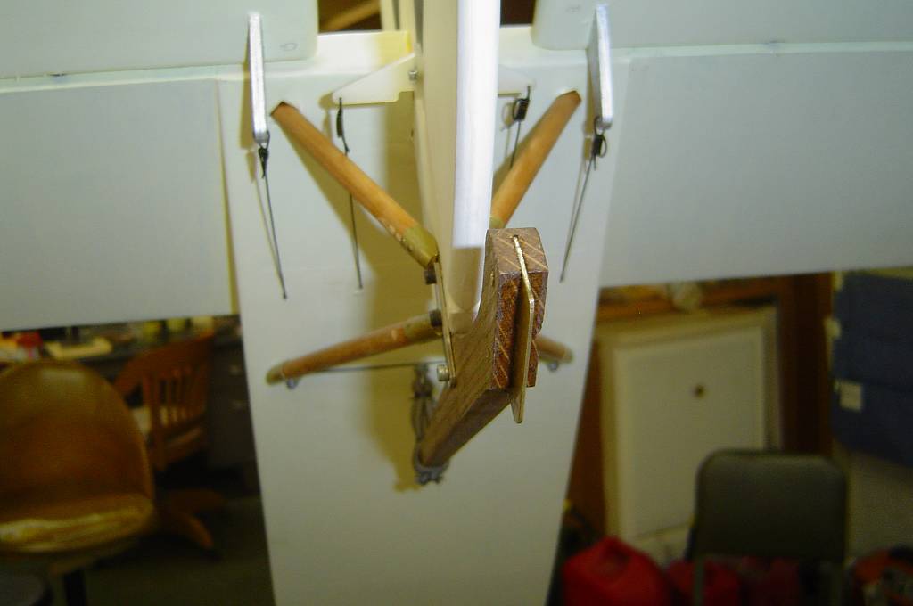

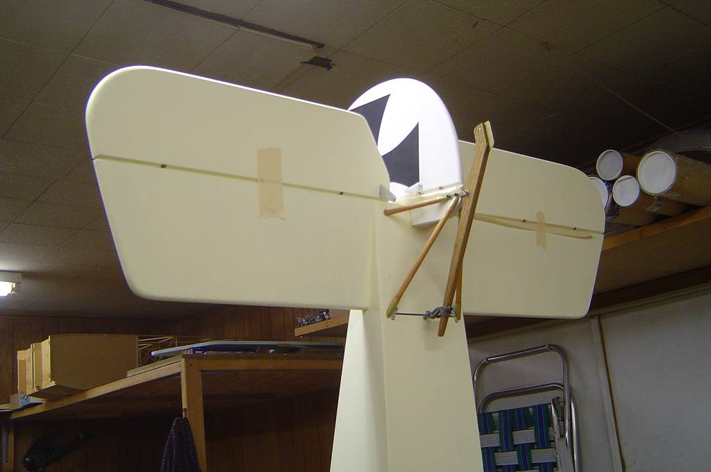

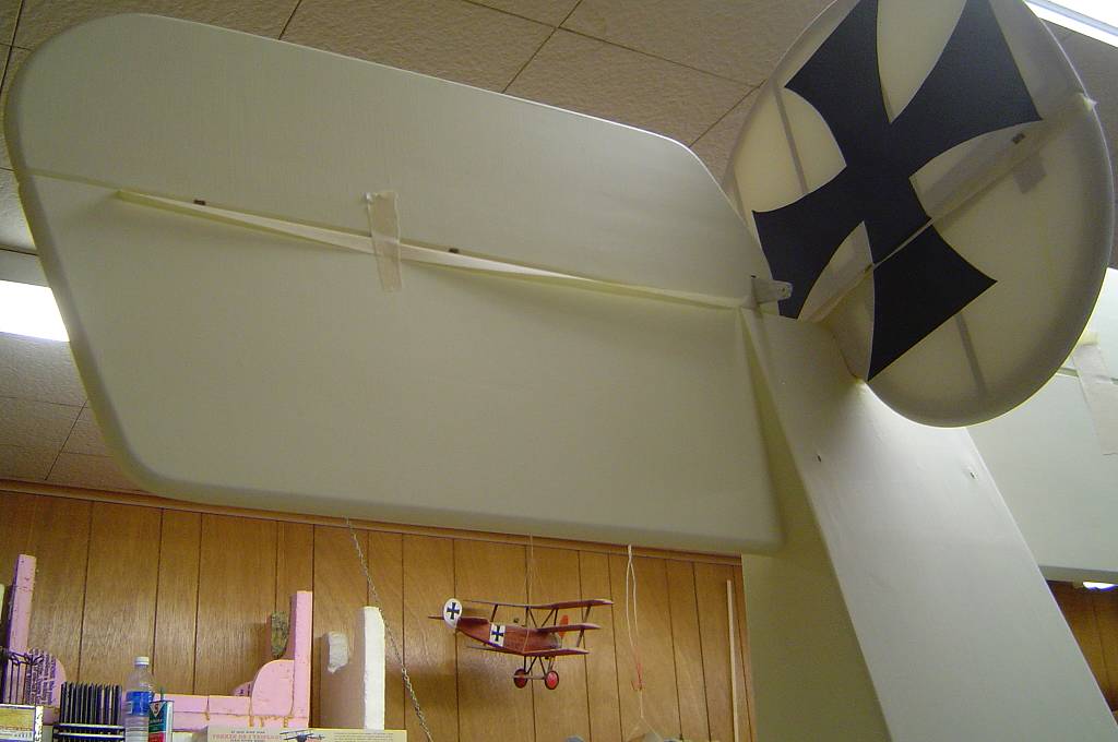

BACK TO THE BUILD
Turtle Report:
I got a couple of things done this evening, but I can't quite remember what it was.......
......let me look at the list [:-]- oh ya, the tail skid is glued, bolted and bungeed and the axels have a slight groove (made with the Dremel cut off disk). The set screw engages that groove - the loc tite keeps the set screw in place and my wheels don't fall off on the maiden flight (do you hear me Barry?)
The maiden might be sometime over the 4th of July weekend - Sir Percy, is there a convenient time and place for a video?
ID:	1895691   Click image for larger version
ID:	1895692   Click image for larger version

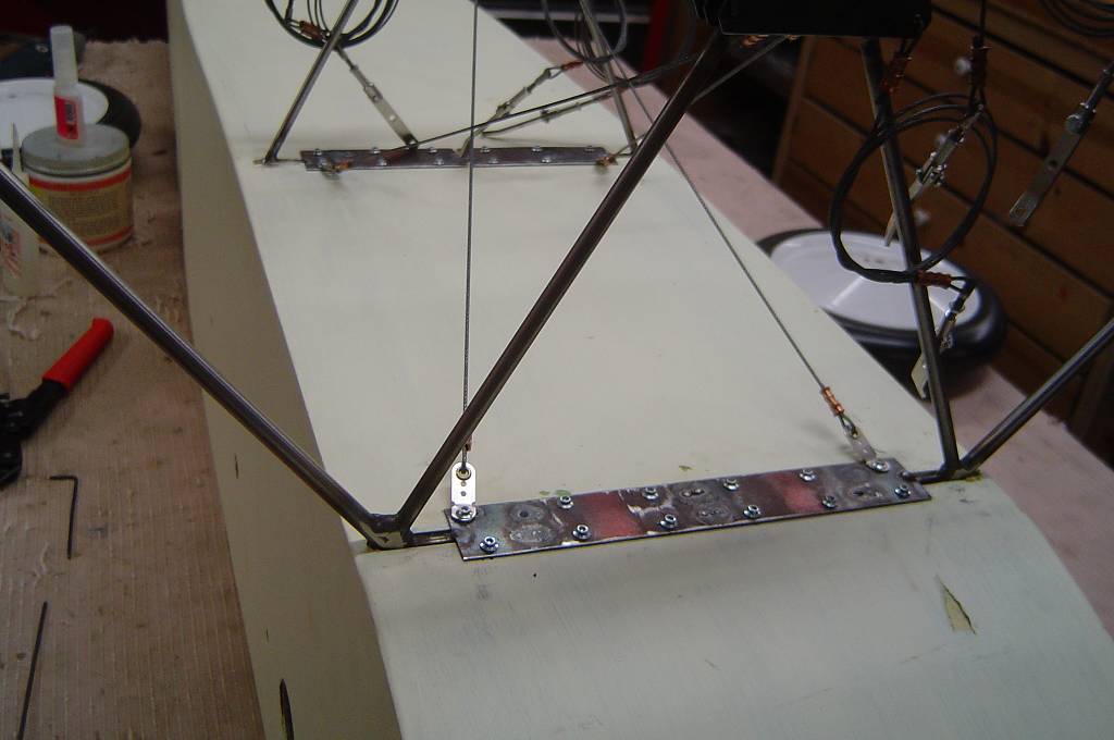

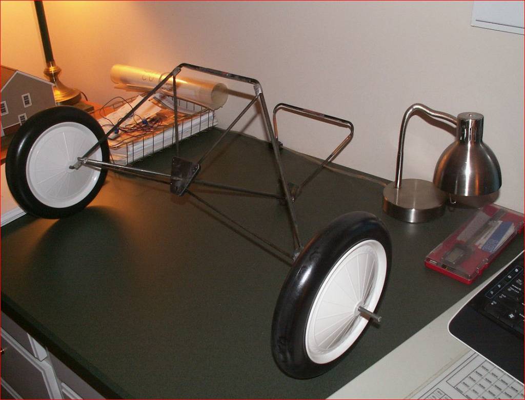

Gear Update.
Finally have a gear complete enough to mount to the fuselage.
Still have some of the plates to solder on but my next step is to permanently mount the hardwood gear blocks
in the fuselage and mount the gear with 4-40 bolts and blind nuts.
Then cover the fuselage.
Larry

Turtle Report:
I got the aileron extensions soldered onto the ailerons. Anytime I have a long run for an extension and especially when the plug is hidden out in the wing, I solder the connection. By design our servo plugs are self cleaning - just the act of plugging and unplugging the extensions keep them clean. When they are buried inside the airplane are not unplugged on a regular basis corrosion will build up and there will be a voltage drop to the servo........eventually it will become erratic and loose much of its strength. At least that has been my experience over the years.
I spent much of today soldering, installing and adjusting my aileron servos. I also screwed on the control horns and made the push rods. I have a new radio - a Futaba 8FG. It has a touch sensor wheel for programming and a much different layout of menus than my old Futaba 7C........most of this time was spent learning how to use this new system.
I'm getting there - S L O W L Y
Speaking of slow........... Larry, the Nats are only two weeks away and your entry must be received and processed by July 10th.
Your gear is looking pretty good.

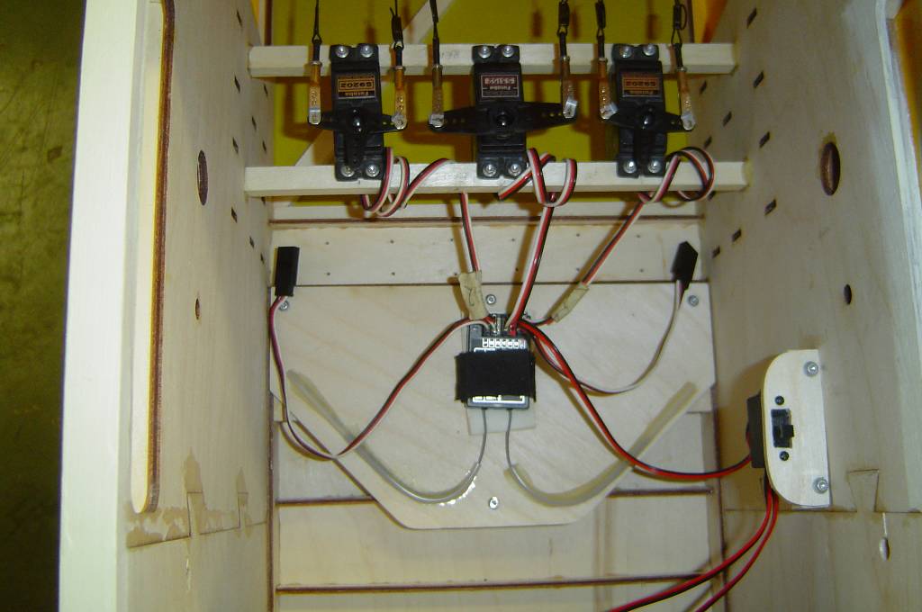

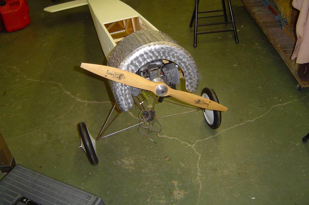

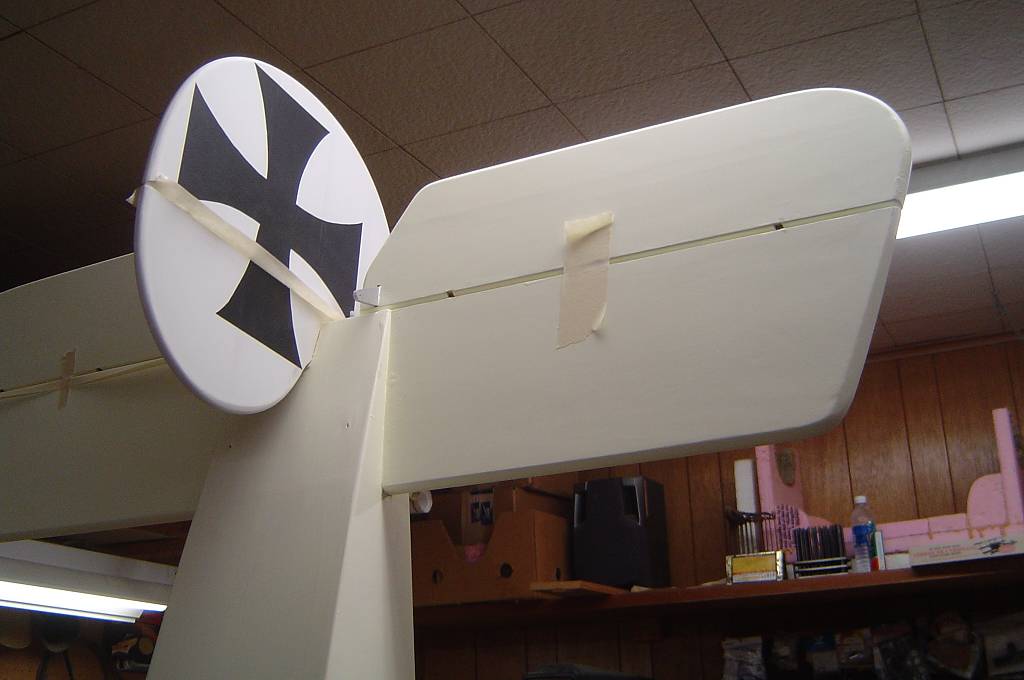

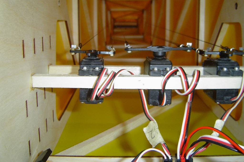

Work continues on the big Eindecker.........
.........the control cables to the tail are now complete - servo arms screwed to the servos and the Sullivan clevises are secured with their special keepers.
All control surfaces are a go. I am using nylon coated steel fishing leader for the control cables.
........tank, throttle control rod, receiver battery and gluing in the anti-rotation dowels are next on the list.
That leaves fuel proofing the firewall, re-installing the engine and mounting the cowl to do - after which it will be ready for the maiden flight.

Here are pictures of the last few items needed for flight.......
tank is in - cowl is on - battery & throttle servo installed and adjusted.
Loaded her up in the van and headed out to the flying field!
Put her together, fueled her up and then the engine coughed to life. It hadn't been run for 3 years or so at least. The engine is a Zenoah 445 with an exhaust flange and muffler torn away from the forward jug.......it was crashed on 1/3 scale Nieuport 17 when the radio apparently went into failsafe.......this was the engine that I flew my old 1/3 scale Eindecker (the one with wing warping and a full flying stab) The engine ran fine......prop was a Zinger 26x8.....performance was adequate......plenty for sport flying, but not much vertical.
Video was shot, but we cannot download it yet.......hope to have something in a couple of days.
A proper flight report and some stills from the first flight will follow when time allows.
oh, by the way........balance is on the wing tube without any added nose weight........weight is 40 pounds......if the other muffler could have been attached it would have weighted 40 lbs and 12 ozs.
