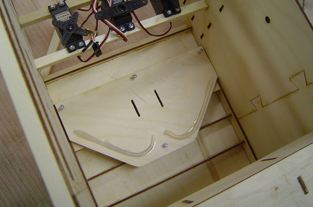

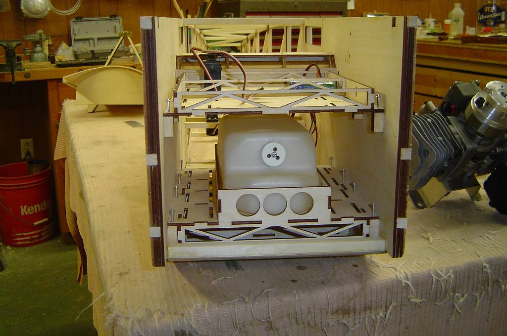

Working out the receiver, switch, battery and throttle servo locations. The battery and throttle servo still need to be mounted, but their locations are shown .
I made a tray to hold the receiver and located it directly beneath the pilot station. I glued in plywood pads to mount the rx tray. I am using a Futaba 617 rx so I needed to fabricate something to hold the antennae in place and away from other wiring. As you can see, I am using Velcro to hold the rx to the tray.
With this receiver location I won't have to use any servo extensions for the throttle, rudder or elevator servos.
And a shot of the tray arrangement for the tank as well as a picture of the battle tested Zenoah 445 twin.

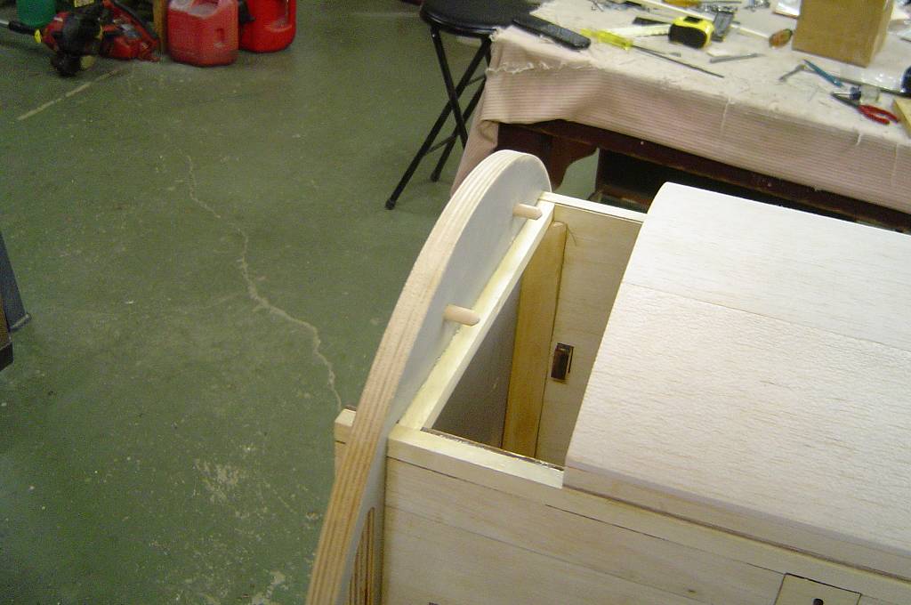

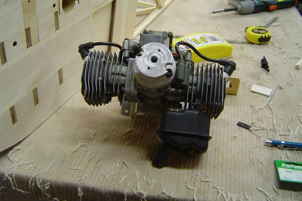

The 'turtle is running' report.......
The fire wall has been drilled for the Zenoah 445 and epoxied into place.......hardwood triangles have been epoxied to the back of the firewall.......the hatch has been fitted to the fuselage .....I glued the hatch locating dowels to the firewall and drilled for the screws which hold the hatch in place.
I also changed the switch mount from flimsy plastic to a plywood base.
Next up is to fit the throttle pushrod and the choke rod to the engine.
I think I can see the finish line - that rabbit ain't go nothin' on me!

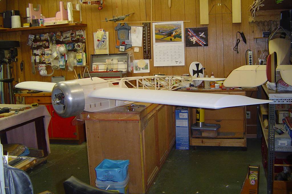

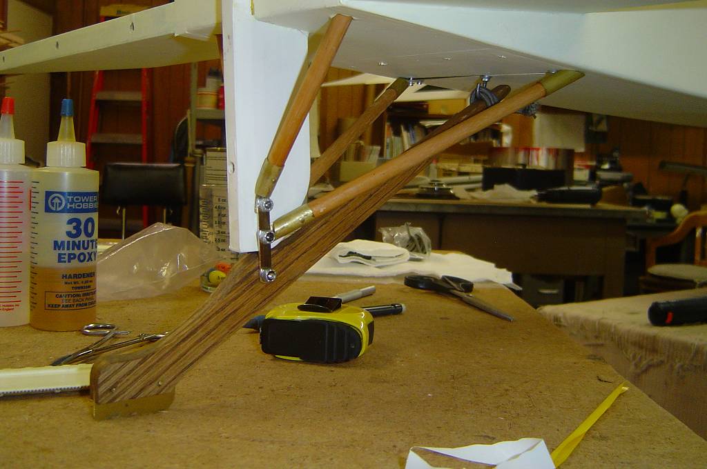

couldn't resist seeing it assembled (sort of)
that's a Balsa USA 1/3 scale Pup cowl - it's not quite large enough in circumference - but it gives you a good idea what it might look like.

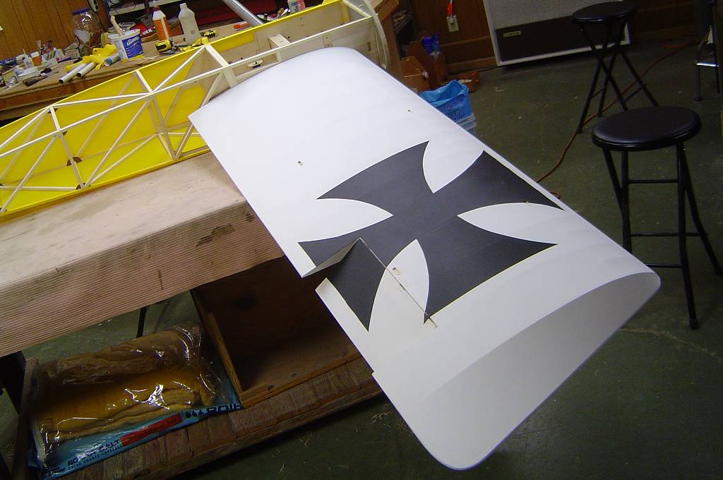

more pics.......
I had some Colortex Cub yellow but don't have a Cub, so I used it on this project. (after all, it IS the Balsa USA Cub airfoil)
The national marking is black Solartex - for me its an easy way to apply markings - (I'm not very good at painting) (read that as SLOPPY!)
I think I am going to paint the airframe green and mark it like the Austro-Hungarian EIII on the front of the Windsock Data File.

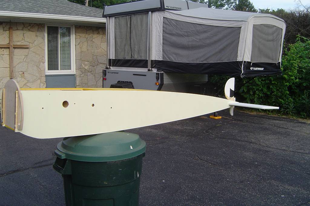

ORIGINAL: R/C Art
don't hold your breath waiting on the paint - it just might fly in these colors [X(]
NOPE ! NOT A CHANCE !
I started to paint it green, but the green was more of a Kelly green and definitely looked BAD (as in ugly)......so I opted for a cream, beige, tan, clear doped linen......these are all non-descript colors........pick what you want to call it........the typical Eindecker color.

I got the landing gear from Larry........there was a problem with the fellow who was making the gear and fitting the cowls........long story short, he is history and Larry is looking for another fabricator.
Anywhoooooo, I got the first gear mounted to the fuselage. I had to hammer on it some to get it to fit (like I said, there was a problem). I also fitted the tail skid and added the wings. Now it looks like an airplane!
Now I'm in the home stretch. Time to add all the wires and cables.
Here are some pictures as it now sits..... oh yeah, still need to paint the wing, too.......and add the national markings on the fuselage sides.
