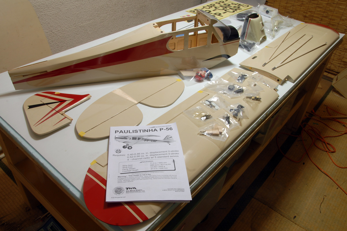

Meanwhile I also got myself a nice little ARF to fly on the windier days and just as one more model to fly after the long drive to the field. It's a model of the Brazilian Paulistinha P-56 which was an unlicensed version of the Taylor Cub. The ARF, from Modelcraft, is nicely built and finished, came with a lot of nice extras, and best of all was cheap (about $180). I already had the Saito 56 and all the radio gear. I've always thought that Cubs are good practice for WWI types. They can be a little funky in the air and you need to "fly them on the wing" and can't get too crazy with the aerobatics.

That Paulistinha P-56 looks looks an excellent bargain..and very nice looking.......Keep em flyin high

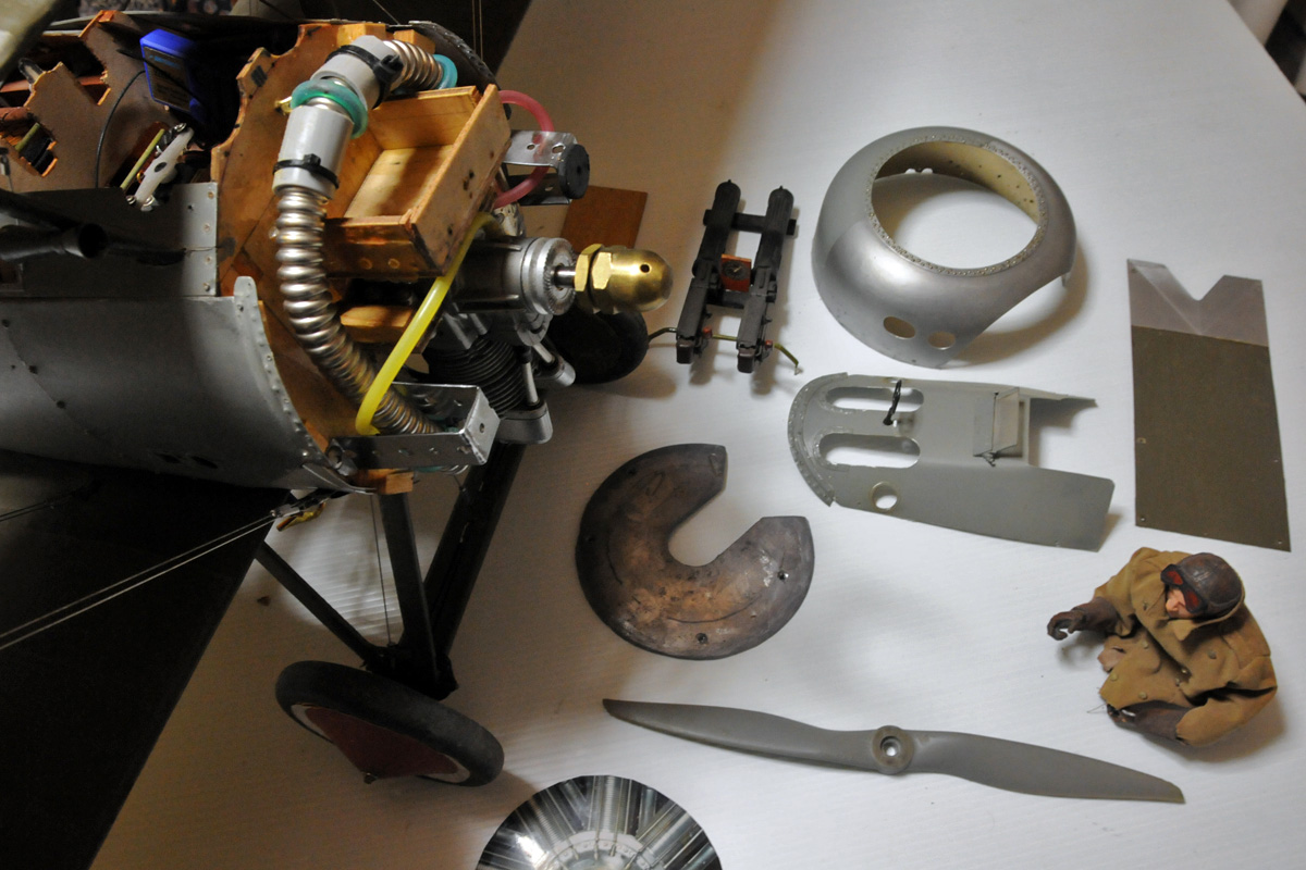

First step in preparing the Snipe for flight was to check radio operation. And nothing. So it looks like there's a dead battery (even after several attempts to charge it in the model). So I disassembled the front end to be able to get at the battery and am charging it outside to be sure that it's not a switch problem. Some foam had turned crusty and also found a spider living in my Snipe.
As you can see the "business end" is quite crowded. It's got to be since the nose is so short. Balancing a model like this is really tough. That custom molded lead pancake you see is as far forward as it possible can be and even then needs to weight 850g (30oz). This is a real shame because without all this weight the model itself only weighs 3.5kg. I'm sure there are a few things I could have done to lighten the model from the cockpit back, but honestly not that much.
Anyway, I'm going to put my thinking cap on and see if there is anything I can do to lighten the model overall and also to make the model easier to service.

Silkspan on the tail feathers IF you can get the dope!

Honestly, I just don't think a few grams off the tail is going to make any real difference. Even if we accept the idea that each gram at tail adds 5-6 grams at the nose, that doesn't put much of a dent in that 850g weight. I mean I know if flies, though I don't really know how it might fly slowly, so I almost feel that any weight removed anywhere will help.

The best of the best can use 1/2 the paint and get the same results. I doubt you can do anything of reason as it sits now. I would skip redesigning the model; its done. A bigger engine is a good way to trade dead weight for something useful. I would start perfecting the alignment.
