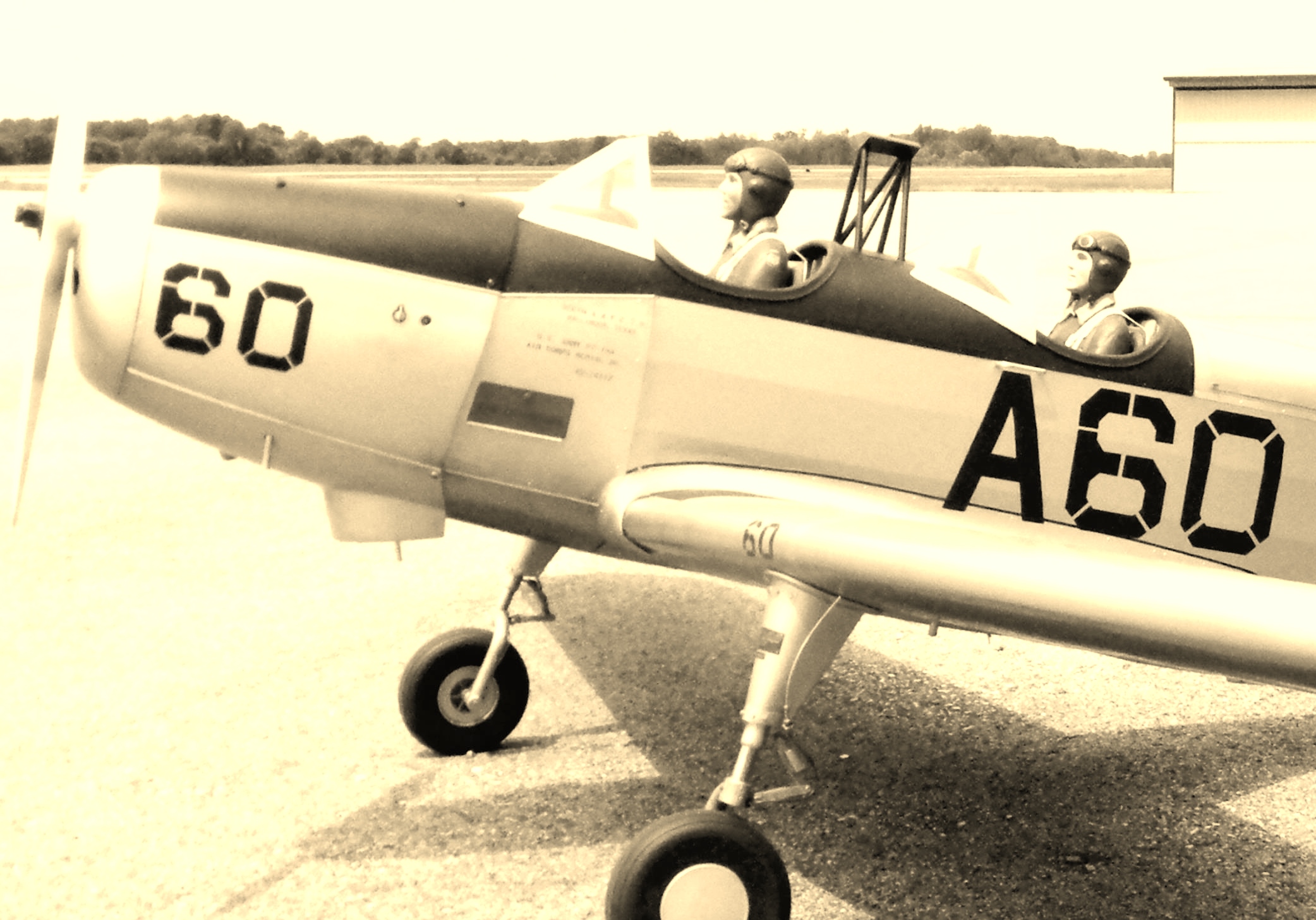

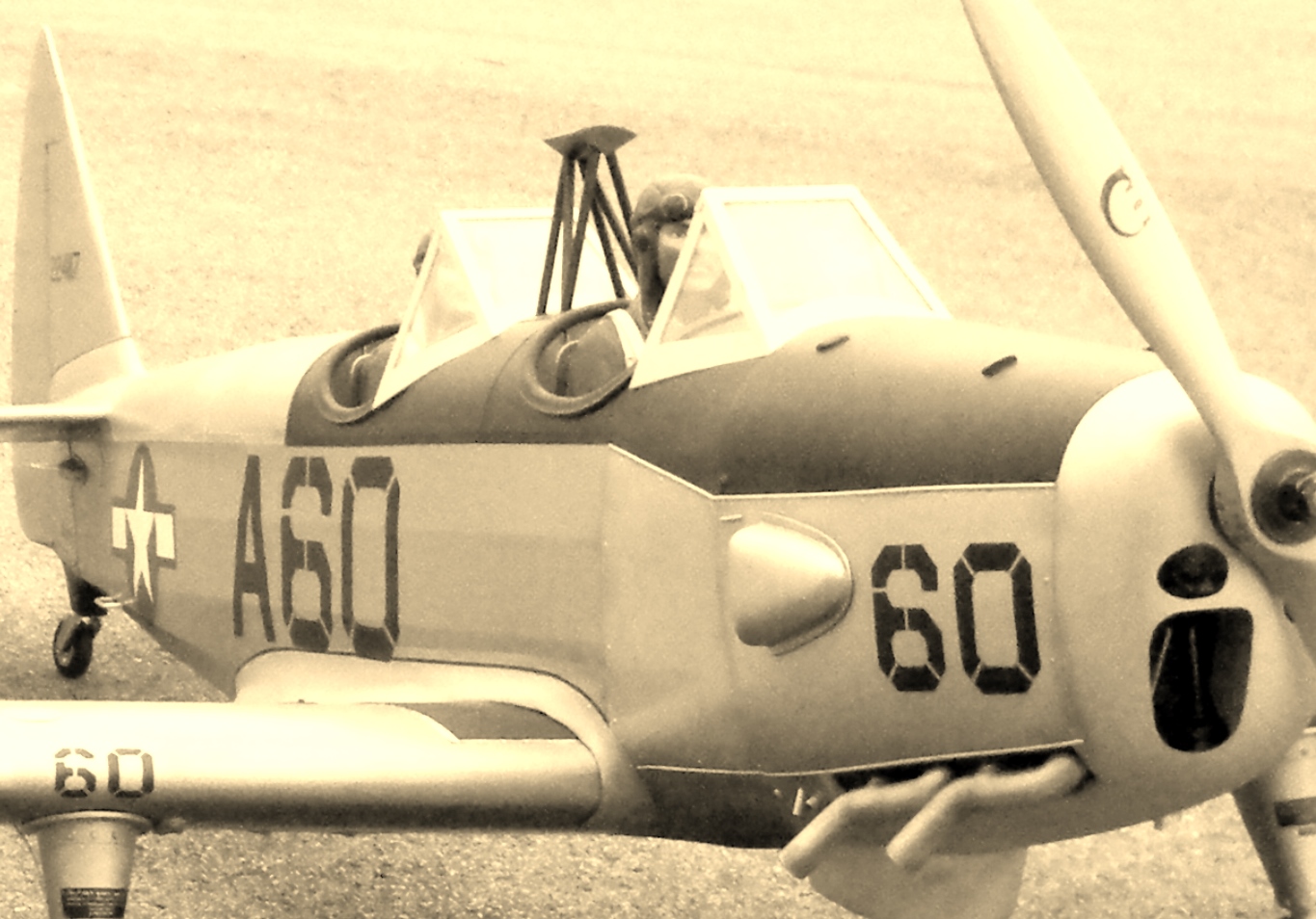

I agree about bashing another ARF. I don't think I would do another one unless I found one assembled and it was on the curb marked free.. The only advantage to bashing an ARF is that you get a jig built airframe that is light and straight. The project I am just starting is a 1/5th scale Boeing P12 C/D. The working plans are finished and I have atarted the molds for the corrigated metal componets...I am thinking over a year to complete. I have an original TF SE5a that I picked up for 10 US dollars on a fluke. It came with machine guns and pilot so was a great deal. After seeing how nice yours turnind out I have decided it deserves to be built someday. I have looked through it and it is a nice kit for shure.

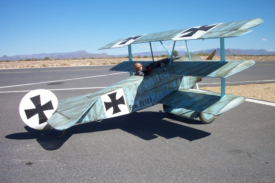

I have heard of incidences being set like that on a biplane where the top wing is slightly negative to the bottom wing. I set up a scratch built Fokker triplane in that manner and it flew perfectly The unrelaible reasoning for this that I was told was the top wing would stall after the bottom wing and the stall would be more stable...kind of makes sense....maybe? In looking through my plans for the TF Se5 it would seem impossible to get the engine thrust line off. Here is a photo of that Triplane that flies so well and it really does or did fly very very well. I sold it to a hobby shop owner in atlanta so I don't know if it is still with us or not.
