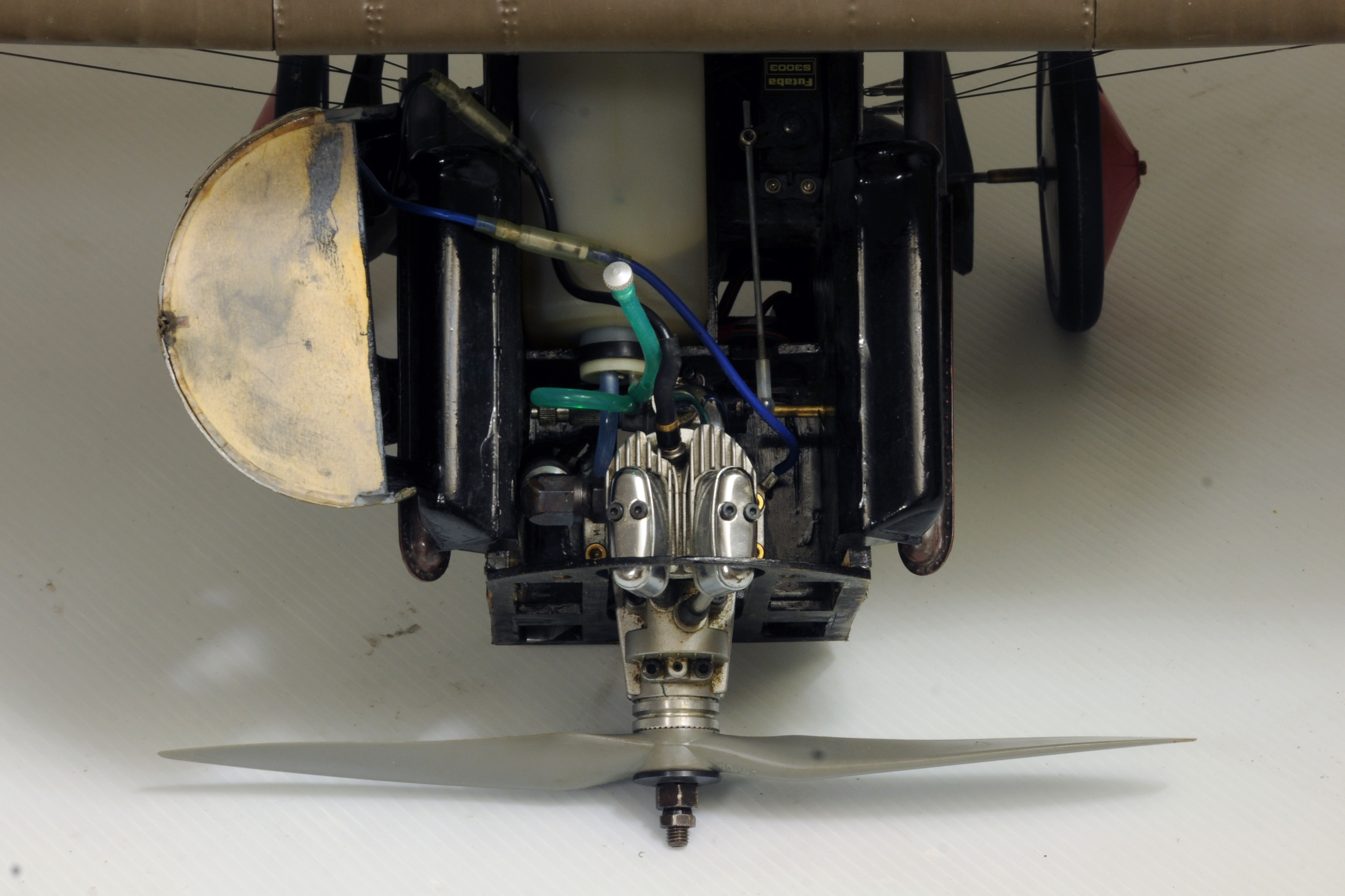

A shot of the engine alignment.

Abu, being 1/2 a world away its hard to communicate. Your effort on alignment looks well within the normal ASAP idea. Cool.
But I see MerlinV's point.
When I pull-up the engine picture and ran it on the edge of my laptop frame, your port side prop was slightly more aft. That would be left thrust and very bad.
a picture check is not good enough. This will only takes five minutes to check.
Get a piece of string, that will not stretch, and measure from rudder post to the prop tip. Mark it. Turn prop 1/2 turn for comparison. ( prop trueness). Now measure starboard side and do a 1/2 turn check too, to compare the marks. Your starboard prop side needs to be shorter. I'd say about 1/8 th to 3/16 th ( less than 1cm) or something about in that range.
It is just like checking the wings for squareness to the fuse. She is a great looking plane. Good luck on the re-maiden.

Thanks for that tip. I had been wondering how people check side thrust since you can't do it with the meter. I will check my model, but again it looks dead-on to my eye. Alignment in the photograph might be more due to an off-center camera and a wide-ish angle lens.
But I'll check.

So...after checking with the "string method" (actually using a wire cable) I found that the left measurement was 2mm shorter than the right measurement. That means there was some small amount of left thrust.
To correct this I had to completely removed the engine, cut down some of the wood around the engine and enlarge (and file) the holes in the mounting platform. Now I've managed to get that 2mm shorter distance over on the right side (so a slight amount of right thrust).
The method that the model uses to mount the engine (beams with ply "shelves") is not new. And I think it's intended to make straight engine mounting fool-proof. Well, I certainly proved THAT wrong!
