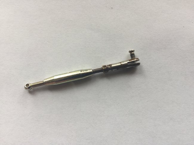

I've suggested before, but why not use Mick Reeves' clevises in conjunction with his 2mm turnbuckles? Take the RH tread eye out of the turnbuckle and replace it with a threaded MR clevis on a short length of 2mm bolt, (with its head cut off). The clevis pin is threaded all the way through, so you unscrew it halfway, (or a little more), and the fitting is free of the rigging. The opposite end is the usual swaged loop. The resulting fitting is pretty small and unobtrusive.
That looks promising. I've been thinking of ordering a full set of the MR steel clevises (which apparently are now electroplated to look like brass).

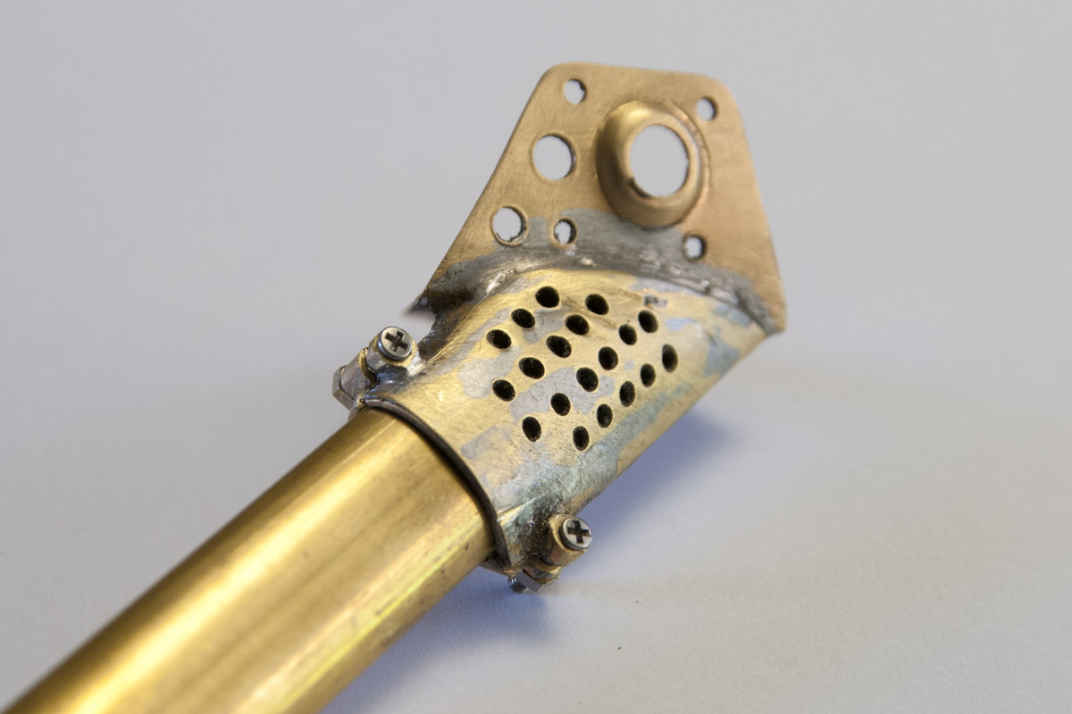

Here's one of the finished undercarriage brackets, which are also the connection points for the flying wires. Whatever setup solution I decide on has to work with these. I've put in way too much work on them to back out now.
