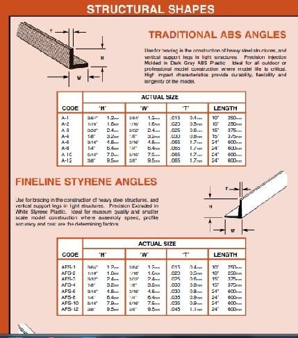

Originally Posted by airsteve172
The material included in the TopFlite kit for making corrugations is actually "L" shaped styrene strips that are glued open end down forming a triangular peak on the surface. The same material is available as stock styrene shapes from Evergreen.
So something like this would be preferred.

Has anyone been successful in using the Top Flite L plastic strips and heat shrink film covering?
You would probably need to cover using many film strips cord wise, but wondering if anyone has actually succeeded?

Assuming that the intended color is to be white (which is pretty common for this type of aircaft), the suggested procedure is to first cover the control surfaces with film and thereafter apply the strips using CA.
For any color other than white, I would still cover the control surfaces first. The color of the strips would then have to be matched. If the correct color paint can be obtained, this would be the best method of coloring the strips before gluing them down to the surface.
Using film on the strips for color, while not impossible, would be a very tedious process, to say the least.
Since the strips are styrene plastic and therefore sensitive to heat, they may be affected by the temperatures necessary to apply film.
Be warned that whether you choose the most successful method of installing the corrugations or you're going to experiment with your own technique, it's a slow and painstaking process, but the results can be very rewarding.
Although it goes without saying, check on the real aircraft for the quantity and exact positioning of the strips. I've seen gross inaccuracies in this area even on elaborate giant scale ARFs.
I am personally not using film, but still prefinishing the control surfaces prior to adding corrugations and I can say that these styrene strips do work quite well!

My own suggestion re. installation of corrugation strips is as follows:
When using a film covering, cover the control surfaces first before attaching the strips. Before installing the strips, make sure there are no surface contaminants by thoroughly wiping down the surfaces with isopropyl (rubbing) alcohol and don't touch those surfaces with bare fingers. Thin CA glue does an excellent job of gluing the strips to the film.
For those who are using more traditional finishing methods including fiberglassing, I would highly recommend that all finishing work, short of painting, be completed before attaching the strips. It becomes infinitely more difficult to fiberglass, smooth and finish the intricate surfaces after the strips are attached. Do all the finishing first and when the surfaces are ready for paint, attach the strips immediately before painting. After the strips are installed, if something is not quite perfect it's a lot easier just to do the corrections now instead of trying to do finishing work on all the complex surfaces at this stage.
If you do a clean gluing job, there should be very little to do before paint.
