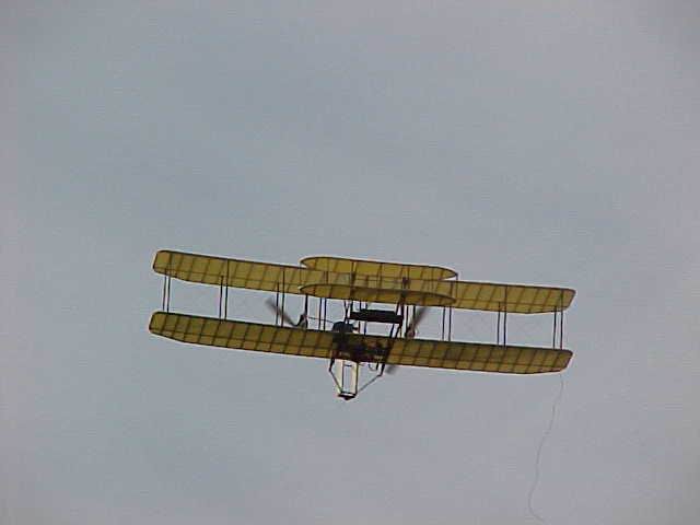

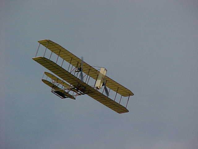

That question is too easy as if you want a good electric Wright Flyer at a reasonable price, build the Pat Tritle designed Dare Engineering kit which flies great! About $65 plus labor, covering and hardware. Here is mine with over 100 flights on it. Never crashed in normal flight but did get caught in a tree on the edge of the flight line that reached up grabbed it when I was flying in too close for the club photographer! A fall of twenty feet didn't improve it!
PS: yeh, there are some plastic ARF's of the Wright Flyer out there but after the Dare Pat Tritle design, I would not want one. Not very scale looking

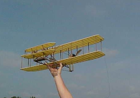

Using the GWS DXA motors and gearbox, same as in the GWS Tiger Moth. The props are GWS 9-7 cut down to 8.5 diameter. Both props rotate in the same direction as reverse pitch props were not available for electrics when I built it a year ago. Since then, I understand that MPI now has reverse pitch props available for small electrics so I would suggest using opposite rotating (left and right hand) props for someone building a new one. The batt pack is the 8 cell 720 NiMh pack. It weighs 14 oz. ready to fly![

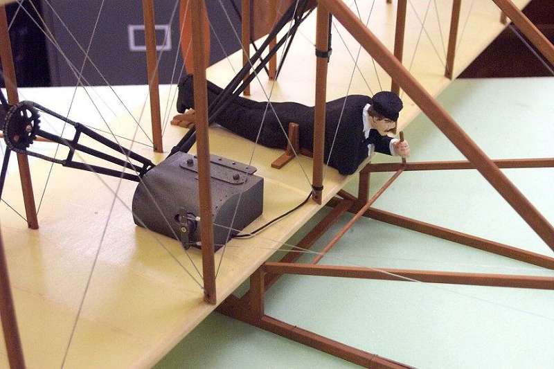

If you buy a new flat pack, be sure to get 8 cells if NiMh battery or 7 cells if a NiCd pack. A 7 cell NiMh will not hack it and you will be disappointed. Attached is another modeler's Dare Wright Flyer using a LiPo battery.
