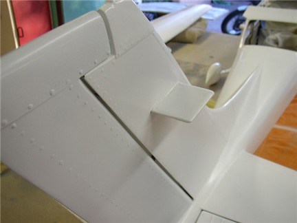

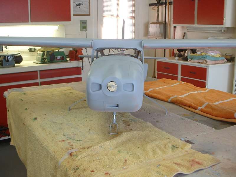

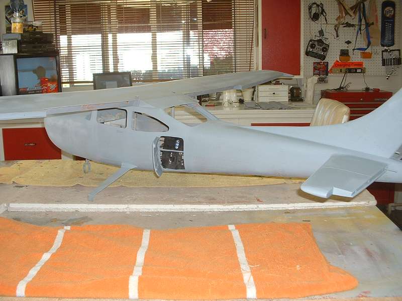

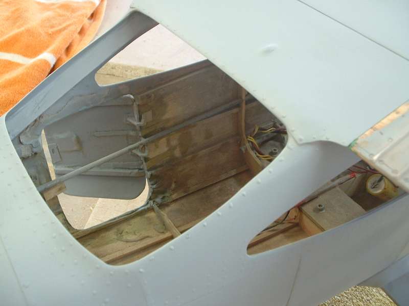

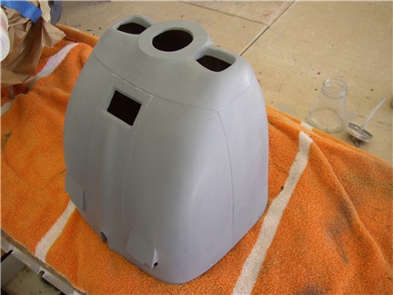

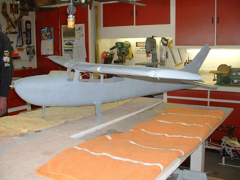

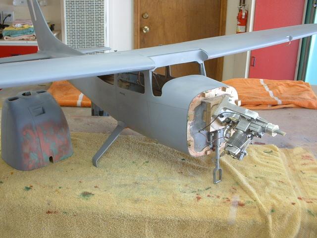

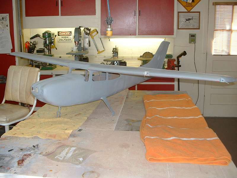

Some photos of the Top Flite 182 to the newer 182T. New cowl and a fiberglass rear wind frame. Saito 100 that bareley fits into the cowl. Have much more work to do but feel like I'm closing in on it.

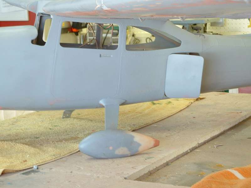

More Pic's

Danny, Thanks for the nice comments. I have seen your's before. Very nice. That is where I got the idea of hiding the on board glow, switches and charging jacks. I figure I have put about 4000 rivets on mine, both flush and pop. Very time consuming. Made the cowl from scratch. Used the rear window as the mold to make the fiberglass frame. Am going to make new seats for it using the pictures from Cessna's web site. Thanks again, Randy

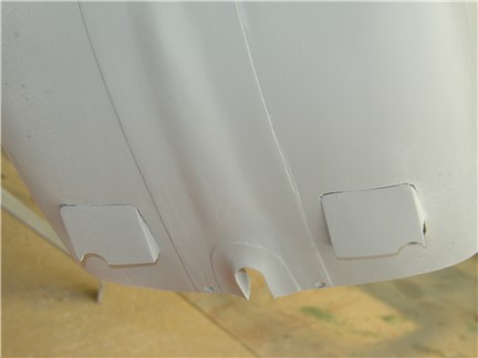

Thanks SD and as always Mr. Crump, The cowl was quite the challenge for me as it was my first time to make a plug and so on. Now I get to form the seats as well. Anyway thanks again guys. Tom, I will speak to you tonight..

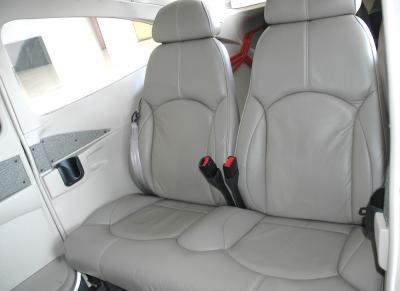

Okay, okay guys, here are pictures of my seats for the Great Planes Cessna ARF. The model’s stock interior, if left alone, looks like the inside of a canoe!! I am covering this all with cardboard which remains flexible and can be removed to enable me to get to the radio gear. I had to come up with some scale "looking" seats so I decided to try my hand with some construction foam. I found that I could sand it without it crumbling to bits.
First I drew a pattern on paper of the general layout of the seat sections (See photo of the real thing). Then I drew this on to a foam block. I then sanded the general perimeter shape. Most full-scale seats have a gentle concave shape so I used a large closet rod with sandpaper to round the centers out. I carefully cut each seat’s section apart and continued to sand and round these edges. Then I glued them back together with RC 56 canopy glue.
I did all of this rather quickly so there is a little unevenness with this first attempt as I am not building up a precision scale model, after all I started with an ARF……good only for fun scale contests! But, note their weight on the scale……..next to nothing.
