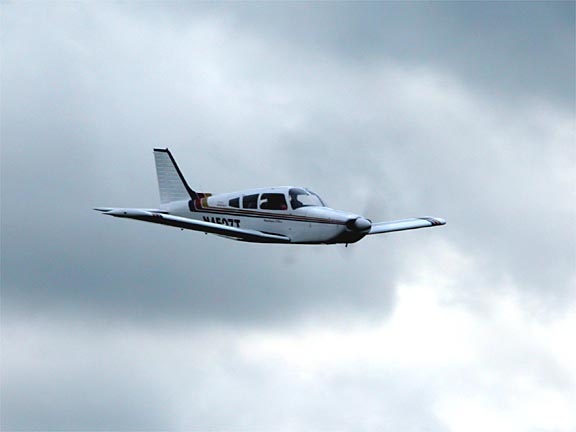

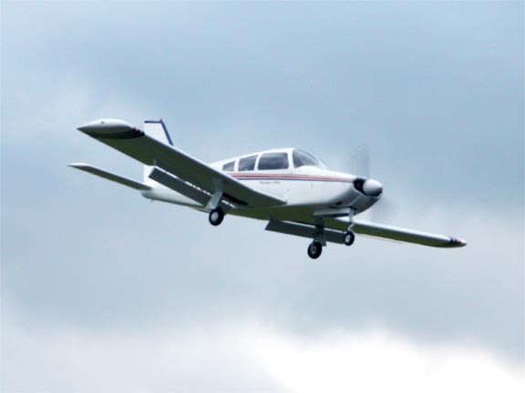

Here are a couple of photos of Teamscalepilot's Arrow II during practice this last week at Top Gun. It's powered with an OS .91 2c.

I'm just nor sure I want a 2c. I put my first 4banger in my last plane and I love the thing. I was thinking about a Saito 100 anyway. Keep the input coming. Also any ideas about anything to add? I saw the gear doors on the teamscale plane and I love them but this is my first scale project.
