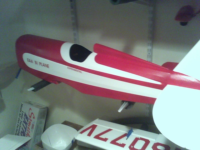

Does anyone have any information on their build of the BalsaUSA Eaa bipe? I am in the fuselage stage; planning on a G26 on the nose.... would like to take advantage of other people's experience.
Thanks.
Thanks.
Posts: 559
From: mason,
OH
That is a good looking Eaa bipe..... my friend flew it with a 1.20 so I did some measuring and the firewall size was custom made for the G26; I needed an airframe for a smaller gas project so I made the jump; the numbers all come out ok if I move equipment aft..... we will see. I strenghtened and pinned the firewall. Moving along slowly but alittle every week.....

Great to hear another Eaa bipe will be started; I have made a few modifications already...... I am using a G26 so I had to shorten the nose alittle and strengthen the firewall. Now I have to setup the throttle linkage. I will try to download pics if anyone is interested..... I have also seen the Eaa bipe at the eaa museum. I will probably do mine in Black/red/white scheme; i got this pic from a flyer in England....
What engine do you plan to use?

For some reason, the pics are not downloading......
As for the fiberglass cowl, I will be using one from Stans but want to use a cowl with wider cheeks.... I am still working on which one to use; there may be a way to modify the original abit.

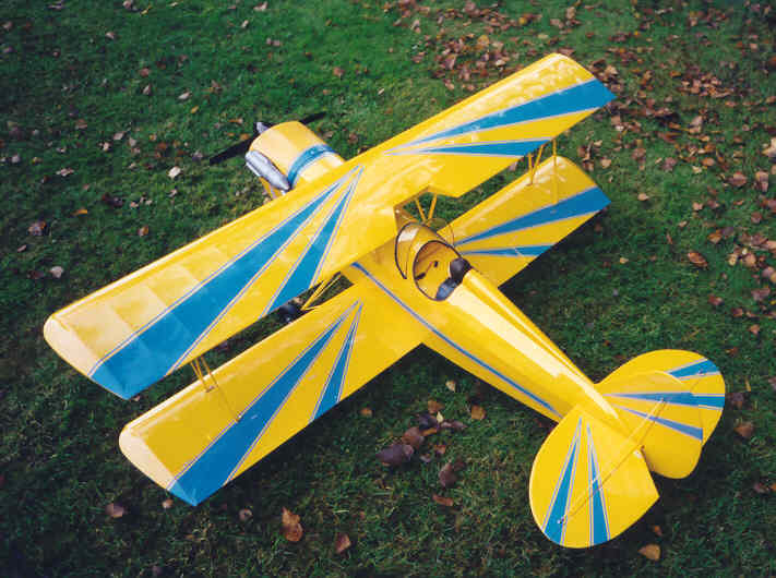

I guess they did download; the gentleman on the right is a big electric flyer; he flys larger scale planes with big electric setups. I put this pic in because it was done in the Eaa scheme.

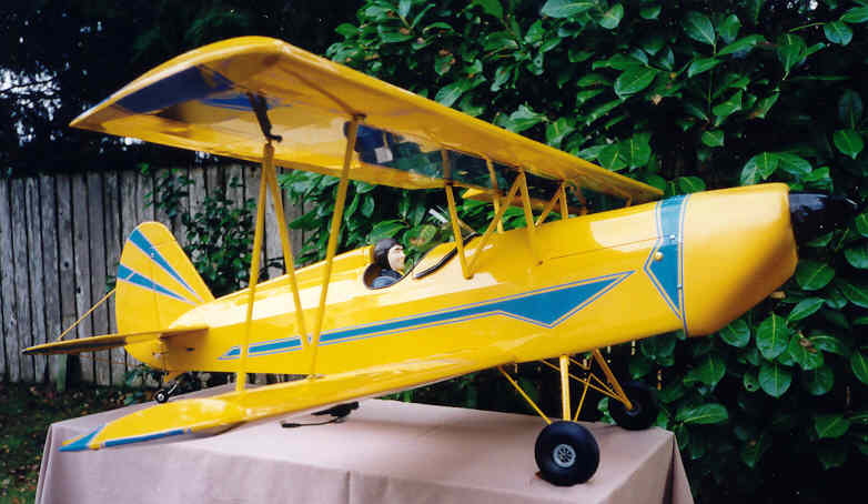

I am finally closing in on the completion of my EAA Bipe. Did the painting over the weekend. Covering is white solartex from balsa usa with red lustrekote and then clear lustrekote over the whole thing. It's a rough approximation of the paint scheme the full-scale photos above. See workshop photos below. Sorry for the poor quality - I took them with my cellphone.
Does anybody have any suggestions on cool 1/4-scale pilots that might be appropriate for this plane?
