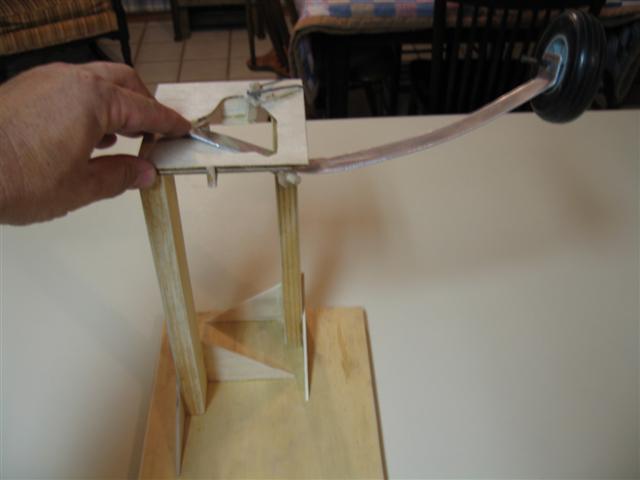

I'm prototyping a set of gear for the Cessna singles. Located a maintenance trainer for the 210 at a local A&P school. This set will be for the older spring steel legs but the tubular steel legs should not be a problem to fit to this mechanism. The plan is to make the legs in molded carbon fiber to take the landing loads, still haven't decided on how to actuate them.
Paul

Here's a short video of the motion.
http://www.youtube.com/watch?v=DmX1-d7_6TQ
Paul

Paul, pretty cool idea. I wish i could have seen it about a week ago before i put my gear in my TF 172

Thx, I haven't scaled anything yet but I'll work on it and post more photos when I get it all working.
Paul

That is clever.. I thought the full size one dropped down to the center and then swung up and aft, and I was trying to recreate that motion...but yours is much simpler and in simplicity, there is elegance!

Actually the 45degree pivot is the way it was done on the real thing... I located a maintenance trainer and took a few photos of how this thing works. I know about the legs swinging down at first then retracting slowly but I suspect that is because of the the hydralic motor they use.
Paul

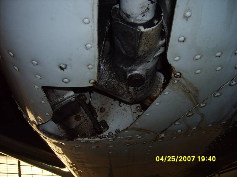

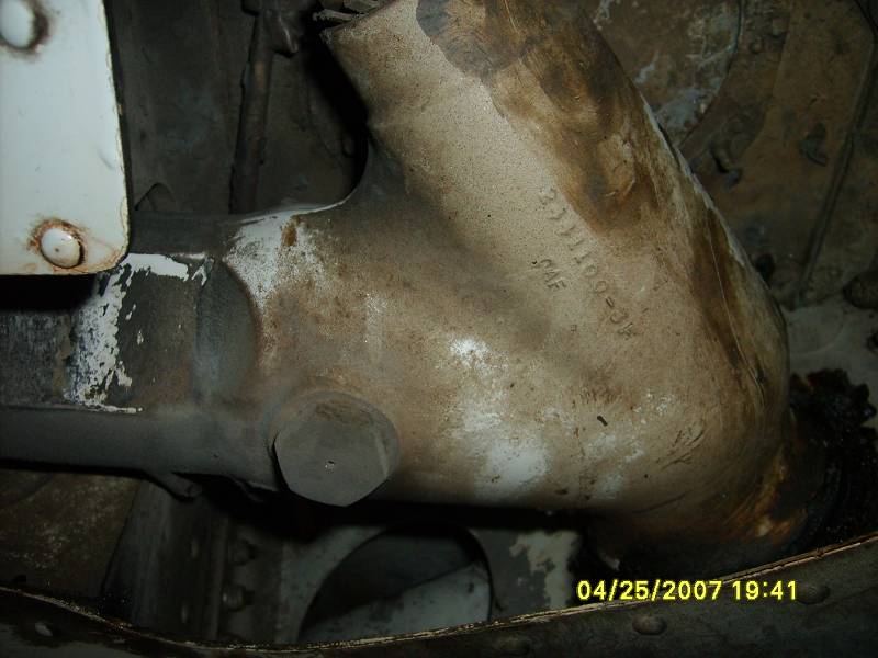

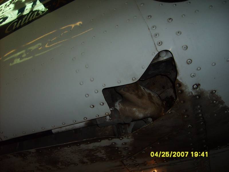

I finally got a chance to take a video of the 172 RG Gear today, the later 210's used this Tubular gear as opposed to the Flat Spring steel gear in the earlierones..
Here are some detail pics and a video link,
http://www.rcuvideos.com/item/MTSQH85G4SNV95V8
Sorry it took so long but we just brought it back in for it's 100 hour
The tubular gear started in 1976 If I believe, and it originally had gear doors.
about 1980 the doors were eliminated since they were sequenced hydraulically and could get out of sequence with the expected expensive results!!!!!
so a kit was developed to retrofil the non gear door setup onto older Tubular gear 210's.
Also the 337's definitely did not have tubular gear in their entire life span.

Thanks for the video. I never knew the sequence was so "simple". I always imagined it was a two step process.
Robart should pay PS2727 some bucks and run with his design ...they would make a fortune re-gearing all those Top Flight Cessna 182's out there (mine included!)

US185, thanks for those photos, I wondered what the tubular legs mounted to. Those show it very well.
