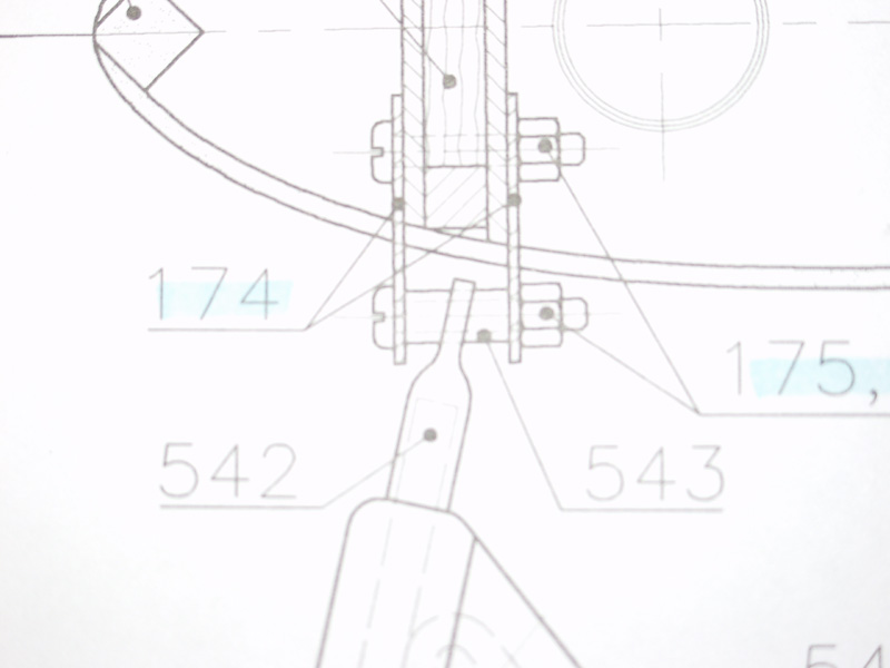

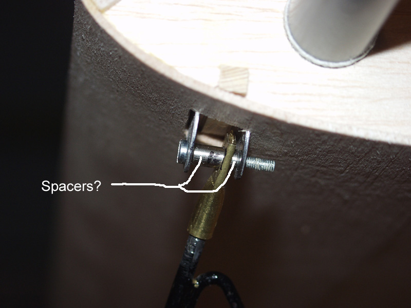

Steve,
I'm getting ready to set the incidence on the upper wing center section. On the quarter scale the attachment points to the upper section are bonded to the bent wire strut. I thinking of using JB Weld. Assuming the third scale is the same, what did you use?
Chuck

I used the same stuff JB Weld. Just remember to rough up the ends of the music wire where the ends go. This gives it a good "bite" I used my dremel tool with a fiber wheel on it and made several shallow cuts around the wire, kind of like the groves in a piston for the rings .

Steve,
Getting the angles right is going to be fun, so I have discovered now that I'm into it. Another question is, what keeps the center section from shifting around on the bushing? I seems to me that once you know where the wing is going to sit, spacers would be in order. See the attached picture.
Chuck

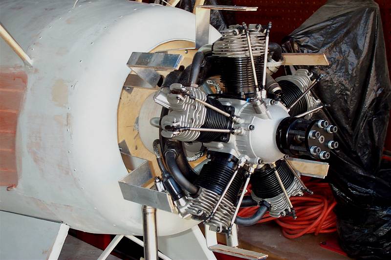

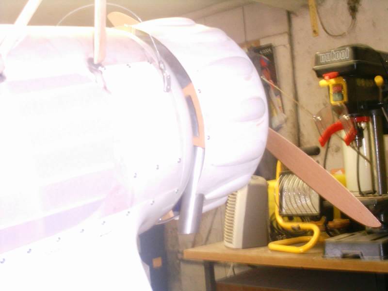

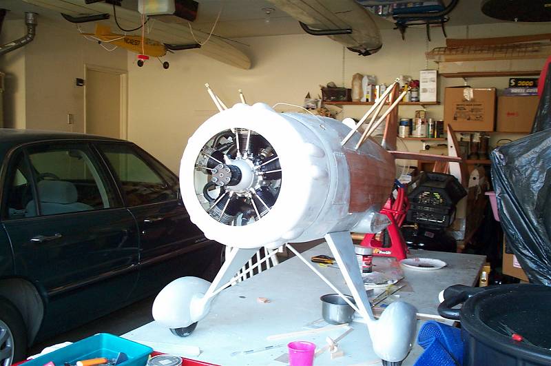

Here are a couple of pics on how I mounted my cowl. You may have other ideas as you may not be useing the same type engine. I'm sure that others will come up with there own ideas.

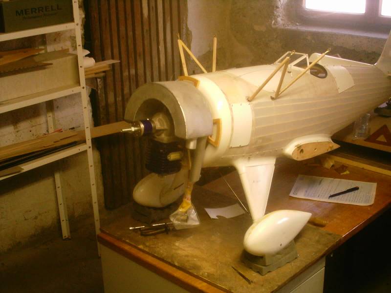

In case any of you are interested, I got to ride in a real Waco on Friday on the island of Kauai. The plane was built in 2002 by http://www.wacoclassic.com/ and the rides are offered through http://www.tropicalbiplanes.com/ . The engine is a Jacobs that was built in the 1940’s. The sight out the front of the plane is quite neat, once the tail lifts off, prior to that you can’t see anything but sky. Obviously, the pilot can see more as he turns from side to side since he his further back. Anyway, it was a great experience. I posted a bunch of pictures at http://www.lundyphotos.com/Waco%20Fl...Web/index.html that show a few detail shots around the airplane.
#63
Joined: Oct 2005
Posts: 17
From: Rotterdam, NETHERLANDS
I go take a look right now!
Two months later than I expected, I just pinpushed the side view drawing of the 1/4 scale Barth Waco on the wall. I'm really exited start building this plane. Start uploading photo's soon.
Grtz,
Gerry
Grtz,
Gerry

#67

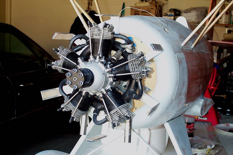

ZDZ 80 RV. An 80 ccm, 8,2 HP gas engine. I have tried to calculate a moki radial, but it wont go under cowl. So it's a one cyl. engine, but it does a very good job. The exhaust was a tricky business, but at end, it came uot very well. Oh there is also a smoke system installed and flight comp. DPSI-TWIN. There IS a plenty of space to fill on board the WACO.
#68
Oh and one more thing Gerry... The spec says that upper wing can be freely adjustable within range of 0... -2,5° ang. I have mounted the upper wing with -1,5°angle and it does good job even at critical speeds (I'm guessing that for such a plane scale Reynolds is most forgiving
). The angle for tail rudder should be ca. +2,0° ang. (nose up). Of course, if one should need another flying characteristics, there are other angles for use..
Marko
). The angle for tail rudder should be ca. +2,0° ang. (nose up). Of course, if one should need another flying characteristics, there are other angles for use..Marko

Last Friday I visited, just like every year, Intermodelbau in Dortmund, Europe’s biggest modellers exhibition. Almost all R/C manufacturers show there newest items and during the exhibition a lot off stuff is being sold much cheaper. Oracover for example, the average price/meter in the Netherlands is about 9 euro. In Dortmund it’s 4,75 euro. So I bought 15 mtr of white Oratex for the Waco for about 60 euro. The red striping is going to be painted (sprayed) on the plane. Two component paint works very well on Oratex and it’s resistant to almost any fuel.
After visiting the exhibition, there’s more doubt as far as the motor concerns. My mind really isn’t made up yet. Haven’t looked any 5 cyl. radial yet, because I thought they are above my budget, but after the exhibition I think it must be possible. The Waco is an important project for me, so I’m willing to save some extra money for a motor that really puts a smile on my face. A real challenge for me, because I have no experience with that kind of powerplants. There are two demands in which I won’t compromise, it must fit under the cowl and it has to be as powerful as the plane’s construction can handle (there’s, even for a scale plane, no such thing as overpowered). Other important issue is an acceptable vibration level.
Then there’s also a “nice to have listâ€, number 1 item on that list is a two or more cylinder power source. Do you (or anyone else), assuming price doesn’t matter, have any suggestions meeting the above requirements?
I also like to install a smoke system, but again, I’m a first timer in choosing and installing a smoke system. Any suggestions or tips and hints are really welcome here.

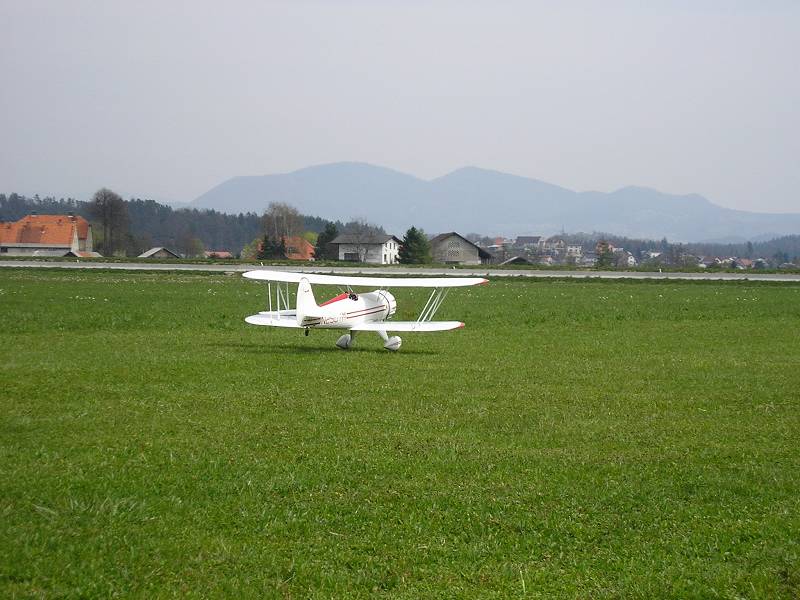

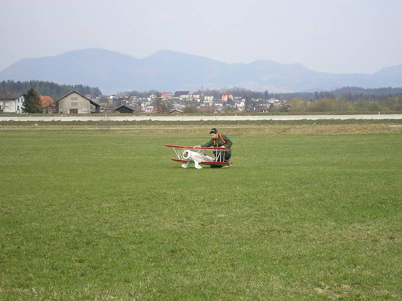

#72

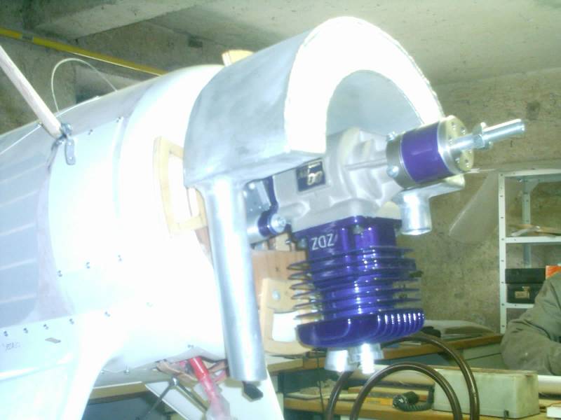

O.K. guys... some answers:
1. Engine is mounted directly on firewall. I have tried to use some compensators, but from my experience direct mounting can work out better with compact fuselage construction (and WACO is one of them). Of course, firewall is modified (greater thickness) with another wooden plate (original seems to fragile to me), then both sides are laminated with thin glass wool and epoxy. I have not chosen hydromount, because i've needed some extra space for ignition chip, ignition battery and a smoke system pump. My theory is that everything that belongs to engine electric support, should stay far ahead from receavers, aerials, ...
2. Oratex will do a great job. I have used transparent one and then painted with 2-K lack.
3. Radial engine was my wish too
. But i couldn't find any suitable petrol engine that would go under cowl. Recently I've seen a new MOKI 150 ccm radial and perhaps this model would suit everyone needs. Other possibility was to use a classic methanol radial engine, but since i'm more petrol lover, i have abandoned the idea. If you can mount a radial, the plane would look as good as real one
. Other possibility is use of boxer engine. But with need of a HP in reserve, engine should have at least 7-8 HP, that means ca. 70-80 ccm boxer. Boxer works fine, but i didn't want to cut sides of my cowl to make some room for spark plugs. One cyl. engine was a good compromise to me.
4. For smoke system, i've chosen a Slimline Show Time Pro. The battery is integrated and a pump el. motor is speed regulated. But an ordinary pump will do a job just fine. My oil tank has 0,5 l vol. I would suggest, that tail surfases that are open (tail wheel section, rudder/tail wings joint section, ....) should be protected with thin layer of transparent lack or better with epoxy. Oil fumes from smoker are condensing quickly and they can damage wooden sections on tail.
5. Flight computer.... sounds so Sci-fi heh ... Purpose was to have a central operating system for independed servo supply, independed servo control (pulse modulation check), double battery supply and duble receiver control. I have always wanted to eliminate a possible errors from installed equipement, so with this set of control there is only one mistakable factor. You've got it right. Me!!!
6. As for installed equipement:
Servos: Ailerons: 2 x Hitec 5745MG digital (yes i know, too strong [>:])
Rudder: 1 x Hitec 5645MG digital, 1 x Hitec HS 925MG for tail wheel
Tail wings: 2 x Hitec 5645MG digital
Throttle and Kill switch: 1 x Hitec HS 925MG each
CPU: Emcotec DPSI-TWIN, DPSI-ICE
Power supply: 2 x Longgo LiPo 3300 mAh Safe
Recievers: 2 x Multiplex RX-9 Synth DS IPD
7. Reynolds... theory from my university: "The Reynolds number is the ratio of inertial forces to viscous forces and is used for determining whether a flow will be laminar or turbulent. It is the most important dimensionless number in fluid dynamics and provides a criterion for determining dynamic similitude. When two similar objects in perhaps different fluids with possibly different flowrates have similar fluid flow around them, they are said to be dynamically similar...."
But there is one little problem. Determination of number is more complex for outer flow (easy for tube flow theory) theory. And aircraft is an object of outer flow theory. Since a normal Re calculation depends strictly from fluid velocity (aircraft section speed), characteristic dimension, fluid density and dynamic fluid viscosity, calculation should be easy for elementary objects; not aircraft !!! Normaly we use also Euler number for macroscopic calculation (plus Pr number in model scaling), sufficient calculation comes across only with use of microscopic observation of laminar flow (with Navier-Stokes) or better observation of laminar/turbulent border.
All that is just fine when one calculates a stationary flow status. As for aircraft or better aerobatic aircraft models (NON stationary flow status), we use Re simply to determine approx. flying characteristics of an model plane from his big brother. That all depends from a aircraft scale (normally bigger is better; mostly but not always) and of course from right wing profile construction. Therefore the similarity with real aircraft can be achieved even at totaly different Re numbers, mostly with use of right wing profile.
There is a very good model aircraft aerodynamic theory in book Aerodynamik des Flugzeugs (Amazon, ...).

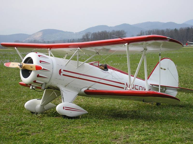

8. Flying with ZDZ80 came out just fine. It has some HP in reserve (so i used 24-12 prop for low turn speeds, but better prop efficiency). Take off is very smooth, due to a very efficient rudder. Landings are not so tricky, but i had a few "bums-a-daisy" at first[:'(]. Plane is very inert and main springs are doing their job...
You will find some pictures and a first flying movies at http://s54.yousendit.com/d.aspx?id=3...N1N52Q3K5HLWV5 (max. 25 downloads)
sorry, some pics are bad...
I hope that you guys will be satisfied with model as i am.
Marko
