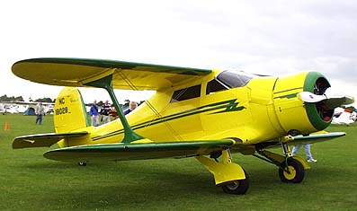

The plane you have is from the RCM Magazine. I have one that was cut from Sid Morgan plans (same plane and size but different designer). I got an email from a guy who built your plane but did not use the foam wings. He said the plane flew well with an OS 91 four stroke. Unfortunately, he had a flame out and was not able to make it back to the field. The damage is reparable.
I think my plane will come in at about 12-14 lbs finished. This will be a bout 28-30 oz/sq ft wing loading so it will definately not be a floater. The full scale planes were pretty hot (fast) and all the info I have gathered on the models says that they are also fast and tend to fall out of the sky on flame out.
I plan to go with at least a 1.20 four stroke as I have one in my Top Flite Cessna and it is pretty reliable.
The picture shows the paint scheme I plan to use. It is a D17 and mine is a G17. There were only 20 G17 models built so the color choice from full scales in very limited.

Very interesting that you should picture the particular Staggerwing. I have a very intimate knowledge of it, as I restored the aircraft from a basket case about 1980-1983. The pictured airplane, NC 18028, serial 147, was the first production D-17S.........I SAID D-17S...........to have the P&W 985 installed.
The airplane is now flying in England, and I am curious as to where you got the photo. It is finished in butyrate dope. I forget the yellow, but the green was an Imron color...bright green, and it has a gold border.
Nick Ziroli is now in the process of designing a D-17S, 1/4 scale, to be flown at next years top gun. I have been giving him info regarding the Stag. I own Doc's Aero Service, Inc. Sandwich IL, and we specialize in the Beech Stag. You may want to wait for his plans to come out.

Other than the cowling, windshield, vertical fin, and gear doors, the paint scheme is pretty well standard for the Stag. The factory offered paint options to the customers own design, some of which were really wild. If you are building a "G" model then obviously you would use the G scheme, basic difference on the cowl. The stylized bird stripe on the fuse was essentially the same as the D except the body of the "bird" was a bit longer. If you are building the D model, then for contest purposes you would want to stick with the D scheme on the cowl.
The plane you originally pictured was my personal airplane. It was built in June of 1936 as a civillian D-17S, had a 3 digit serial number (147) as opposed to the 4 digit serial numbers (ie 6897) which I also owned and it built in 1942. A minor difference in the civilian vs military D-17S was the side windows which were 1" narrower on the civilian models, not readilly discernable. Basically, there are not enough people out there to really know the details and differences of the Staggerwing, so most of the "critics" are just that. Wylams master plans are not entirely accurate either, but a very good start for detail, etc.

You are listed as one of the owners and restorers of the one in the photo. Check out the web site at:
http://fp.staggerwing.f9.co.uk
There are a bunch of photos of this plane on this web site.
Thanks for all the info and at a closer look, there are gold stripes that border the green.
