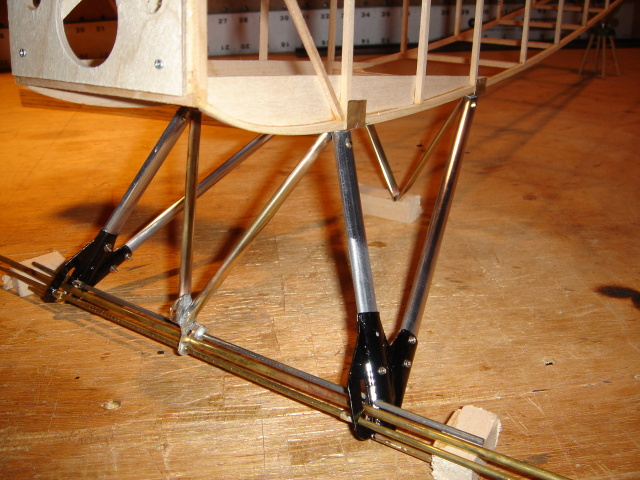

Man, them is some crazy looking struts on the original Pfalz! Until I started following your build I hadn't realized how really different the Pfalz was from the Fokker. I had just sort of assumed that the Pfalz was a "cheap knock-off" of the Fokker but it has its own unique consturction and look. Given the 1001 Fokker EIII models that exist in the world, I envy you your Pfalz.
BTW, I'm not sure if the steamlined aluminum tube alone will be strong enough. Two recommendations from other people here on RCU are 1) fill the tubing with epoxy and/or 2) slip in a piece of standard music wire. I can hardly wait to see the finished gear!!!

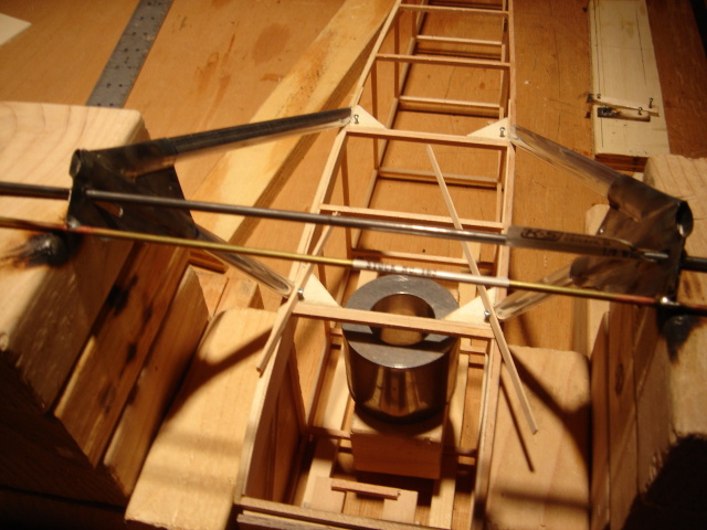

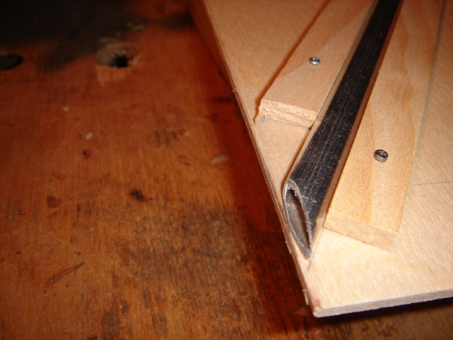

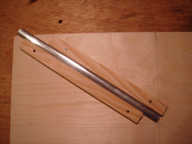

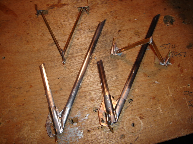

I cut the aluminum struts, which of course I made way more complicated than probably needed to be. I had previously made dummy struts out of basswood, which were cut to a calculated length, although the exact angle of the cut at the fuselage end was done ad-hoc fashion. I eventually theorized that I could lay out a planform of the strut on a piece of plywood, drawn in it's normal plane, and then could cut the end of the struts by angling the cutting tool appropriately. I made an angle alignment tool from scrap wood, based on the angle of the strut to the fuse seen on the front view of the undercarriage.
I want to test the idea that the Aluminum is strong enough without reinforcement. Maybe it will work IF it only is stressed in compression (or tension). I hope to make the entire affair rigid enough, that any forces will be absorebed entirely in the elastic band that will be bound around the ends of the axle.

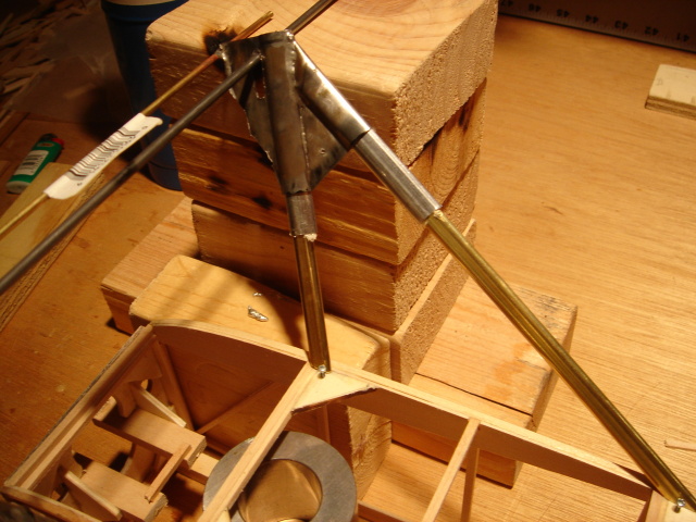

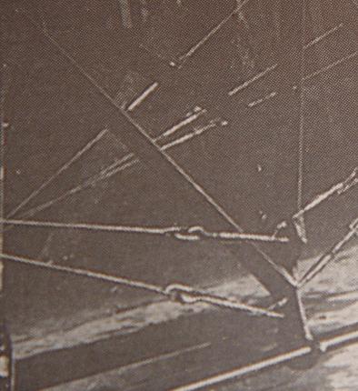

THe next part has to do with the attachment of the strut to the fuse. The b&w picture from Datafile 59 seems to show that strut fitting over some type of attachment bracket with a bolt through it. I want to create a brass fitting that each Al leg will fit over, such that the Al leg will bolt over it. It should be a snug fit....I think it's very important that this whole assembly does not have a lot of slop in the fit.
I found that size of brass tube that I could smash down which would fit snuggly into the streamlined AL stock. Now it's not easy to smash down brass tube. I put the tube between two piece of hardwood, flanked by spruce strips the thickness of which should limit the extent of the smashing , I then tried to squeeze with the clamps, and the bench vise, and even tried driving the truck on top of it. Eventually, I resorted to good-ol-fashion pounding with a hammer-thingy.
I cut the end of the brass aligned with the fuselage using the same jig as for the AL struts.
I turned the fuse upside down and used a bunch of blocks to align everything, basically trying to ensure the alignment of the axle perpendicular to the fuse. THen I took a spare piece of brass rod and soldered it across the front of the tin v- brackets.
In the end, I have effectively made a second set of "inner-struts" of brass,. which are fit into scraps of streamline AL which are then fit into the tin v- bracket .

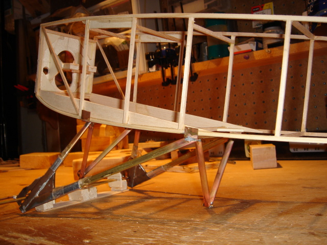

It has turned out to be quite an ordeal. But now the whole thing is kind of held together with a brass rod across it to hold the alignment. So the whole thing is move to a scap board, with the dimensions of the bottom of the fuse drawn on it. It is soldered to a pair of brass strips which are sized to fit across the bottom of the fuse. Each pair of legs has another v-strut in the center. In the rear, the v-strut holds a bell-crank for the wing warping. In the front, the strut holds the center of the axle and spreader bars. These struts I will fabricate and solder to these brass strips which the fake brass struts are now soldered to. Once that is done, the innermost portion of the brass strips will be removed. All but approx 3/8 inch of the fake brass struts will be removed, leaiving the portion to which the AL legs will be bolted.

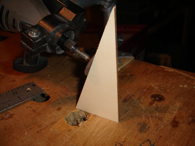

Now I am stuck trying to figure out how to make this part...It will not be easy to make this front-center strut, and to get the fore and aft spreader bars to align with it..

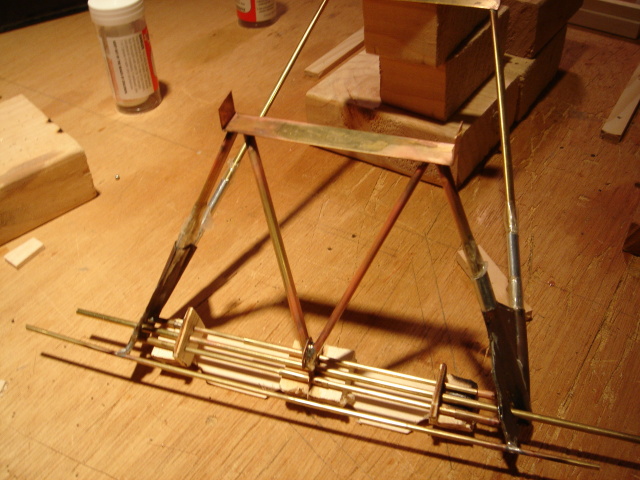

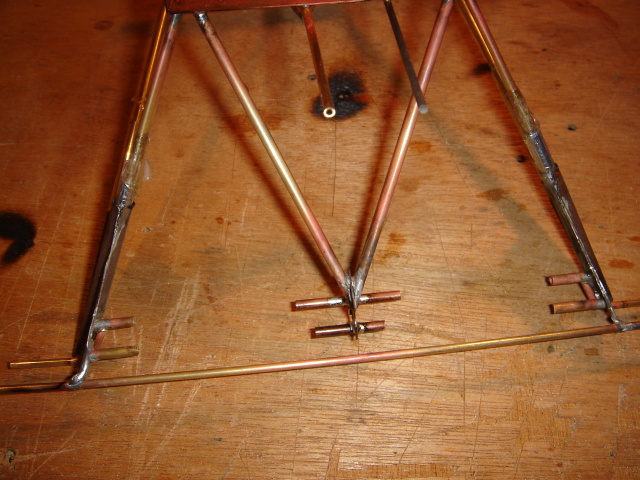

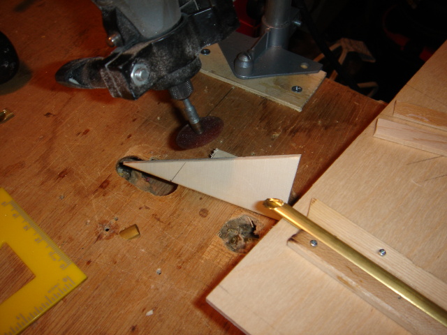

Here I making the metal piece that sits between the front v-struts...did not know how I could possibly get the spreader bars and axle lines up, then I rememberd I had this electronic prototyping board which just happened to give me the right spacing. I use the perf-board also to drill out some plywood pieces...which I used to make a jig. With everything held in place lined up, I can solder the spreader bars in place.
The spreader bars are 3/32 brass. The ends are a short section of 1/8 brass, cut sort of angled to fit against the inside of the tin bracket. The reason for using separete ends is because I know the real truth... that NOTHING can be measured perfectly, there is no way to cut exactly the right length of tube .

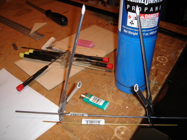

Next job is the front v-strut. Like the main strut, it is angled in two dimensions. To cut the angles at each end, I draw a "normalized" view of it looking from the side, onto a piece of plywood that becomes the holding fixture. The height of the side view is the hypoteneuse of the triangle that the strut makes from the fuse bottom, looking at the front view. The rotary tool is then angled appropriately using a plywood triangle-template, produced from the dimension of the front view. Actually, I did not have good dimensional info for these struts, so took measurements the best I could, of the space the pylon would occupy, and also used some small sticks that I cut to get an estimate of the final length of the struts.
I propped up one strut with a bunch of blocks, soldered the bottom first, turned it over, did the top joint. Ditto for the second strut.

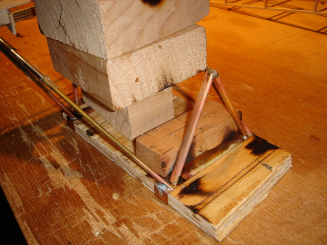

THe rear strut supports the wing-warping wires bell-crank assembly. I have the two struts attached to a short length of brass tube, which is embedded into the plywood fixture and the struts are soldered to it as seen in the picture. This strut was so easy, less then 30 minutes to do, very easy because all the dimensions are true in one plane.

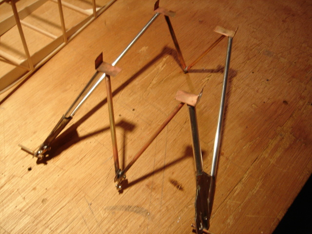

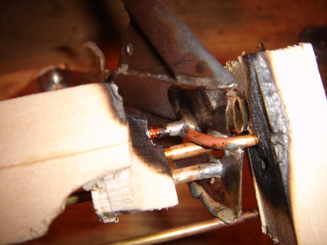

One last bit that had to be soldered into place... is the part where the bungee wraps around under the axle on each side. Based on looking at photos in the Datafile with a magnifying glass.... I believe that it is actually the rear spreader bar, which is supposed to bend around underneath the struts on each side. However, isntead of trying to bend the rear spreader bar and struggle with aligning it, I chose to isntall the bungee wrap posts as separte pieces of brass tube.
FInally, everything is cut apart! which might seem counter-productive.

It looks like I cut the spreader bars out... but in reality, those were not the actual spreader bars, they were merely drill guides. Those tubes were 1 size over. The actual spreader bars will fit through these short lengths of tube that I have left remaining on each bracket, and which I have now drilled through. I did not want to permanently solder the spreader bars in place, if I can avoid it. If I could tap them out, and screw them into the final assembly, then I could more easily reuse the brackets if the need should arise.

You've done an amazing job at replicating this very funky undercarriage! It's a rare modeler who goes beyond simply strapping some music wire to the bottom on his WWI model.
I think part of the apprehension about doing this type of work is having to work with unfamiliar materials (at least from most modelers). Most of us feel a lot more comfortable with balsa and CA than we do with metal and solder.

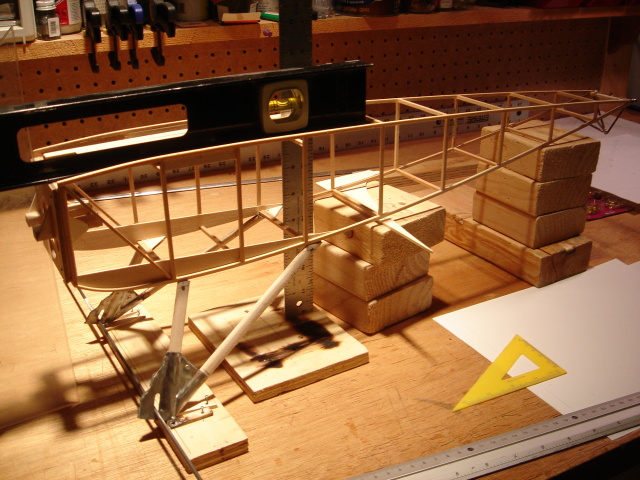

After reassembling everything one last time, check to see that everything lines up with the fuse. last chance to adjust the struts in the brackets before drilling the holes for the fasteners. WIth the position of the struts in the brackets marked with a marker. This was very awkward because it is necessary to have everything assembled together, in order to drill these holes through the struts. Finally after some more hacking and grinding the strut brackets are in their final form.
