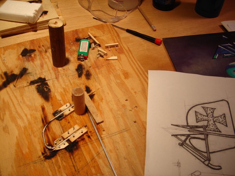

New scratch build... when the thing is finally standing up off the building board., that is some kind of milestone!

I put in a few more cross pieces and removed from the board - but no other progress.... my whole evening getting the other heaps ready to go to the field tomorrow.
I used the dimensions and three views from the Winsock book and try to design for roughly 1/8 scale. No other plans. Unfortunately, there is very little dimensional data to be had, apart from length and wingspan. There are three views in the book @ 1/72 scale but you have to be very careful taking measurements from these drawings.
It's not scale construction anyway, because the top forward decking and cowl will be one piece for motor and battery access. I did this on a previous model and find it to be a useful feature.

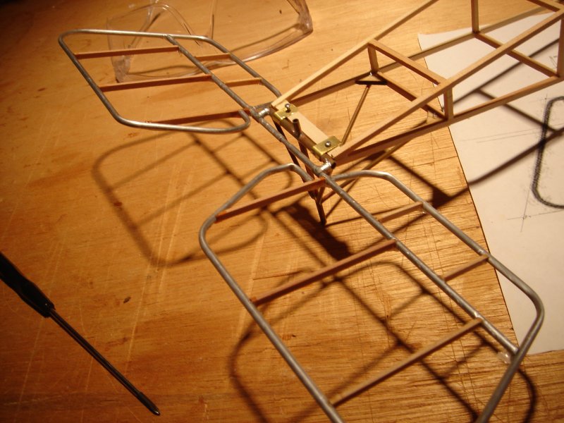

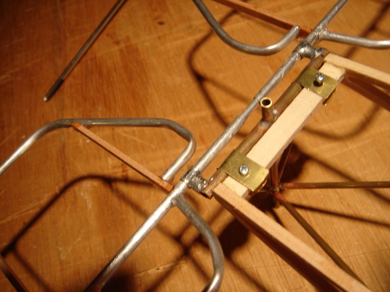

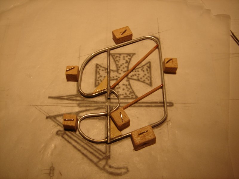

Not sure about the markings Chevelle....this is going to be, uh, merely the .... prototype! Probably will be stand way off scale at best. Will be trying some new (for me) techniques on this design - particularly I hope that the full-flying tail will work dependably. I'll be glad if the darn thing flies at all.
Anyway, made some aluminum bendy-things today....don't look at them tooo closely!

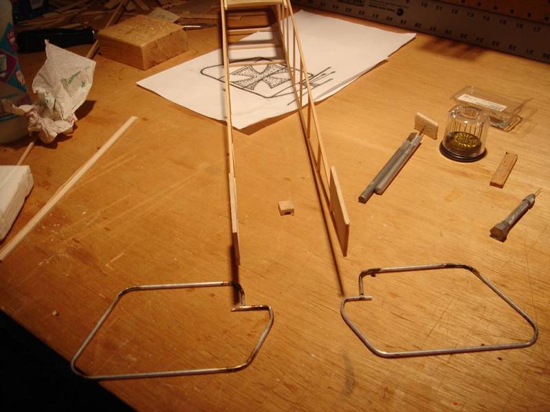

There is not a straight line on this fuselage plan....

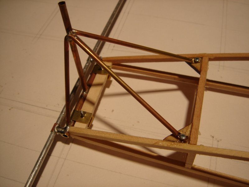

I didn't have a clear photograph or drawing of the skid-support/ rudder-hinge pylon contraption. My main concern was the that the rudder (hinge points) would end up aligned to each other, absolutely vertical, aligned to the fuse. THat is a lot of aligning. So my idea, to have the upper and lower rudder hinge points start out as a single tube which is put through the horizontal tube and goes down ~1/2inch into a hole drilled with the Dremel-drill press into the wood fixture. Then the pylon struts are soldered on. The pylon supports are two pieces, i.e. on each side the front and rear strut is a single bent piece. WHile the thing is still jigged up, the hinge tubes for the stabilizer are soldered on and the alignment is ensured by putting the tube through both hinges while they are soldered. Finally, the golden moment, it can be bolted onto the fuse with just a little bit of fuss to get the front struts aligned to the fuse, and using the wood block to help with alignment.

After about a pound of solder in the whole thing... at least it all seems to have come out pretty square -

Now for some real fun...epoxy together the all-seeing, all-knowing, all-flying elevator. I just hope this half-baked idea actually works....
The shapes of the elevators didn't come out perfect to plan. Note to self... practice bending Aluminum tube.
It's only a prototype. Right!

I squinted at the pictures in Datafile 59 (and 16) and am nearly convinced that the rudder-line is in front of the elevator on the Pfalz-E-type. Unfortunatelly, don't have any clear photos of the tail workings. I did notice how the rear-skid supports on the Fokker Eindecker are angled back - the Pfalz does not seem to do this. It looks to be the same as the MOrane Saulnier design. IMO, FOkker really simplified the geometry of his full-flying-tail monoplane by putting the rudder behind the elevator. On the Pfalz, there is a noticeable cutout in the rudder to allow clearance of the elevator behind the rudder line... but as I discovered building the model, it is a real task to get the shape just right to allow the rudder sufficient movement and to clear the elevator line. (and I certainly don't claim to have a perfect scale-implementation here!)

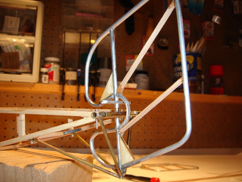

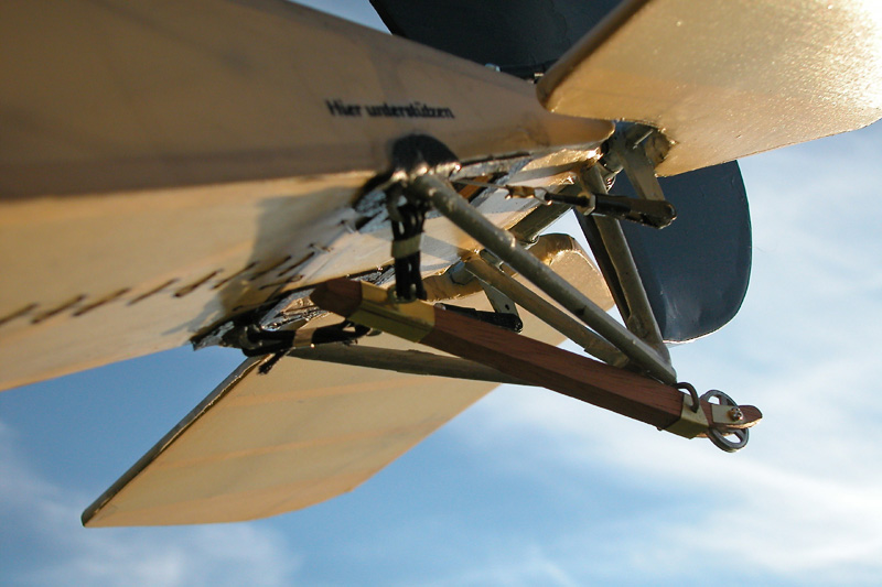

From the too much information department.....
Achim Engels has kindly provided some construction photos from his [link=http://theaerodrome.com/forum/showpost.php?p=230216&postcount=798]Fok. E.III replica[/link] which I found quite interesting and informative. Also, the [link=http://www.collectors-edition.de/QAU/3-930571-70-6_english.htm]Fokker E.III - In Detail [/link] CD clearly shows the tail structure of the Fokker E.III replica at the San Diego Aerospace Museum. Based on the description of the Fok.EIII in the FTS CD - "The fuselage terminates in a simple horizontal tube. This was a feature that Fokker carried over from the French Morane..." my assumption is that the Morane-Saulnier, as well as the Pfalz monoplane, would have had a similar functional arrangement of the tail group.
For those who may not realize it, the Pfalz E type was a licensed clone of the MOrane Saulnier G or H type monoplane. (And the FOkker E type is definately NOT a copy of the M-S monoplane, but the tail structure I think is similar enough that a close inspection does suit my purpose). The design of the Fok.E-type, was supposedly highly influenced by the design of the M-S (but again, was not a copy). The more I think about it, I bet that FOkker took a look at the geometry of the M-S rudder, and realized that if he "reversed" the upper rudder hinge attachment clamp and put the rudder line behind the elevator axis, that it would simplify the rudder construction by eliminating the need to have the awkward cutout to clear the tube of the horizontal stab. Wild speculation of course.
I have of course incorporated this rudder cutout on my Pfalz model. After I soldered together the tail piece and rudder support, I realized I had to make a cut in the center-post of the rudder (refer to attached photo), which I could have avoided if I had designed the upper support as a clamp, such as the full-size. As shown in my earlier post, I installed both top and bottom rudder support at once, by putting the single-piece rudder tube through the horizontal fuse tube and soldered it. This approach due to F.U.D. about how well everything would line up in the end. Also soldered up the rear legs of the pylon strut while everything was still fixtured. Afterward, used rotary tool to cut out the un-wanted parts of the rudder support tube. I think it made the construction relatively simple this way.
In the end, it seems to work OK... is sort of like a door hinge ... the rudder rotates on a smaller diameter tube which is inserted through the bottom to "pin" the rudder into place. I assume that on the full-size, there would not be a cut out in the rudder center post, but can't tell for sure from photos.
I may still need to rework the attachment of the the elevator joiner tube to space it slightly more forward. The attachment of the elevator joiner tube is offset too much rearward, so that the cutout in the rudder barely clears the elevator joiner tube when the rudder is turned. I will only want a very limited control throw of the rudder, but regardless I think some improvement could be made here. ALso, the bottom part of the rudder, forward of the post, bangs into the front pylon strut on each side(refer to attached photo) when the rudder is rotated....again it doesn't matter much because I wouldn't want that much control throw anyway - it just bugs me, and serves to show how complex this whole arrangement really is!
Please excuse the long post... have been obsessing over this thing for quite some time!

Old 10-13-2005 | 11:40 AM
feep's Avatar
Joined: May 2003
Posts: 358
From: pelham, NH
Default RE: morane-eindecker thingy
That post to support the rudder and tail skid is exactly how SR Batteries does it on their 1/4 scale Eindecker. Good work! Have fun with this. Keep your weight down in the rear!
