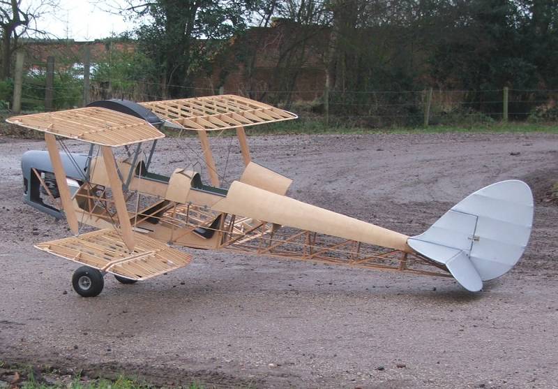

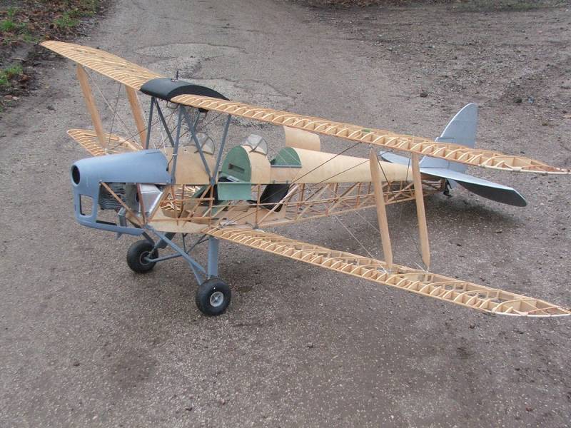

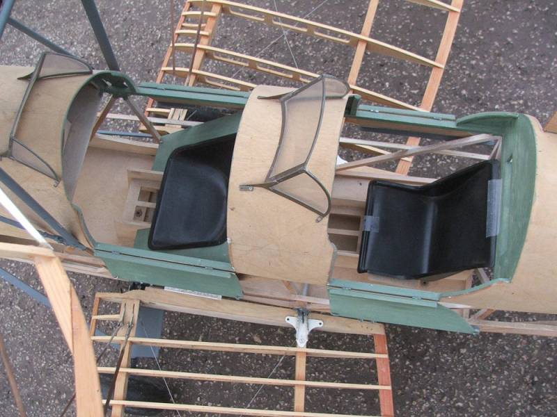

Was going to put this into the original thread Mike started looking for Tiger Moth plans, but I couldn't find it! I suppose it should go in Giant Scale really, but I think it would be lost amongst the ARTF Caps, Yaks and Extras that are so common in there. It aint a dig either, as I have a 30% Cap 232.
Mike was looking for a quarter scaler, but he has been tempted to go up a scale. This is my effort from the Classic Scale plans, of which Mike has obtained one of the last sets of plans. It is a superb plan, every bracket is scale, the scale sized structure is used throughout, internal cross bracing in the wings etc. It was available as a kit, but it cost about a thousand pounds back in the 90's. I think the original came to your Top Gun event a while back too, campaigned by the designer Fred Beard. The rights to the kit went onto another guy who restores real Tigers, so he had the opportunity redraw a couple of inaccuracies that were in the original, as he had full size parts all around! He was going to re kit it but this never happened. I had some parts off him, along with plans and this is the result up to now.
I did take quite a few pics so if you want to see anything inparticular just yell!

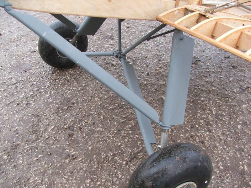

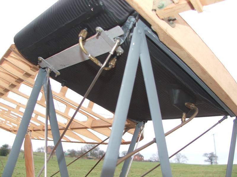

Here are a few more. Span is 111", estimated final weight is to be around the 30lb mark, power is a Z62. All radio is hidden under the scale central control box. The fuel tank is the scale tank. All fittings are from brass sheet, apart from some high stress areas, ie wing spar attachmants etc, are stainless steel, the luggage locker over centre latches work, although the liner for the locker still needs to be made.
Ian.

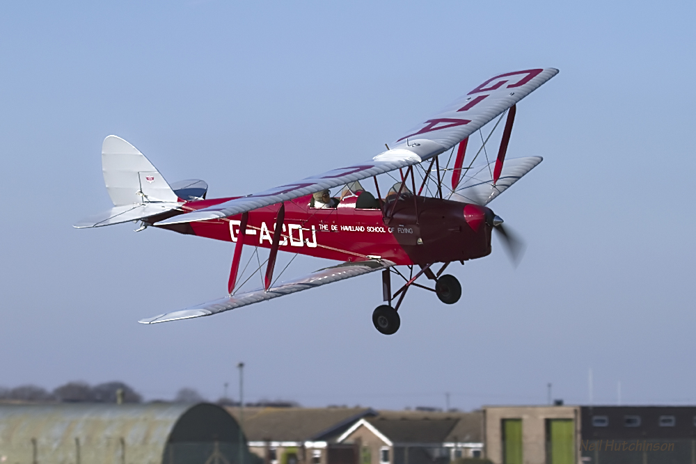

This model is now finished and flying, finished in the G-ACDJ colours I'd originally planned, but stalled on since the demise of the full size and its two occupants, Mike Teather and a family friend. A freind now owns the model and I think its a fitting tribute to a beautiful Tiger and a good man. RIP Mike.
Ian.
The excellent pics are the work of that Neil Hutchinson bloke, all in the camera though, no talent on his part, not a bit, honest!!!
