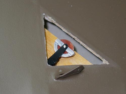

Todd LOL.. you are right! (give that man a certificate!).
Don, you are also right.. you get a certificate too Takes me forever to do simple things! As an example.. here is what I created yesterday.. Of course I had to make two of them but all in all it still took too long.

I remember seeing that bit on the SE5a at Hendon. What are you going to cover it with? The "clear" covering I saw was pretty murky.

Don, yes I'm going to cover it with clear. Since my plane is new its clear. Those old planes did get murkey for sure. I believe it's Plexiglass or a similar product. Kind of like the old rear window I had in my MG's.
