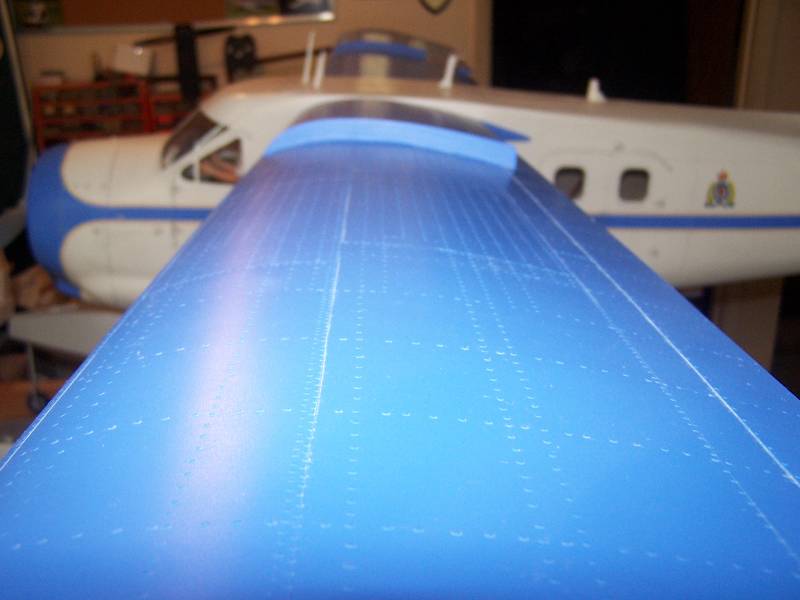

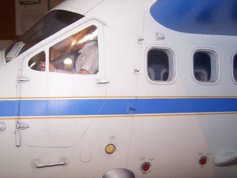

This is a Unionville 8' Otter kit. Only about 80% complete at the present time.

That is one darn fine first attempt! Could you tell us more about how you made the details like the door hinges?

Thanks, the door hinges are made out of plastic "T" stock and shaped to try to match the original. The other half of the hinge is made from a piece of channel plastic that was found in a plastic storage container to hold the paper tag. The pins are just regular pins.

This may be your first attempt at RC scale. but your attention to detail and some of your techniques tell me you have had some connection to scale models before. You do nice work. Would you be willing to offer lessons The only thing that gives the second shot away is the window. Your pilot has a pencil in his pocket and his wrist watch is set at the right time!!! Well, at least in 2 time zones Fess up ,you been building those jobers that sit on a shelf and collect dust for a long time havn't you?

Love the framework around the glazing, and the weathering looks fantastic.

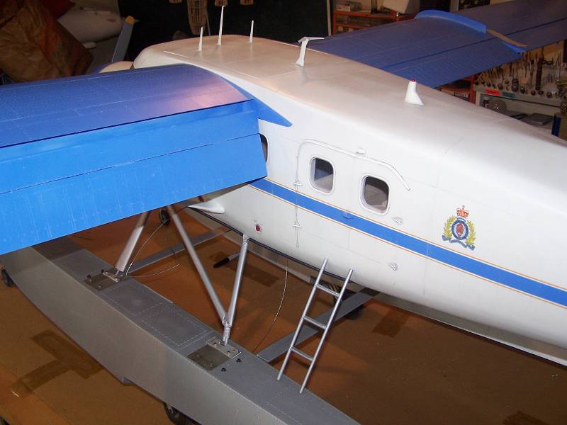

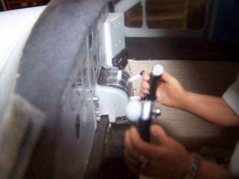

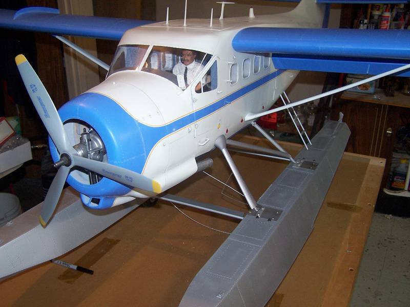

Thanks for the words of encouragement you guys. I am not new to flying model planes but I am new to the scale aspect. Yes I will be putting in a dummy radial. Some other facts include the 21,323 fake rivets on the wing alone, over 50,000 rivets total, the pilot was made from a Ken doll for the arms and hair and some action figure for the head. I could not find a true 1/7 scale pilot that suited. The shirt was made from an old white rag and hot glued together. I have also learned to do some vacuum forming with the air scoops, door trim, window flanges, wheel nests etc. The RCMP crest is hand paited. Here are a few more pics

Some other facts include the 21,323 fake rivets on the wing alone...
I'm not sure which is scarier, that the wing has 21,323 fake rivits -- or that you COUNTED them!!!

Hey! That pilot looks like Dr.Phil.

Oh no, don't tell me that I hate Dr.Phil. I am taking the pilot out tonight and replaceing him with one that loks like Dr. Ruth. At least the Dr. Ruth one will look more Masucline

hey im curious, how did you put in the rivits? I am doing a scale project and right now im just useing servo screws for rivits. Any ideas?

21,323 servo screws is going to amount to a might heavy model! The default technique for doing rivits is to apply small droplets of thinned white glue with a syringe or pin tip.

Excellent model,but i think the otter came with a 9 cyl.1340 radial, not a 1 cyl
