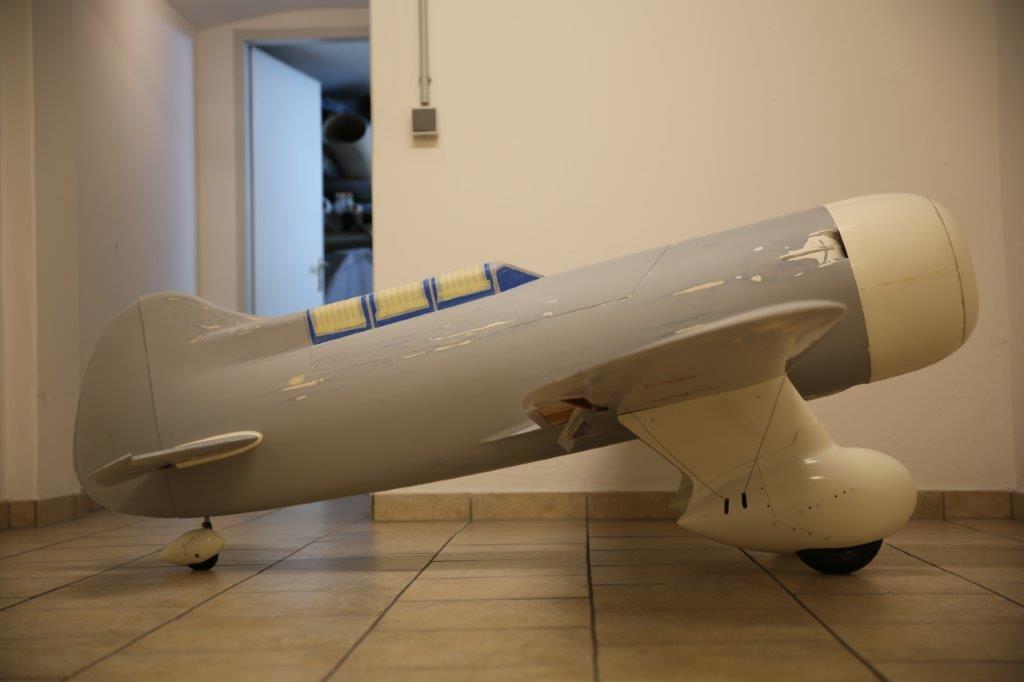

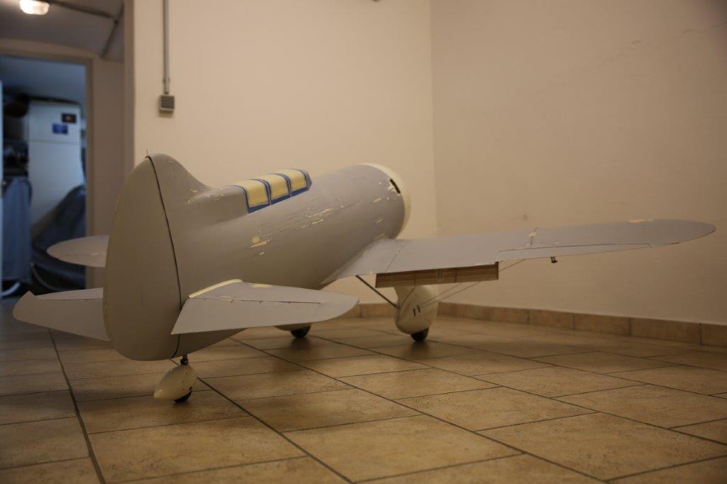

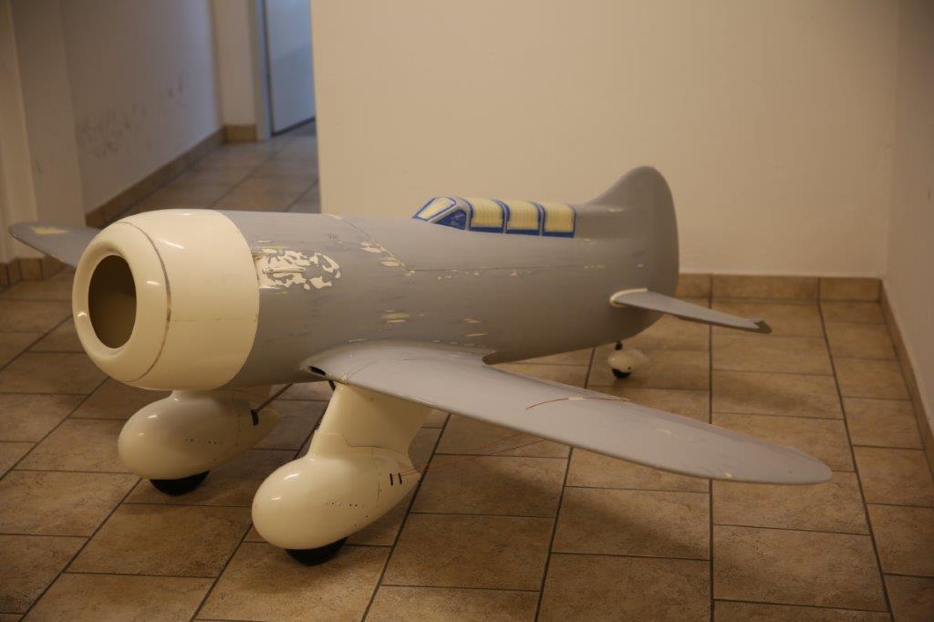

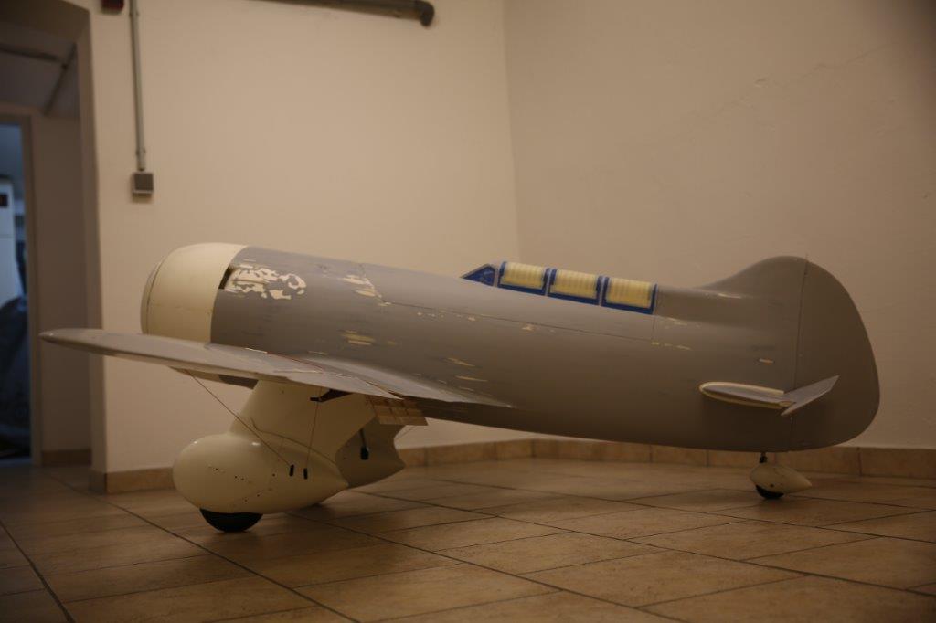

Thumbs up New Paintshop and filler is done
The thing is I fetched the Machine from the first paintshop and chased for a ver good different one with good result. Got the parts back and sanded up to 1000 wet, soon the parts are finished an ca get their final white color. Short before leaving to the paintshop again a final trial assy to see how everything comes together, I'm a bit stunned by thee final size and impression, here some pictures, cheers Matze
