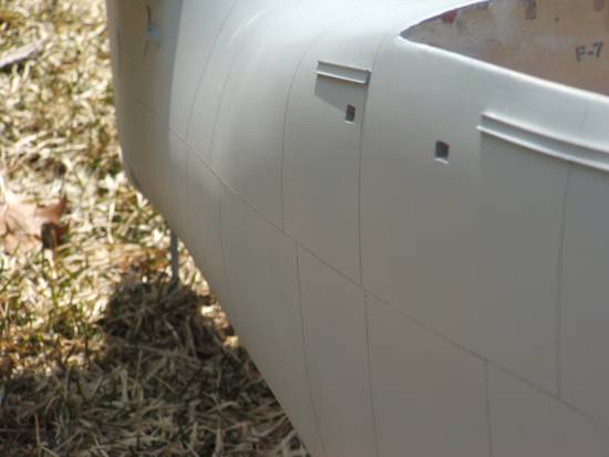

Hi,
I have built a tf-p47 and I have already glassed it and put the primer on it. Now I want to make the panel lines. I am going to use a soft pencil to write the panel lines on it and then i want to put the tape on it. Do you have to put the tape on the panel lines (so the panel lines are under the tape) or next to the panel lines? It's a bit confusing cause i've seen some pictures where peaple put the tape next to the panel lines. But I've also read that you have to put the tape over the panel lines. Can someone tell me where to put the tape?

Here's the way I have done panel lines:
Light coat of primer.
Draw panel lines on surfaces.
Put thin tape exactly where the panel lines are to be placed.
Several more coats of primer.
Pull off tape and you have recessed panel lines.
Than paint your plane as desired.

It depends on the effect you want and how the real plane is build. Panels that butt together will require a very thin tape on the line to creat a "canyon". Panels that overlap will require wide tape against the line to create a "step". In both cases primer may be used to build up the panel. You could also use body putty for the step style.

If you go to the link above it will really help you. Butted panels leave a small crack "canyon" between the panels. The single very thin line of tape placed over the penciled line then primered over until the edge of the tape is level then sanded down until you see the tape will leave a crack or canyon and look as thought two panels are placed against each other.

I think I get it. For the butt jointed panels I have to use tape that is just as thin as the lines from the pencil are. I first thougt that the blue line was the panel line made with the pencil but that is the tape. Cool never knew there is that thin tape. Thanks! I go and try to find that kind of tape

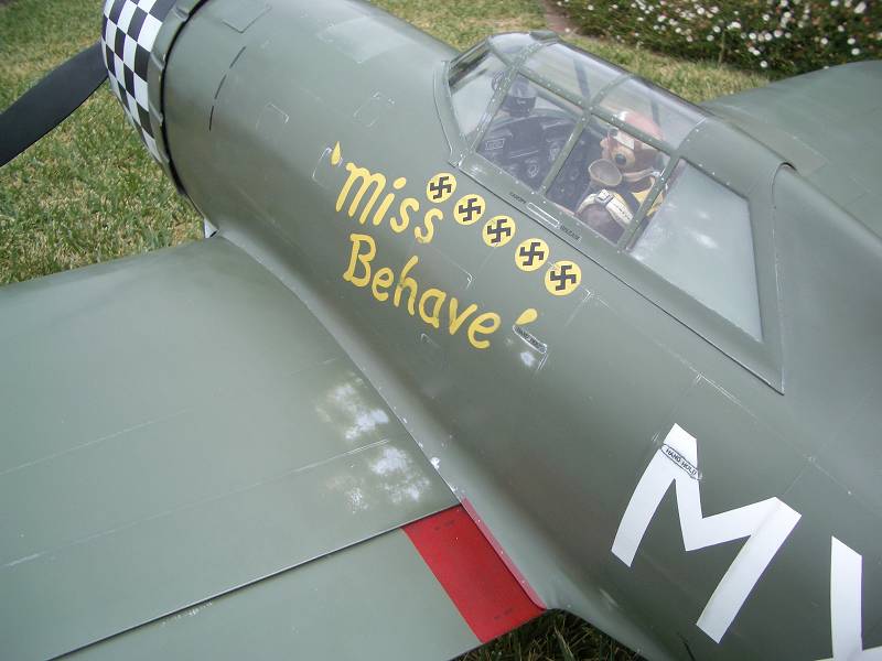

Old 03-23-2007 | 07:29 PM
saramos's Avatar
Joined: Dec 2003
Posts: 3,057
From: Northridge, CA
Default RE: where to put tape for the panel lines

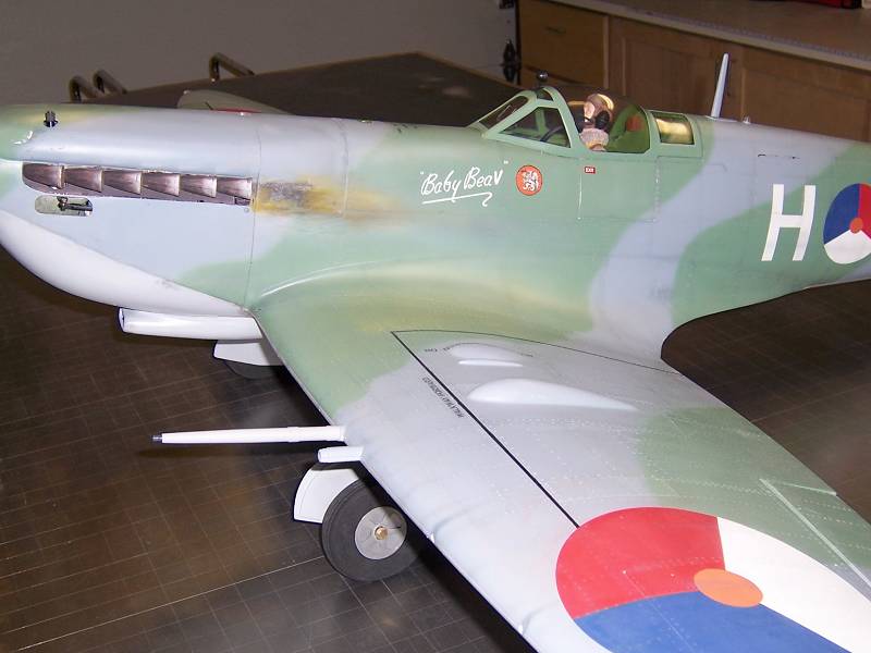

Here's a link to a supplier of tape.
http://www.grafsticktapeandlabel.com/index.htm
I don't know if they deliver to the Netherlands.
I used it for my RNAF Spitfire.
I have a more detailed description in post #24 here
http://www.rcuniverse.com/forum/m_75391/tm.htm
Scott

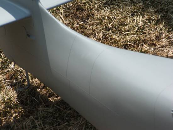

Old 03-24-2007 | 04:37 AM
camdyson's Avatar
Joined: Jul 2005
Posts: 870
From: Bairnsdale, AUSTRALIA
Like this:
Tape, spray filler, then rub back and pull tape off, then prime and paint.

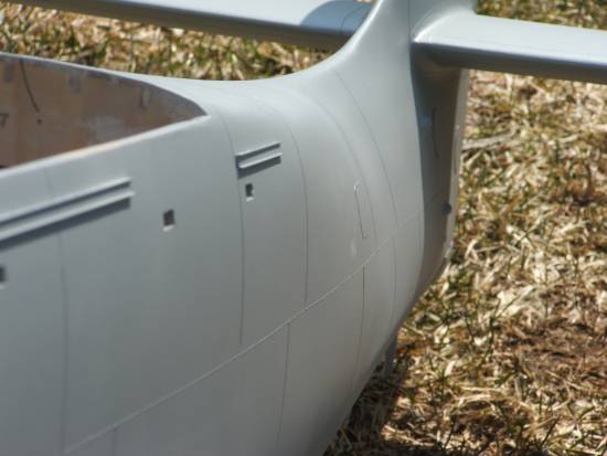

Old 03-24-2007 | 04:41 AM
camdyson's Avatar
Joined: Jul 2005
Posts: 870
End result:

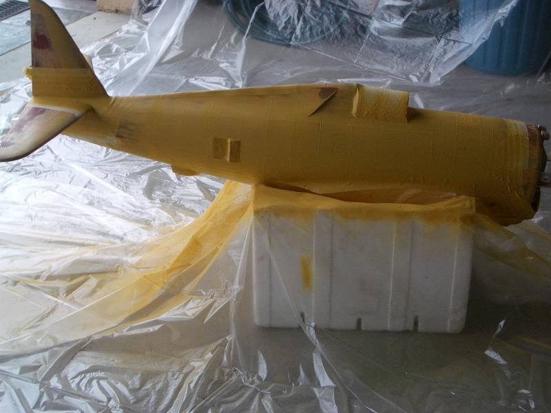

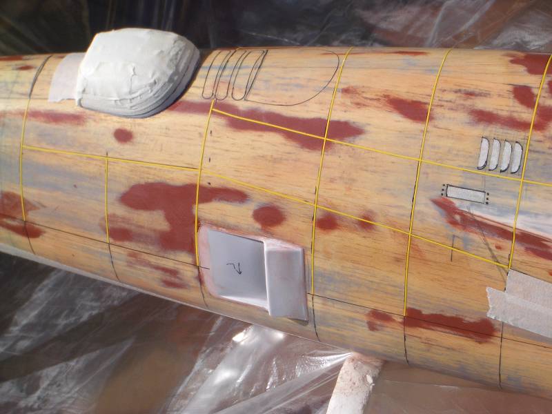

Old 03-25-2007 | 04:13 AM
TomCrump's Avatar
Joined: Apr 2003
Posts: 7,614
Received 5 Likes on 5 Posts
From: Traverse City, MI
For me, buying the tape is the best way. I get mine here: http://www.injectorall.com/draftingtapes.htm
I jusy did the fuselage on my Stuka yesterday, following the method presribed above.

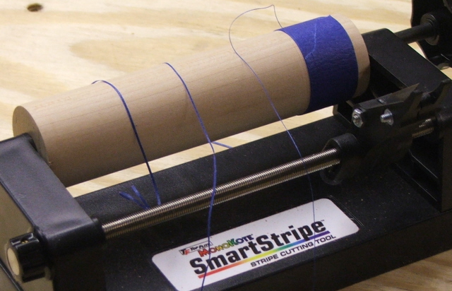

Old 03-25-2007 | 05:42 PM
smcouch77's Avatar
Joined: Oct 2006
Posts: 712
From: Indianapolis, IN
Hi RubenJ. I use a monokote trim tool called Smart Stripe. I've included a picture. The tape on the left is 1/64" (one full turn on the adjusting knob on the left). The middle is 1/2 a turn and the right is 1/4 turn. You can't get much smaller than that. I hope this helps.
Steve
