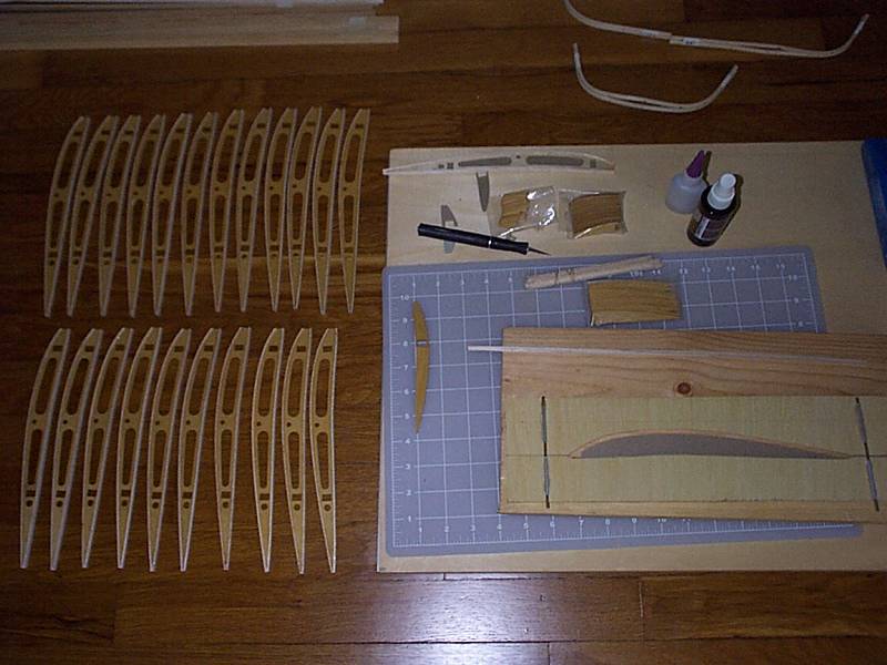

I've been wanting to build a Proctor museum kit for some time now and finally decided the first will be my Nieuport 11. Being a 1/5 scale model of a small WWI French scout it will be easy to transport, won't take up too much building room and I already have a nice .60 engine for it. As the photo's show, the kit comes with a huge amount of hardware and premium components. Most of the parts are already cut, drilled, soldered, etc. So this project should be a snap...well, we'll see.

I've decided to construct the wings and tail surfaces first so they can be stored while the fuselage goes together. The first item to tackle is fabricating the ribs. The rib webs are die-cut 1/64 ply that I stained with lacquer-based oak. The cap-strips are just strip balsa I left bare for contrast. I deviated from the instructions by creating a sliding clamp out of lite-ply so that I can hold the rib together firmly while I glue it together with CA. The Proctor method is to pin everything down flat on a board and glue with Ducco. With 90 ribs to cap like this I just don't have patience for that.

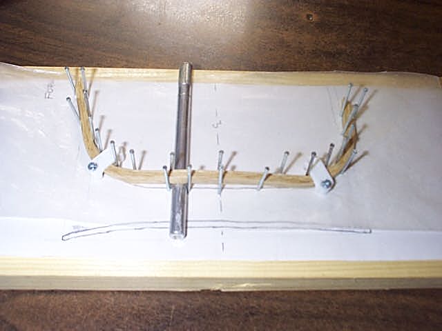

Here is a pic of my clamping jig arrangement. First I lay the web on a piece of thick cardboard the same shape which is glued to the board. Then I clamp the cap-strips around it and lift the whole assembly from the board. Glue it together and presto, insta-rib. After the first couple glued themselves to the clamp I rubbed candle wax on the surfaces and it cured the sticking problem. Only 89 ribs to go!

One of the things I'm working on right now is substituting balsa strip laminations for the bamboo wingtips. The bamboo has a habit of returning to it's original shape and distorting outlines on finished models. Bob, I heard the earliest Proctor Nieuports featured the lamination method. If your kit does I'd sure like to know how Lou Proctor did it. My current plan is a strip of 1/64 ply and 3 strips of 1/16 balsa. With the strips cut 3/16 wide I should end up with a D shaped cross-section roughly 3/16 x 3/16.
I like to use the bamboo(or reed) dowel but make up a balsa support to go inside of the bamboo outline.I hope this makes sense and is just for your consideration.If you like I'm sure I have a picture somewhere I can post.

I found this picture.In this case the inside balsa is laminated strips (using a ply form to get the shape)and the reed dowel is added on the outside.it may be a little hard to see the reed dowel as the wood colors are almost the same.
