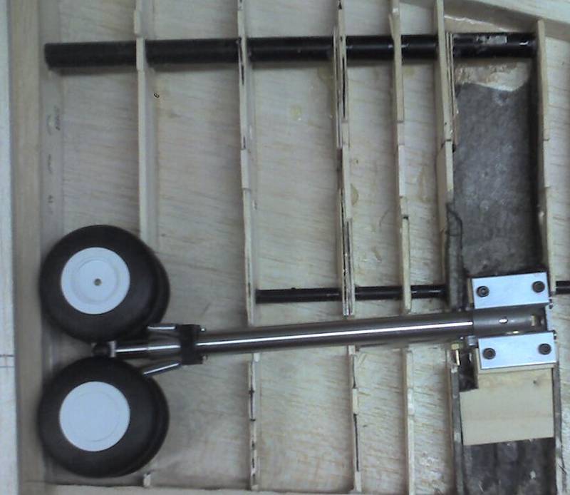

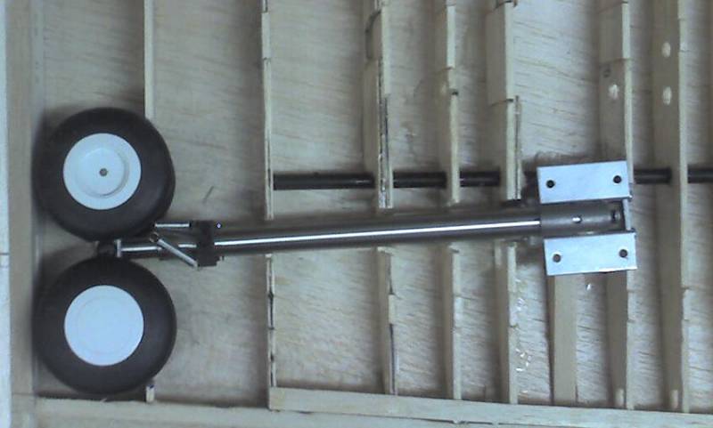

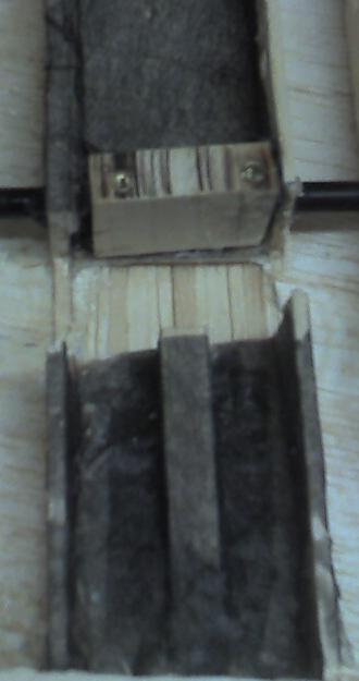

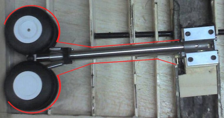

Wow, I can't believe how long it has been since I worked on the plane and posted here. I haven't been home much for the last 2 weeks. I will stick my neck out here and assume that there is still an interest. So here is an update.
I have the landing gear mounts in for the left wing.
In the 1st photo you can see that the old landing gear mounts have been removed. I have patched in the previous rib cuts and cut new gaps for mounting the landing gear. It also shows the gear set in to place. FYI, Ed pointed out that the gear should be rotated back by 5 degrees. To the best of my measuring I get 4 degrees for both landing gear. I don't want to cut the wing spar up by the retract mechanism to get enough room for 5 degrees. It shouldn't bee too tough to move the spar just a bit in the CAD file so that future builds will have 5 degrees.
The 2nd photo shows the retract mechanism and the mount blocks set in their approximate location.
The 3rd photo shows one mounting block installed as well as carbon fiber veil to strengthen this area. I can't believe how rigid the carbon fiber veil makes this area. You can also see that I added carbon fiber veil tie in the motor mount.
In the 4th photo I just wanted you to see that I cut through the wing skin. You can see the underside of the engine nacelle planking.
OK, this is a poor closeup photo again. I am trying to show in the 5th photo a small air gap between the wing skin and the engine nacelle. It's not a large gap but it will allow SOME air to in to the engine nacelle air intake, through this gap, over the motor, and out around the prop. So there won't be a large amount of air passing over the top side of the wing to cool the motor but when the bottom side of the nacelle is built I will get a lot of air for cooling.
The 6th photo shows the retract secured to the mounting blocks so that I can be sure it all fits before using CA and carbon fiber veil to secure the second mounting block.
The 7th photo shows the finished installation..... well, finished for now. I am going to add plywood strengthening later. I want to fit the flap and aileron Nyrod before adding the plywood.

Looks fabulous considering the minimum time you have had to concentrate on what you wanted to do for this.
I would create an isolated retract well to reduce the pressures which will accompany that large mains opening.
When you make your lower retact nacelle be sure to layer it with carbon fiber veil to stiffen it because it is so
large. You don't want it vibrating in the breeze.
Remember its how and not how much....you could use card board and it would have accomplished the same as
balsa after the veil and resin are laminated to it. Placing Syran Wrap flat onto a sheet of glass provides a good
platten for laying up veil, the properly sized card board strips, and another veil on the opposite side. Squeegy
and place second Syran Wrap on the top before laying another sheet of glass on top.
What you end up with is a light weight strip you can form into what you need on either side of the strut and the
wheel. If you have thin G-10 it works best because its ready made: ) Wanted to explain how to roll your own so
to speak.

JetFixr, I am glad to see that someone took a look. I really like virtual reality files because you can see in detail how the pieces fit together. I am sure that most people are hesitant to download an executable file for the viewer, but I'm glad you took the chance checked out the CAD design.
Ed, Thanks for the suggestion about cardboard, but I had planned to make the border around the landing gear using balsa soaked in water for a couple hours or more. It gets pliable when wet so I should be able to make smooth curves, just like you showed in your image. I thought that I should get the nyrod installed first. Thanks again for suggesting the carbon veil. That is incredible stuff! A small amount of carbon fiber veil and CA provides a lot of strength without much weight. Readers can go back a page or two to see the link directly to the product or they can go to home page for FiberGlast which is www.fiberglast.com I thought was priced right and it's shipped to you on a spool so there are not creases.
rt3232, thanks for the encouragement. Interest from readers helps keep me motivated. That hasn't been my problem recently though. I just haven't had the time. Sometimes I am on-call and I work evenings at home.

Be sure to allow at least .125 on all sides of the tire ans strut tube. That permits
your vibrating strut to settle down a bit before it rises into the retract well.

Hi Mike, firstly to line the wheel wells with strips of balsa make your own long strips up from balsa cut from accross the balsa sheet, not along it. The balsa will bend very easily to the diameters you require if you soak them & bend them accross the grain, not along it.
Secondly, why bother? Air pressure build up may be an issue with fast flying turbine jets but for a slow flying electric model you seem to be spending a lot of effort fixing a non existant problem. Most full size aircraft just have big, open wells anyway so it will certainly look more scale like than neatly tailored pockets for the gear.
Do make sure you make them the correct shape, the 3 view will show you how. - John.

Amazing! Sometimes the simple, obvious solution is not so obvious!
Sure, if I cut the balsa across the grain it will be easy to make a 2.5" diameter arc. I just bought the ammonia this morning on the way to work. Oh well.
I agree that it isn't a requirement to close up the gear opening but I am trying to do my best to build a reasonably clean model. There is so much on this build that I haven't done before.
As of last night I am now completely online with plotting. My plots are now accurate within a few thousandths of an inch per foot so I can create a sheet of parts which will make building much easier. I have a 24" wide roll plotter (an HP DesignJet 600). It can plot a 24 x 36 sheet. I hope to be able to define a new sheet size that will allow plotting the entire fuse (82" long) or the entire wing (114" long) on a single sheet. These plots would be helpful as a guide when building.
With a few more evenings making CAD file updates I should be able to make a new set of plans available for downloading. There will still be a few updates later, such as servo / control surface updates, but if someone has a desire, they could start building a B-36 as soon as they like.
Thanks for the suggestion John!

#499
Regarding the wheel wells. The B36 didn't have them. Just like Boomerang1 said, it was just an opening in the wing which the gear doors covered.

Thanks for the info guys, but it just doesn't seem right to leave it all open. The wheel wells would provide support for the edge of the wing skin and the ends of cut ribs.
I don't think I will need air flow in the wing for motor cooling since the nacelles should provide ample air flow. I really do appreciate the info but I still feel compelled to add the wheel wells.
