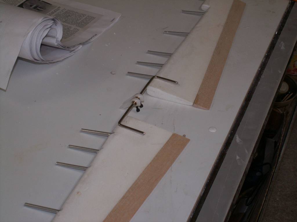

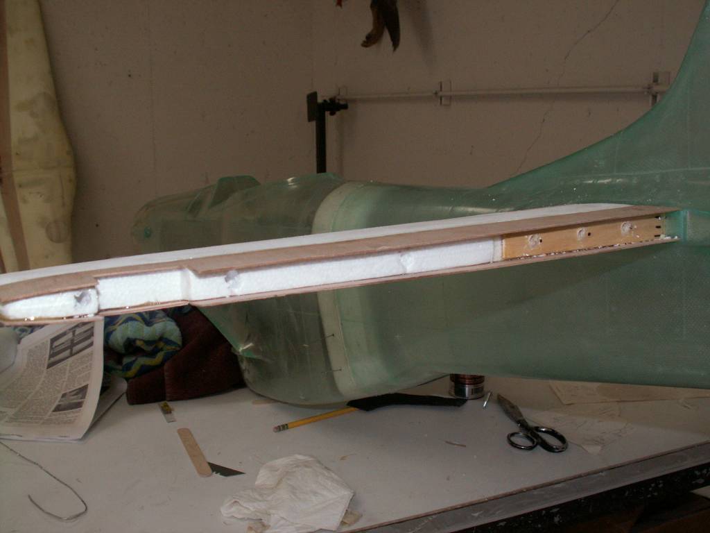

Now it is time for the elevators. These pictures show the hinge covers installed and the holes drilled for the pin hinges. The rudder post has been temporarily removed.

The elevator horn assembly was not in my kit nor were the hinges and aluminum tubes. So I had to make this control assembly by hand. I used some heavy duty landing gear wire and put it in a vice and SLOWLY bent it untill it was the size and shape I wanted. This baby is really strong and will not bend! The control horns on it were from an old kit and are the front steering arms. I cut one side of them off and replace the grub screw with a bolt so it would be easier to adjust and tighten when it is inside the fuselage.

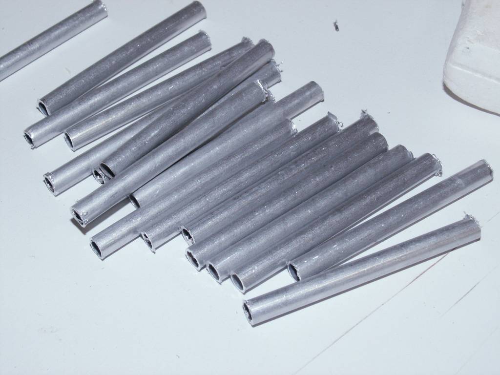

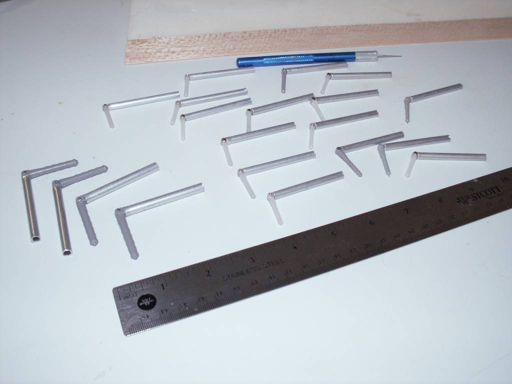

I had to cut 12 of these. For the hinges around the control horns, I used one size larger. I wanted more strength and ridgidity.

The hinges are made from 5/32" x 2" aluminum tubing and a robart pin hinge. The hinge is slid into the tubing and then the tubing is crimped. For the two hinges on the inboard sides of the elevator, I wanted more strength there so I used the larger robart hinges set into 7/32" x 2" tubing. Here is a couple of pics showing them temporarily installed in the elevators.

If anyone has any ideas or suggestions feel free to chime in or at least say Hi! I am documenting all of this for the "other guy" that wants to build one of these. It has taken alot of time so far in this build, doesn't seem like it to people just reading these posts because it only took me a couple of days to upload them. But I have been compiling these videos and pictures for a couple of months now. I am glad I have done this. If it helps one person, it was worth it!
#57
My Feedback: (23)
I know many of people who have lost Byron models due to hinges wearing out the foam. I would highly suggest replacing your aluminum tube idea and replacing a section of the foam with a balsa block that is drilled for the hinges.
The plastic steering arms could also prove problematic. I'd suggest replacing it with a piece of thick (.090" brass) that is silver soldered to the steel rod. Done properly this is a strong, slop free linkage setup. I believe your current setup will develop allot of slop over time (or break) if speeds average to high.

Hey Tom, I have been watching your videos on you tube for a couple of years now, I really enjoy them. Good job on that Tomcat and others that you have built. I will take your advice into serious consideration, I was thinking the same about the control horns. In order to do that fix, I would have to completely build another set. how about grinding the front edge of the steel where the grub screw meets and puting a buch of jb weld around and inside the joint and then tighten that sucker down using some permanent thread lock? The max speed of this plane is only about 80mph. It has the reduction drive system in it.
Over the years though I have read alot of posts for others that claim that these hinges really work well if intalled by the directions and will not come out. This is the first time I have heard of that. One guy that is a rc p-51 guru and really likes the byron line stated that to a few guys here on rcu. I can't remember his name but hopefully he is reading this and can chime in. I may just install another strip of 1/8" ply over the hinge attatchment points on the horzontal stab and glass inside of there when I glass the stabs and elevators. I too am a bit worried about that design. I haven't glued all of this together yet so it can still be tweeked lol.

Looking good so far. I like the idea with the tubing and robart hinges. I've a couple of builds where I wished the hinges were longer. Such a simple solution.
