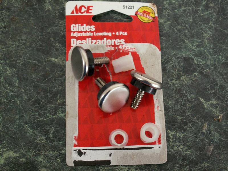

Now there were alot of hardware parts missing in the box. That is ok, I just had to improvise. Yesterday, I went to serveral hardware stores to see if I could find any of the male/female ends that connect the ailerons to the wingtips and flaps because of course, there were none. But, I found some hardware that looked close to it. I found a product that would work, I thought for a few bucks, why not try it? so I purchased a couple of packages of them. Here is what they were. (the first image)[img][/img]
Now obviously, I didn't need the glides themselves! I put them into a drawer somewhere and I just wanted the plastic elevation adjusters. I took them and drilled a 1/4" hole in the ends of them and used my belt sander to thin down the lip of them very thin. I inserted a 1/4" aluminum rod in one of them and glued it into the wingtip. I then did the other side. On the side where the aileron butts up against the flap, I inserted one there, snapped in the aileron, sanded everything down evenly and whala! done. I got the flaps, ailerons, wingtips with ailerons installed today. I was going to put the aileron/flap covers on today but I didn't have any 1/32 light ply to make them. Off to the Hobby shop tomorrow.
Here are some pictures of my progress today. The first pic is the glides and the plasic elevators that I used. The second is the wingtip stud installed before sanding and the next two are of the completed aileron/flap assembly. Neat thing about this design is that it is strong, and can be taken apart if need be.

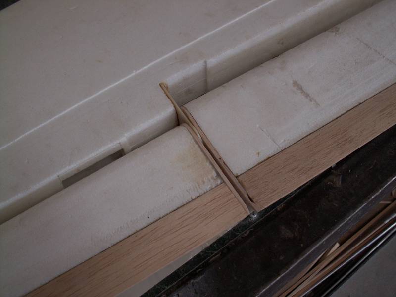

Today I had to cut out the aileron / flap covers. Not too hard just really time consuming to get them perfect. While I was at cutting light ply by hand I cut out the elevator / stabilizer covers and the spar covers too. I just really took my time and I used a piece of aluminum that was 1/4" X 2" X 44" long (straight stock) that I bought at a typical hardware store. It is really good for drawing long straight lines and has the weight so it doesn't move around much when you put side pressure on it while cutting with the Xacto knife. I thought about cutting this stuff with my bandsaw but it wouldn't have been as straight an accurate so I just did it the old fashoned way - elbow grease and the patience of an oyster!!!! LOL. I got them all finished and they fit like a glove. Whoo hoo!
Joined: Jul 2007
Posts: 757
From: E. Wenatchee, WA
After cutting them out, I did a temorary test fit by taping them onto the wing. They seemed like they fit great. I cut the stringers to size and glued them on all of the covers. The insrtuctions say to glue the stringers back away from the trailing edge aprox 1/4" but I felt that wasn't enough so I backed them off another 1/16" or so. Now it was time to glue the top aileron/flap covers on and let them set up. The directions say to glue the top cover on, install the aileron then to glue the bottom cover on. I wanted to be able to take the ailerons out for finishing and painting so I didn't. I got all of the covers glued on and the left wing aileron was perfect. Assembled easily and fit great. Hmmmm, the right wing - well crap, the covers were too close together and the stringers that were inside of the covers were not backed off enough! When the aileron was moved up or down, the stinger would catch it, stopping the aileron. I should have backed the stringer off even more. DRAT. After some trimming, beveling of the stringers, and a bit of sanding, It eventually went on well. Upon inspection, the plastic tab that holds the inside of the aileron with the plastic bearing was not put into the wing straight by the original owner. I was able to fix that and it is a tight fit now, but later I will be sanding for the finish work and will make all of the parts fit evenly with a bit of a gap between the surfaces to compensate for the thickness in the glassing.
