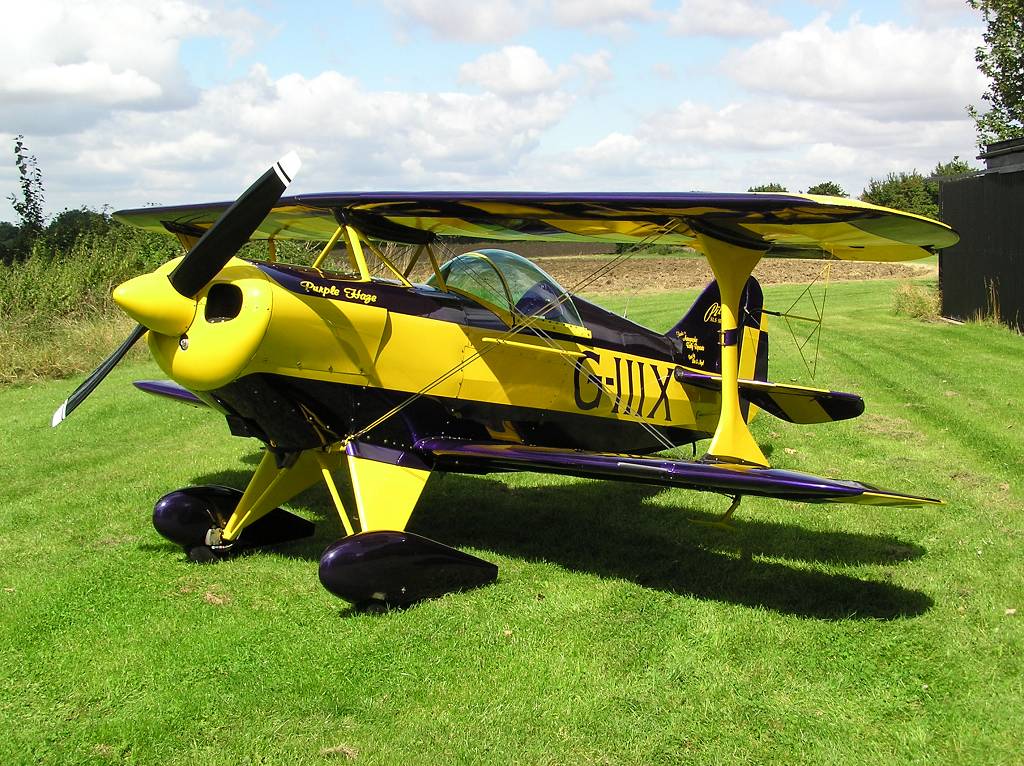

Hello There,
My current Project is a 33% Pitts S-1S and I am now in the Process of making a scale instrument panel, I have figured out how to make all the instruments. But the panel I am replicating has several toggle switches. Does anyone here know of a source for good looking toggle switches for this purpose??? I have looked all over the internet and have not come up with anything close to what I would like, they obviousily do not have to be functional at all, I have seen quite a few "Micro" toggles on the market but they are still to big for my application. Any info would be greatly appreciated.

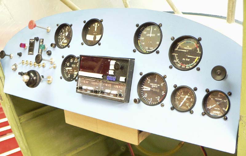

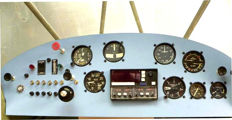

The toggle switches on my 195 were purchased from InZpan. Just checked, and their website is down.
Propagteam may know of a distributor. I assume that they are the manufacturer.
Looking closely at the "switches," I believe that they could easily be made by using the nut and wire method. As Abu suggests, painting the wire heavily will produce the tapered effect.

Tom,
If I can get my panel to look half as good as yours I will really feel like Ive accomplished something fantastic. My friend you detailing is as good as it gets, when I looked at the other details from your 195 I was absolutely amazed. From the information Ive gotten from this thread, the scale ship parts definately look as though they would work pretty well for what I want.[img][/img] Here are a couple picts of the panel and cockpit of the Pitts Im modeling. The Pitts is G-IIIX flown out of england, I choose it becouse of the name painted on the cowling "Purple Haze"

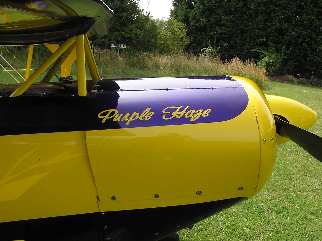

Here are some other picts of my scale subject. I will make sure to post picts on RCU of the finished project.
JRF

ORIGINAL: Phrydaddy
Tom,
If I can get my panel to look half as good as yours I will really feel like Ive accomplished something fantastic. My friend you detailing is as good as it gets, when I looked at the other details from your 195 I was absolutely amazed. From the information Ive gotten from this thread, the scale ship parts definately look as though they would work pretty well for what I want.[img][/img] Here are a couple picts of the panel and cockpit of the Pitts Im modeling. The Pitts is G-IIIX flown out of england, I choose it becouse of the name painted on the cowling ''Purple Haze''
Cheers
Jim Freiberger
Thanks !
Looking at your pics, it looks like the hardest part to replicate will be the textured paint on the instrument panel. How do you plan to do that ?

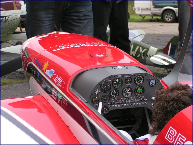

Check out this guys panel in his 40% 3W extra.

Now that is what Im talking about!!!!!! Im pretty sure at 40% you could actually use the Mini toggles that Radio shack sells and they would look just fine. Im impressed by the full cockpit and the tubing to simulate the fullscale construction. But he needs to give Patty a Haircut and a bleach job to keep up with the times ;-) One thing Ive been thinking about, consdering the fact the when these panels are observed, the model is sitting on the ground, so to me it would make sense that the RPM gauge would be at Zero, as well as the Airspeed, and the Altimeter should show the elevation of whatever the person is calling their home base (or in the case of a aerobatic airplane thats used to perform O') WHen the gauges should show anything other than those readings the model will be in the air, and no one can see them..
