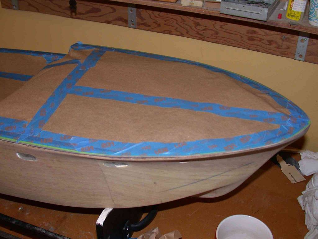

Here's an image of the antenna mount. It is screwed in to a hardpoint of 1/4 inch plywood on one of the frames and is cut from 1/8 inch ply. In keeping with Futaba's instructions, the antennas are orientated 90 degrees apart. I still like the idea of keeping at least one of them vertical over the surface of the water. It should help with the reception during my trips to the other side of the lake. Dan.

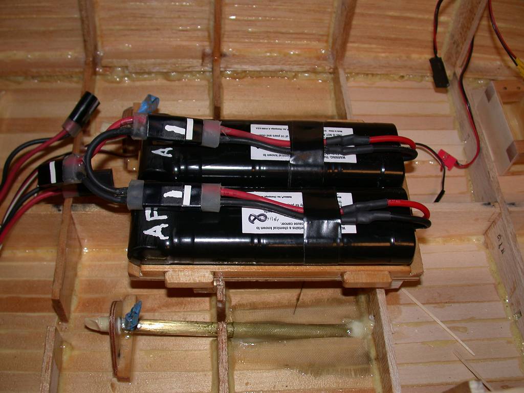

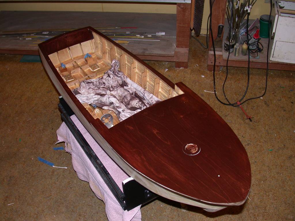

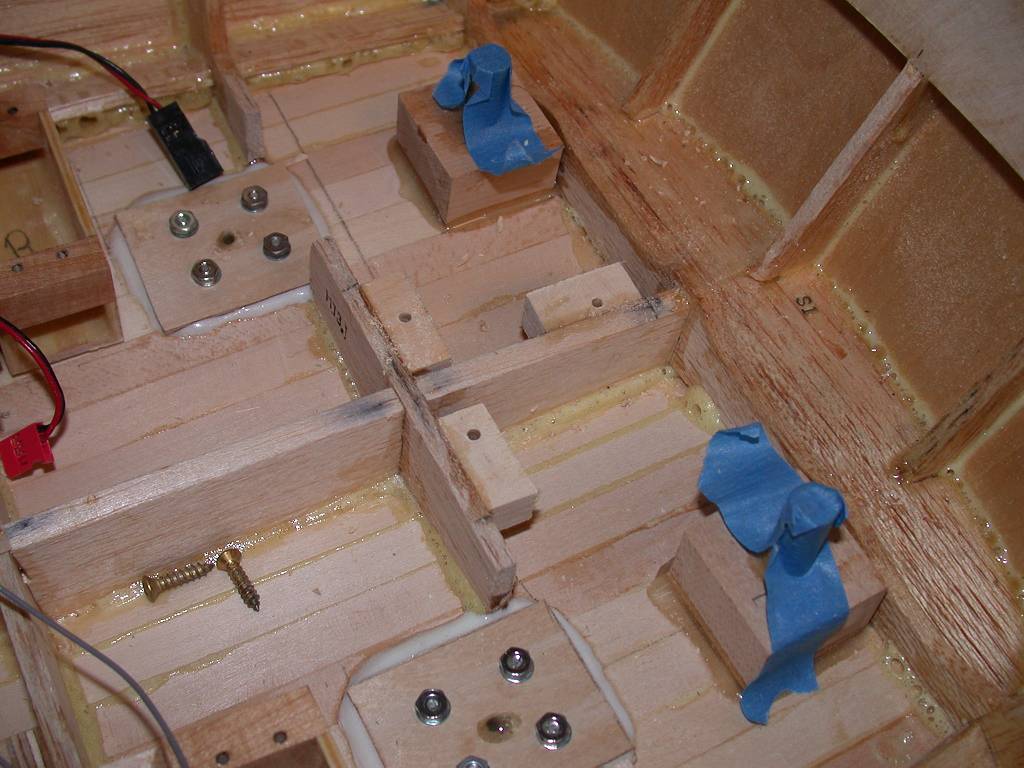

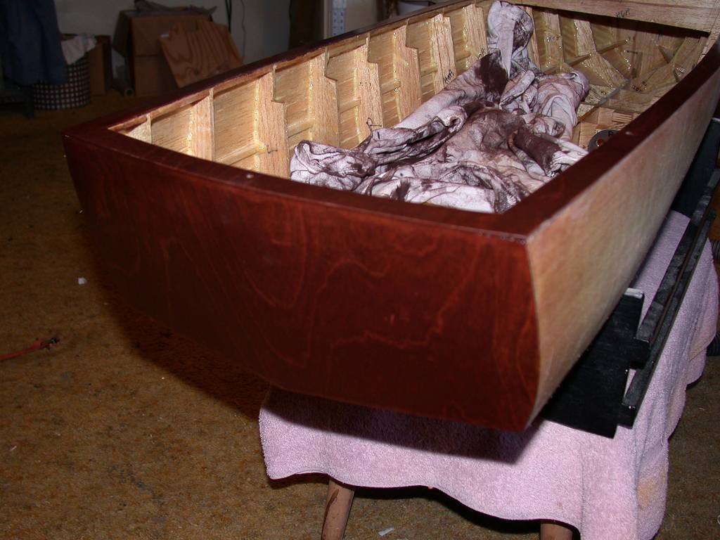

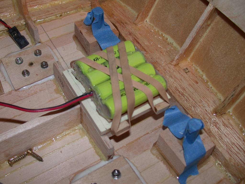

The last thing, the receiver battery pack is in. First some 3/8 plywood pieces were epoxied to a frame and the keel. A mount for the pack was screwed to the hard points with flat head sheet metal screws. Finally the battery pack is held in place with #64 rubber bands. Now, I have to continue coating everything with the finishing resin. Dan.
ID:	1780007   Click image for larger version
ID:	1780008   Click image for larger version

I had a full day of sun so I was able to stain and spray on four coats of clear. The dark stain color really got warm in the sun and cured all the coats in an hour each. Dan.

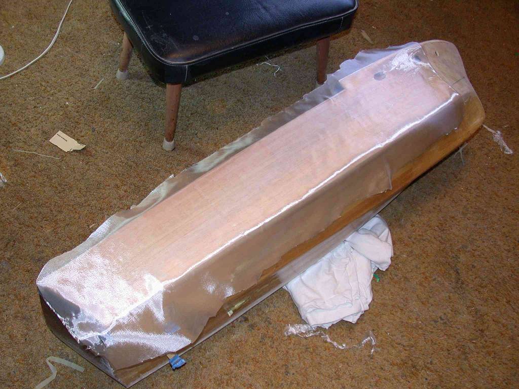

Old 07-12-2012 | 06:49 PM
  #139
All Day Dan's Avatar
Joined: Dec 2002
Posts: 4,606
From: MANHATTAN BEACH, CA
Default RE: Sterling 48

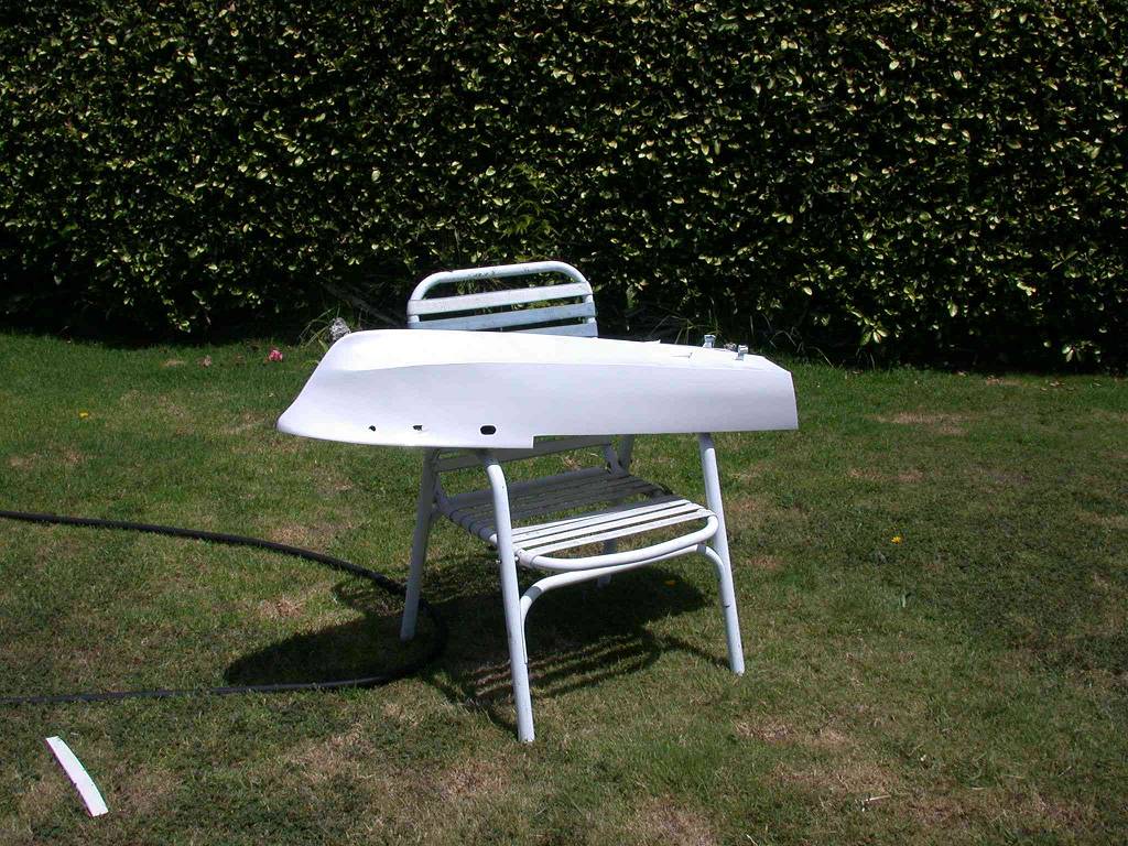

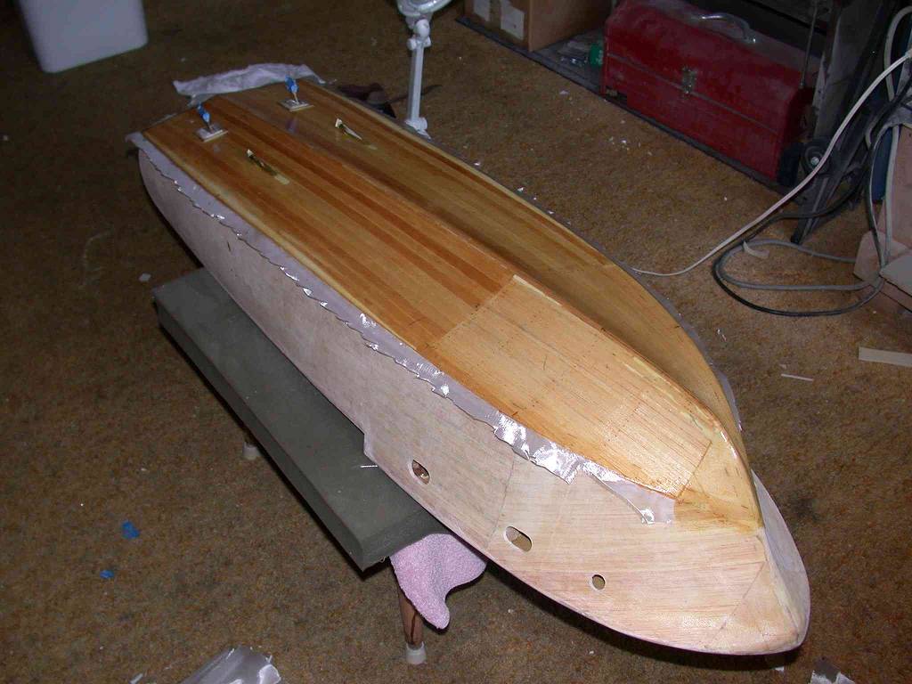

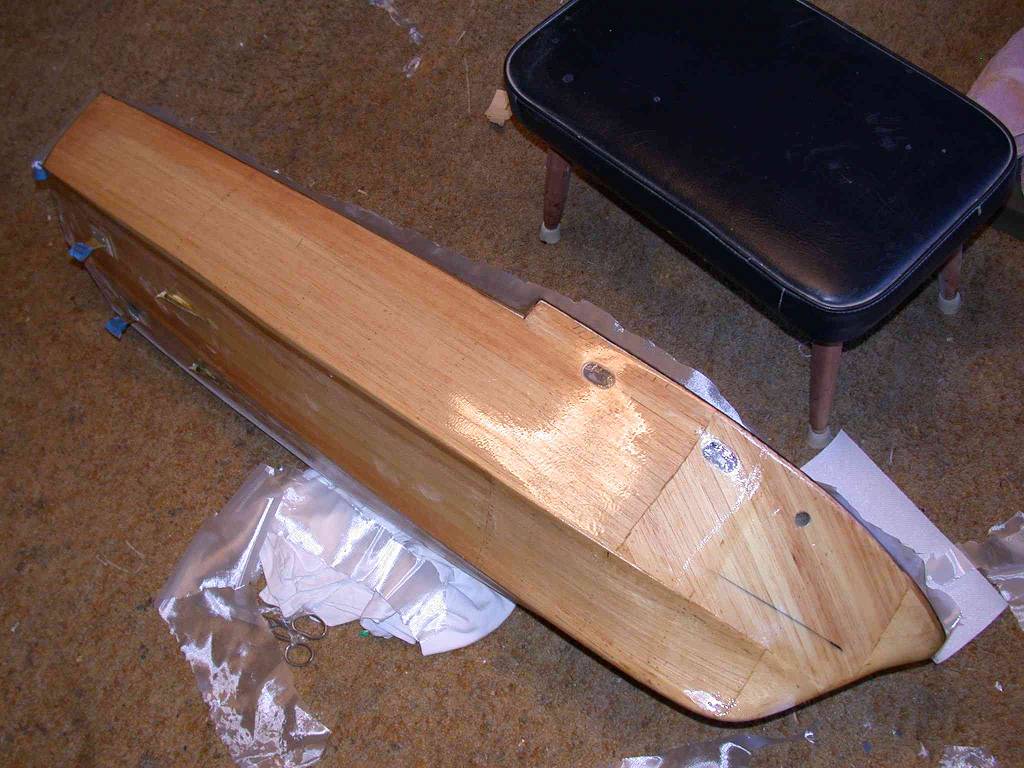

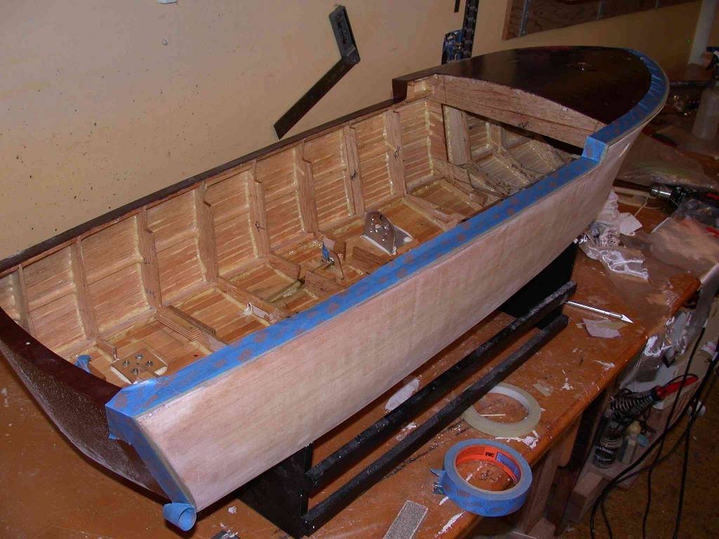

I covered the bottom of the hull with ¾ ounce fiberglass cloth and some more Finishing Resin. The cloth was placed flat on the bottom and smoothed out. The resin was brushed on with an acid brush. It was then spread evenly with one of those small high density foam rollers. The good old sun accelerated the curing time. The excess was sanded off. The stained surfaces were protected with two types of tape in preparation to coating the sides. The main barrier is Scotch Fine Line tape. It is translucent green in color and is available from the auto paint stores. The blue tape is the regular painter’s low tack tape. The coating process was repeated on the sides. I’m just about through the second set of resin for this build.
ID:	1781321   Click image for larger version
ID:	1781322   Click image for larger version
ID:	1781323   Click image for larger version
ID:	1781324   Click image for larger version
ID:	1781325   Click image for larger version
ID:	1781326   Click image for larger version

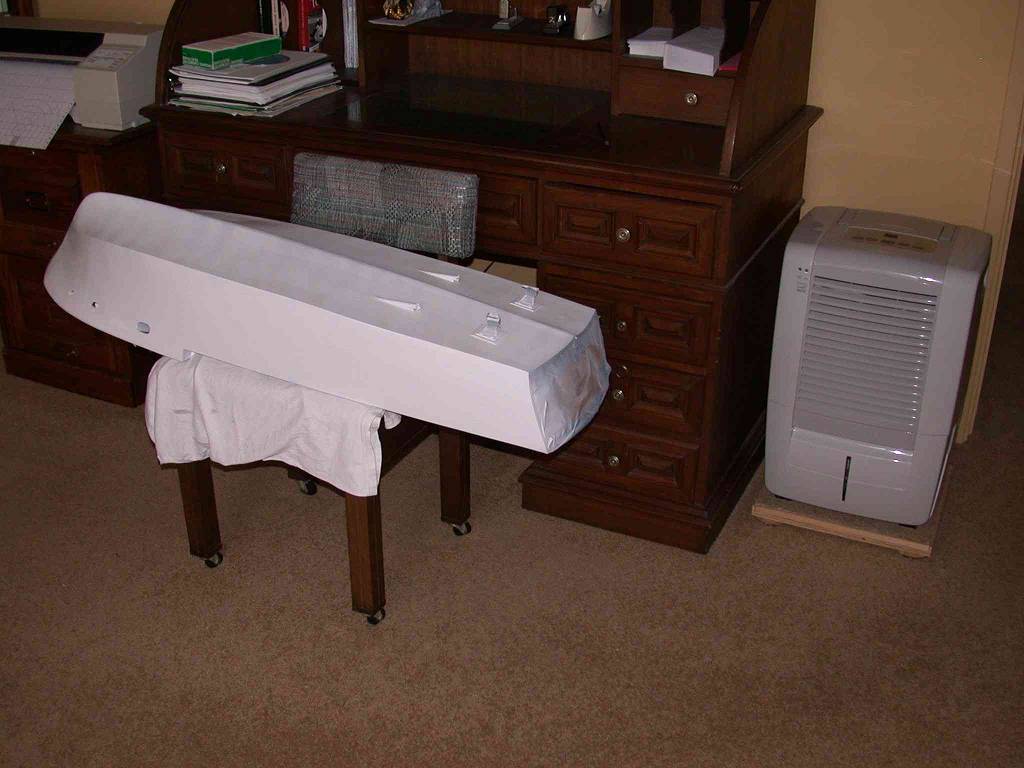

Old 07-12-2012 | 09:32 PM
  #140
Kmot's Avatar
My Feedback: (24)
Joined: Jun 2003
Posts: 10,963
Received 5 Likes on 5 Posts
From: Northridge, CA
Seeing the boat in the chair, I finally have a sense of how big this sum***** is!
Old 07-13-2012 | 08:07 PM
  #141
Joined: Dec 2002
Posts: 4,606
Tom, a few minutes after that image was taken of the boat in the sun, the marine layer moved in and the temperature dropped precipitously. I had to bring the boat in where the house temperature was 75.

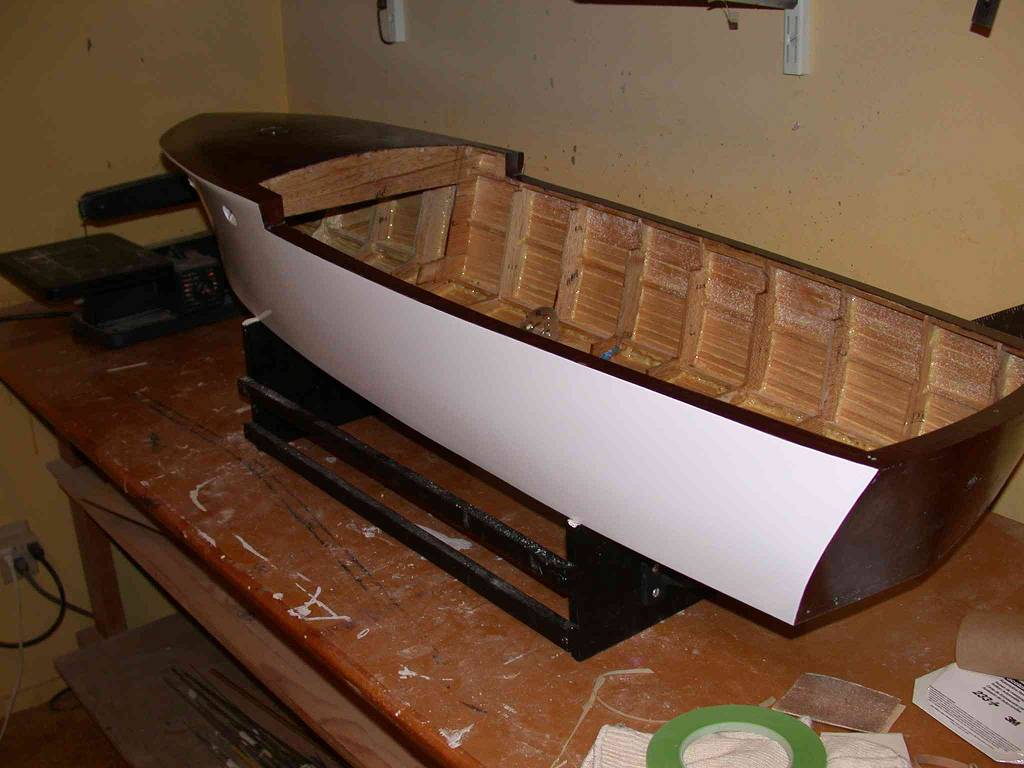

The Z-poxy Finishing Resin cured well overnight and I attacked it with 80 grit paper. It took a few hours until I had the surface defect free. I then had to remask everything, this time with paper also because I was going to do a lot of spraying. I use PCL 913 a lacquer based primer. Ever since these primers were banned for automotive use in the Los Angeles area, DuPont and PPG stopped shipping them here. Pacific Coast Lacquer is local and the only one available. A Devilbis Touch Up gun is used with the medium tip. 1 part of primer is mixed with 1.25 parts lacquer thinner. All spraying is done in the garage. The first coat was sanded with 150 grit paper, the second with 220 and the third with 400. All that fiberglass and resin really paid off because there was very filling to do. The surface is near perfect.
ID:	1781629   Click image for larger version
ID:	1781630   Click image for larger version
ID:	1781631   Click image for larger version
ID:	1781632   Click image for larger version

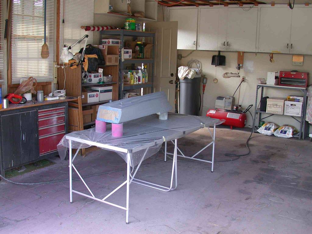

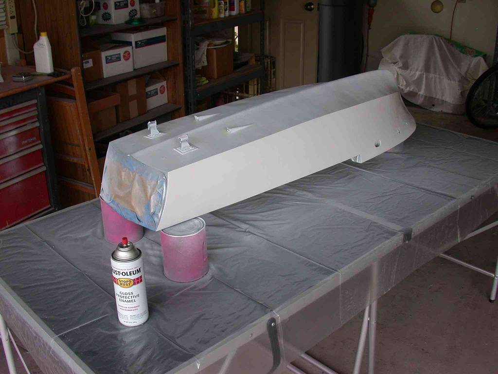

Old 07-14-2012 | 07:25 PM
  #142
Joined: Dec 2002
Posts: 4,606

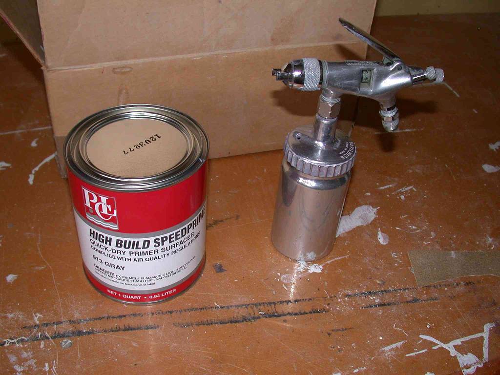

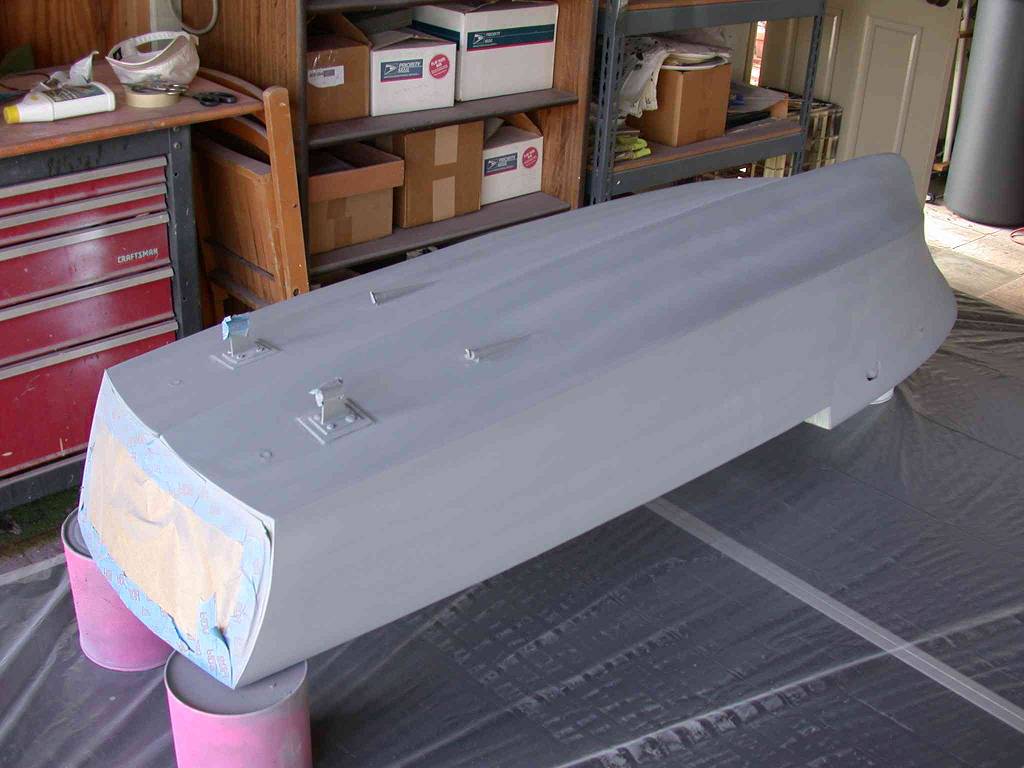

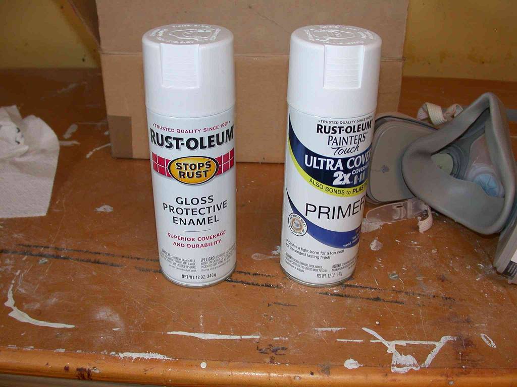

There’s nothing like Rustoleum for a good finish. Out to the garage again for a heavy coat of primer. Because it was foggy, I brought the boat in to the house where I have a dehumidifier going in order to reduce the humidity and raise the temperature. It was 76 degrees and 45% humidity. After an hour, it was out to the garage for a very wet coat of white. Back in the house for an hour and then to the garage for another wet coat of white. The sun did come out so I let each side soak in the sun for two hours. The paint was dry to the touch and I was able to remove all the masking material. The result was just what I was hoping for. I’ll let it dry for another day and then I’ll mask it off for the bottom paint. Dan.

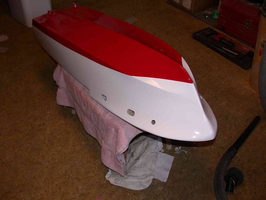

Old 07-15-2012 | 06:17 PM
  #144
Joined: Dec 2002
Posts: 4,606
Living by the coast has its advantages.

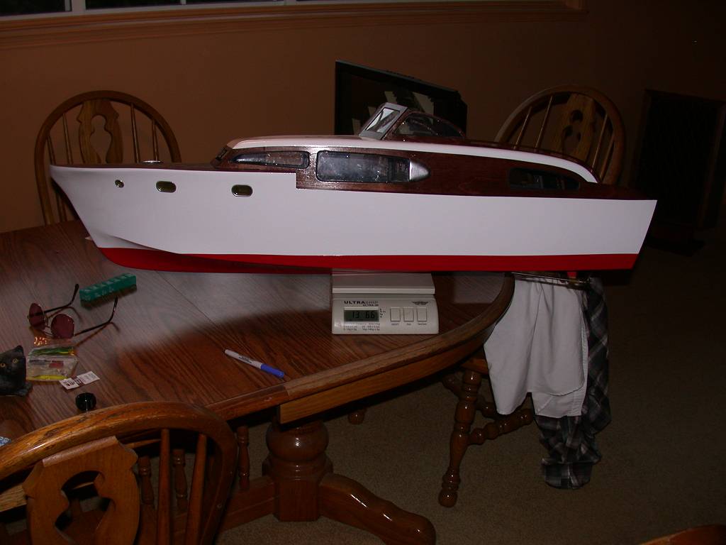

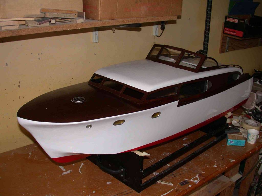

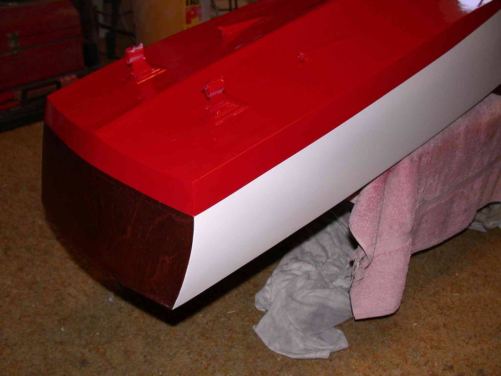

The bottom of the hull got the Rustoleum treatment after the white was taped and masked. The plans call for a bronze color. However, I had plenty of red so that's what it got. The plans showed the water line but it did not make sense. I had to scribe my own after proping up the hull and using the table top as a datum. Whos knows if it's right? Anyway, who cares. Dan.
ID:	1782340   Click image for larger version
Old 07-15-2012 | 09:30 PM
  #145
Kmot's Avatar
My Feedback: (24)
Joined: Jun 2003
Posts: 10,963
Looks nice Dan! I have seen those bronze color bottoms and I think it looks funky. Red is much better.

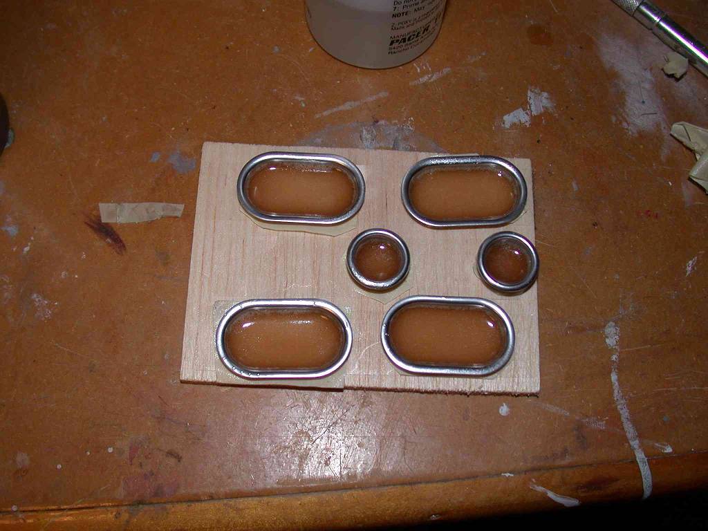

The porthole rims got a coat of Rustoleum primer and then chrome paint. Masking tape was pushed on to the inside edge of the rims. About 1/8 inch of Finishing Resin was poured in to the rims to simulate the window. It came out translucent, not really clear. When cured, they were epoxied in. Here's a shot of the completed assembly. All that's left is putting in the running gear. The red is still soft and I'll have to wait for it to harden until I can start installing the gear. I'm about a week away from the maiden voyage. Dan.

Old 07-16-2012 | 12:30 PM
  #147
Joined: Feb 2008
Posts: 815
From: Danville, IN
Those port holes look much better than the originally planned "black holes"
Bob

Yeah, that's a heck of a cool technique there for the porthole glazing. Gotta file that one away!

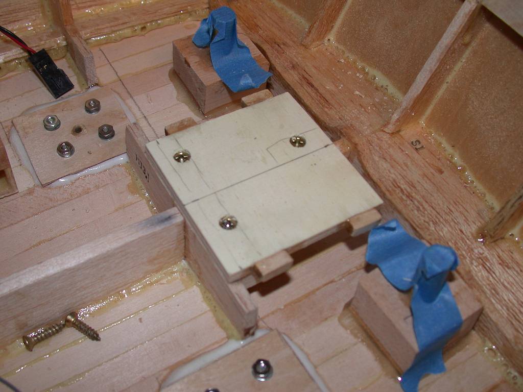

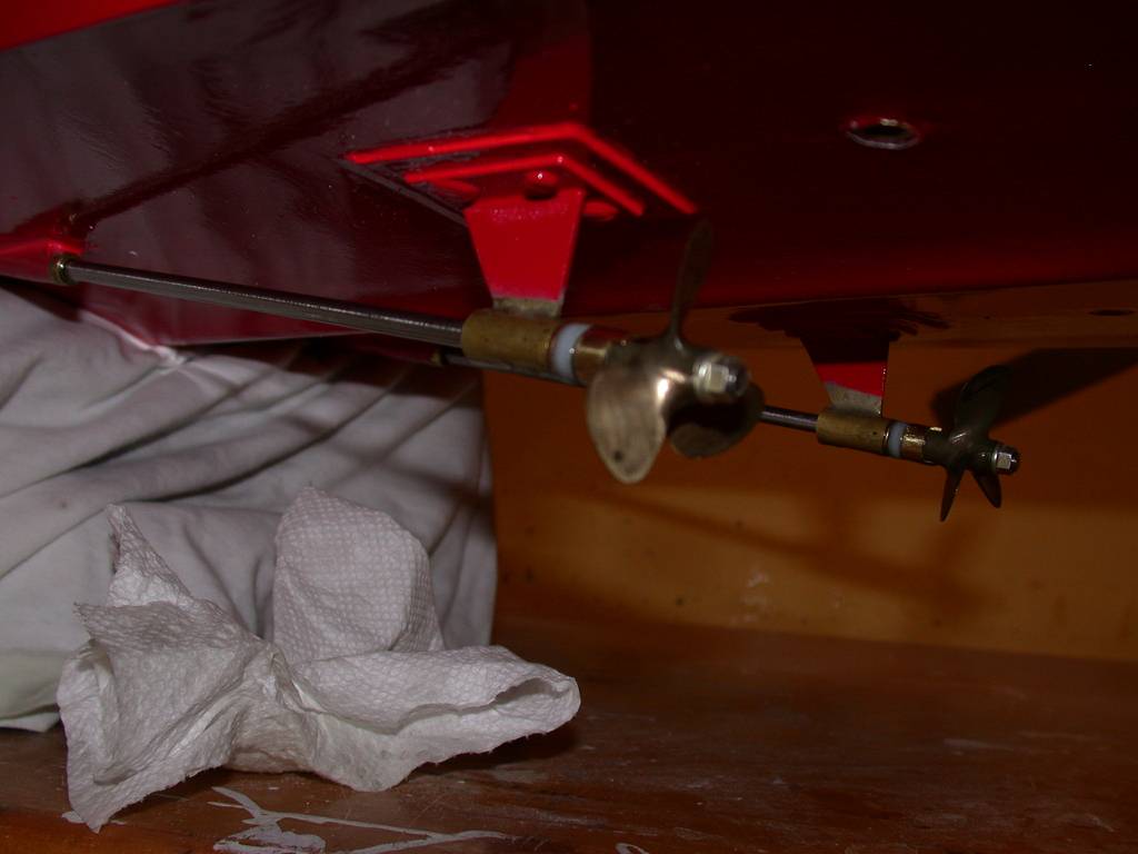

I got the motors installed with the prop shafts and props. My three cell battery pack was used to get the motors turning to check the rotation. Every thing was smooth. The batteries were laid in place to check out the weight and I was amazed to see that it weighed a little over 13 pounds, maybe a little more when it's ready to go. At this weight it will be bobbing around on the surface like a toy. The CG was also a little further back than I wanted. I'll have to ballast it with four to five pounds of lead around the keel. Dan.
ID:	1783081   Click image for larger version
ID:	1783082   Click image for larger version
ID:	1783083   Click image for larger version
