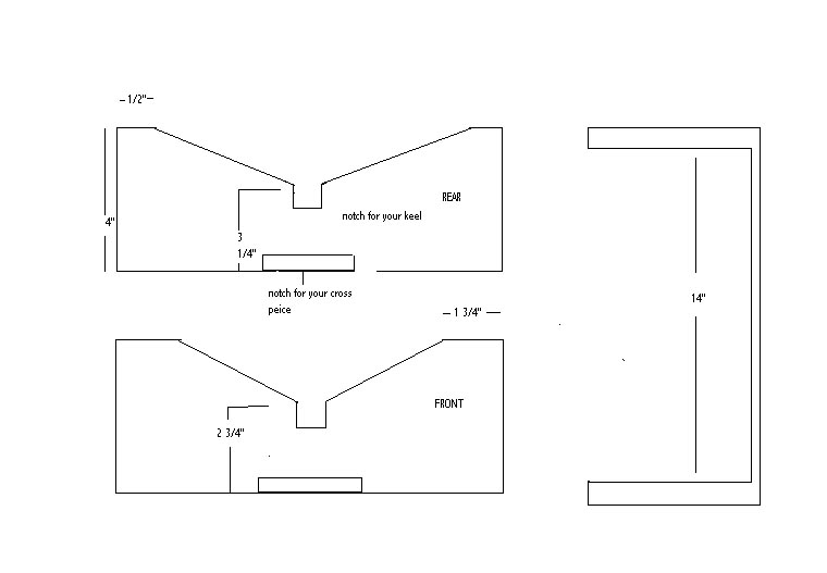

Looks super...very nice job! Question: any chance I can get the dimensions and a stencil of your mounting stand? Looks very nice and displays the boat very well.

here is a little something I drew up for you I hope it works.

Super...what is the width of each support from left to right?

sorry I forgot to mark it 11"

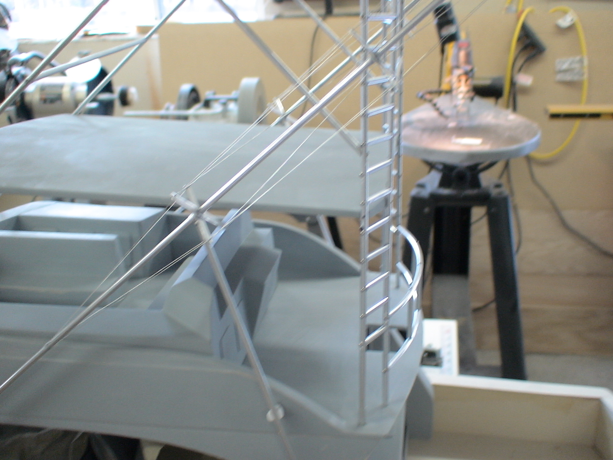

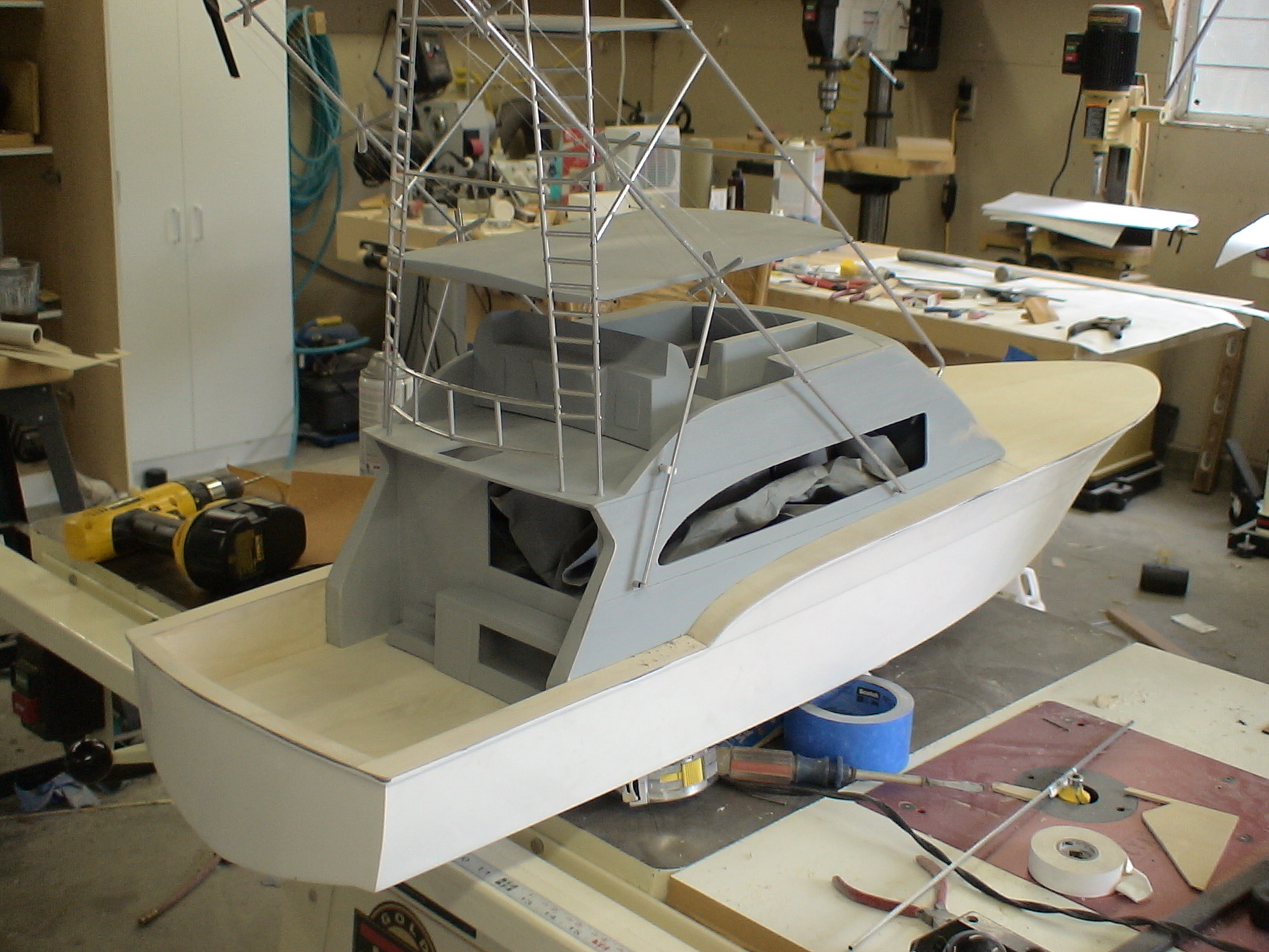

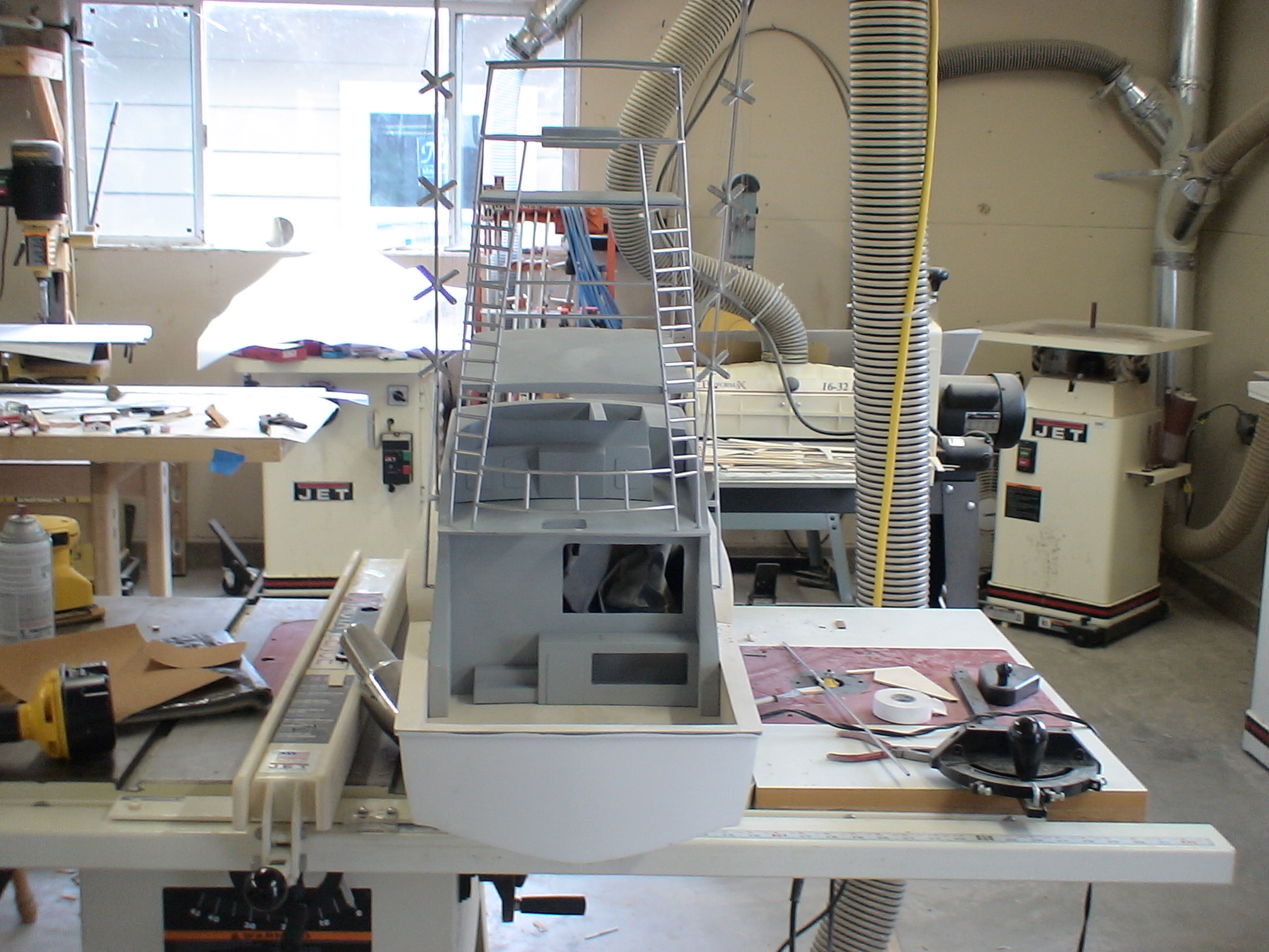

Heres some pictures of my custom donzi I didnt like any of the tuna tower dowel const. so I made my own should be done in about amonth or so.[img][/img][i

heres more pics of my donzi in construction

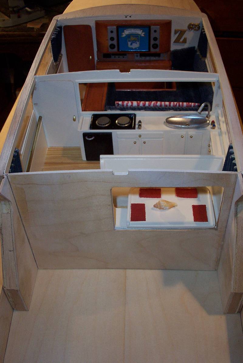

...a finished interior by Happy Gilmore, Columbia, SC.

Happy, that is very nice! [sm=thumbup.gif]
