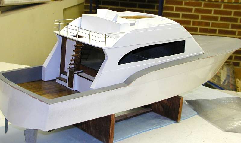

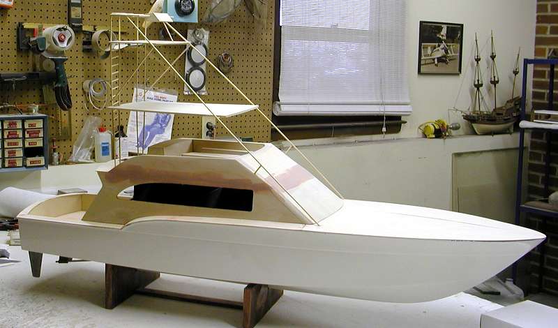

I just thought those that are interested would like to see my donzi's progress. I have added a couple of other cabinets as per the donzi literature I have. and will be planking the deck and rear cabin. the plans and instructions leave alot to be desired. Now for the dreaded glassing.

Vett, super job! Looks really nice. Also looks like everything is straight and true...not easy to do with this model. I am adding a cabinet under the window as well, similar to yours. I have all the connections for the batteries (RX and engines) and switches located there. The idea is to minimize the amount of removing the cabin.

Yeah removing the cabin. Mine is a little tight so I will sand the bottom of it so when I paint it will be OK. Just did the railings last night, the palns don't give you to much, you really have to search around.

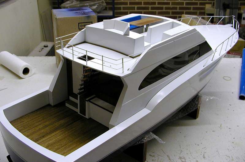

a couple of more pictures it's getting there.

Super job....the natural wood adds a nice touch. How did you get the railings so straight?

it was really easy I used stanchons from an old robbe kit. the cabin back is mahogany and the deck is stained balsa that has been hardened.

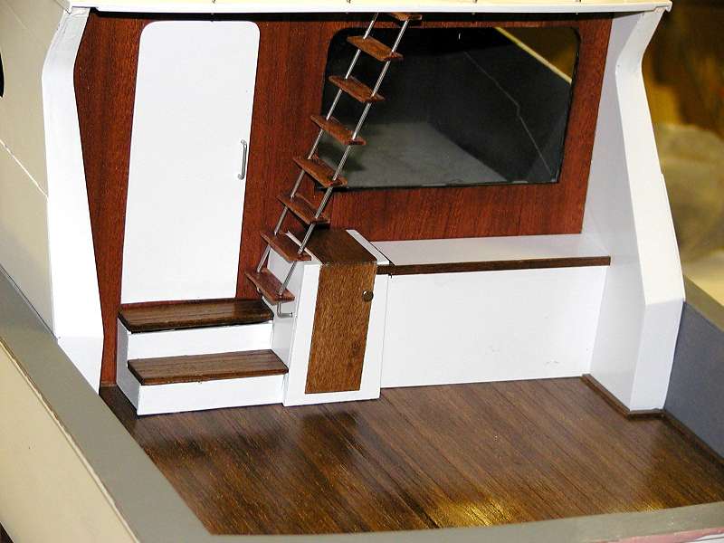

Almost there just have to paint the tuna tower and finish putting the fabric on the seats. I think I will be selling on ebay as it is not my kind of boat and did not come out perfect, I am crazy that way.

the rear railings are brass rod and the stanchons are from an old robbe kit. the front ones are from the kits rods
