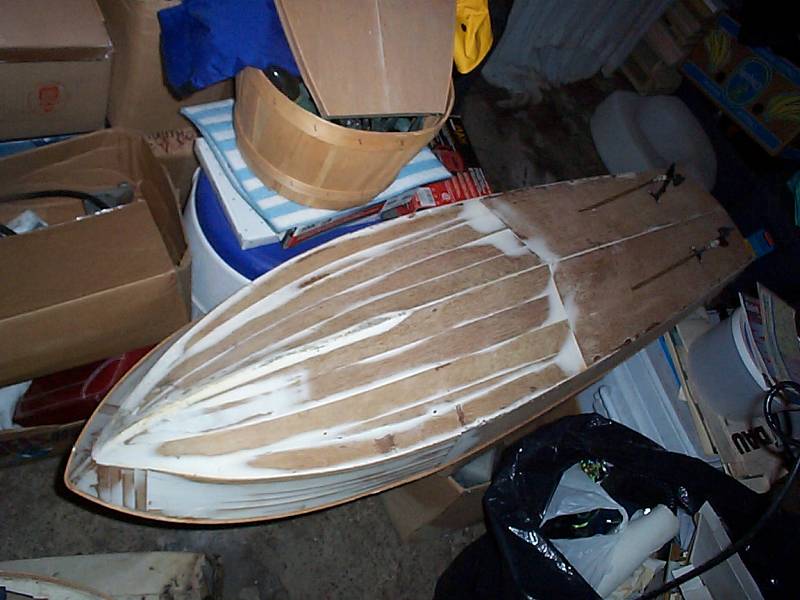

well i decided not to get the deep vee. instaed i got the dumas dauntless. its the 49.5 inch cabin cruiser. its in the midst of being finished as we speak. here are the pics of it when i got it yesterday...

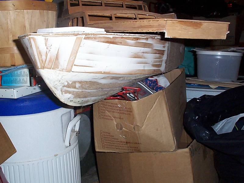

just finished sanding the hull. still alot to do to it before summer next year. more pics to come of the finishing project on it....[8D]
p.s what do you use to seal the hull? paint? i cant find epoxy paint anywhere ....any advice would be appreciated.....

Just regular epoxy. Brush it on and wipe off the excess with a paper towel.

what kind of epoxy to use? after epoxy what kind of paint? name of epoxy to be used?

Use a good hobby grade epoxy. You'll probably want one with at least 45 minutes to give you more working time.
Seeing how it's an electric boat, you can use just about anything but keep it the same type of paint otherwise you could run into compatability problems.

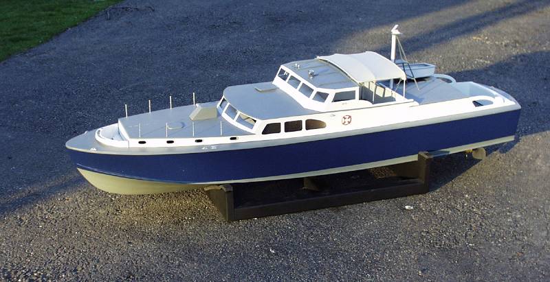

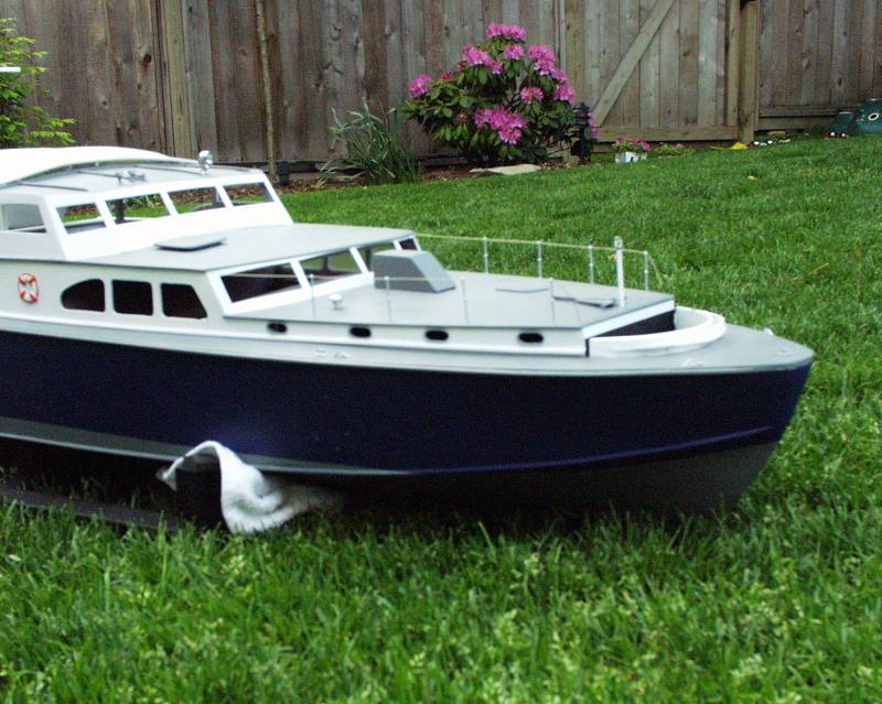

Be sure to use at least 2oz. fiberglass cloth on the hull! The hull needs to be reinforced with the glass. If you have any questions about the build drop me a line...
I am running twin water cooled AstroFlight 25's with two Astro 308D Speed controls and each motor is running on a Sanyo 5000mAH 10 cell pack. It gets on plane FAST!
