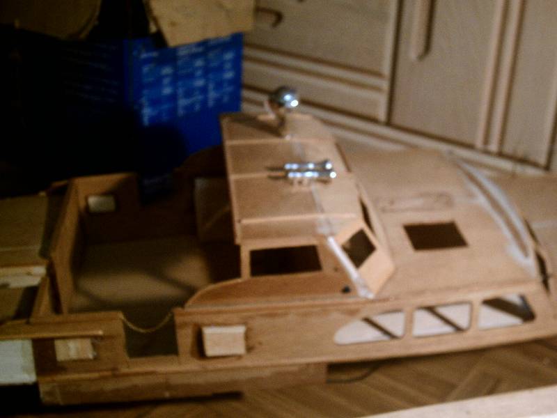

Hello-Received My Hardware Package From Dumas For My Dauntless--Hardware # 2332-
I See The Shaft Size Is 3/16- I Have Two Motors "700s" And The Shafts On Them Are 1/8 th--
Where Can I Find The Right Connection To Set This Up?? Do I Have To Go With A Dogbone Deal??
Here Is A Picture Of My Dumas Thus Far--Before I Dress It Up i Would Like To Set Up my Electronics-
Oh Yes- I Did Cover The Pit---I Never Did Like That---So Sorry----LOL-
Thanks For Any Help- Can't Find How To Add A Pictrure--Next Time---
