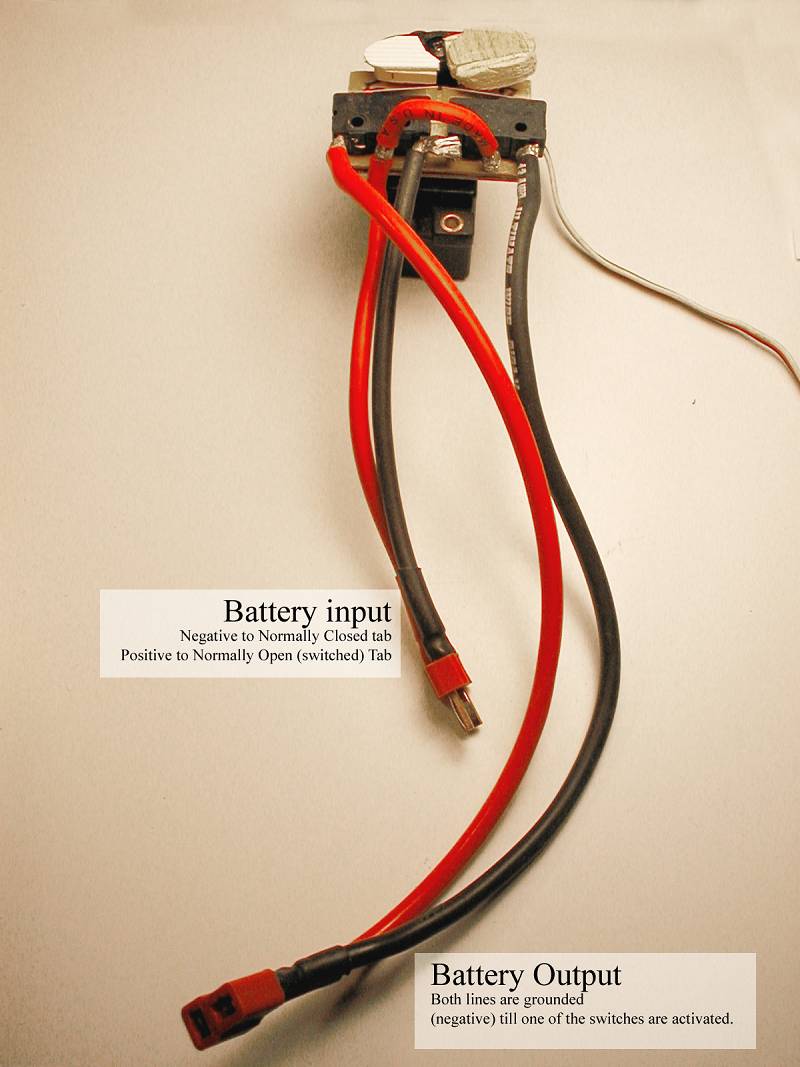

Thanks Umi. I tried the robbe web sight to no avail. I emailed them and if worse comes to worse I can order it from them for 5.75 euro plus postage. I see you run out at Tualatin Commons. I work just down the street from there at a metal company. If you ever need sheet metal or aluminum let me know. I noticed that you are quite adept at finding stuff on the web. Do you know if there is a wiring schematic for micro swithes running a forward/stop/reverse for a bow thruster? I'm building the Model Slipway Yorkshireman now.

Here is a simple F/S/R switch I made up.
If you need a diagram, I can do that too.

Thanks Umi. That is exactly what I needed.
