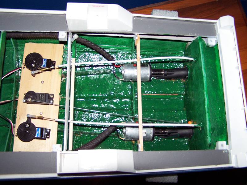

I'm nearing completion of the Dumas American Enterprise. I'm going with two of the Graupner mini jet drives, powered by the Speed 500 motors (two, of course). I'd like to know (since they'll both need to run at the same speed all the time, and forward only), if it is possible to control them both with just one ESC? If anyone has any experience with this, I'd love to hear your opinions.
Possibly recommend an ESC that would be sufficient as far as handling the required amps, ect. I'm not looking for speed here, just a scale like motion at full throttle, and the maneuvering when coming alongside the dock to moor. Of course, cheaper is better if it can be done so. Thanks in advance, I'm new here, and after reading the scale forum for the last few hours, I must say I'm genuinely impressed with the knowledge of the members here!

The simple answer is to do a stall test on one of those motors. Whatever max current draw is, double it, and that's the max current rating the ESC should have to handle two motors. More than what's needed is better than less than what's needed. Not exactly the cheapest, maybe, but best in the long run.

So basically Lt, I just need to hook a meter in line, apply power to the motor, and stop the shaft for a reading? The esc should be purchased to handle twice that amperage, correct?

That's about it. There are a couple of things to remember about doing stall tests though. They need to be done quickly. Holding the motor stalled for any length of time isn't exactly good. And the other thing to remember is if the motor isn't a real 'wimp' to start with, you won't want to hold it in your hands while doing the test... that DO smart, keep bandaids handy - lol.

Problem solved...I went with a "Y" cord, and two esc's from the throttle channel. I got 30amp esc's for less than $10 apeice. Only trouble now is that at very low speeds, one motor starts turning before the other, possibly drag induced by some misalignment of the starboard drive, however, I can't seem to correct it mechanically by adjustment. I wonder if there is a potentiometer in those tiny esc's that can be tweaked? It's absolutely imperative that both motors provide identical thrust.

Now I'm really confused, as both my motors turn in the same direction. I'm using them on Graupner mini-jet drives, which I purchased for manuevering at slow speeds reasons. It really makes it hard to squeeze into a tight dock, when the motors won't rev at equal speeds! I'm thinking one of the drives has a bit more drag than the other, but can't physically feel it, or see where the binding might be. The impellor may be rubbing the housing, and maybe it will "wear in" with use, and the problem solve itself. I only have about three minutes run time on the drives, as I was testing the boat for ballasting purposes.

Apart from the possibility of one jet drive being stiffer than the other thus allowing one to start rotating easier than the other, there is also the possibility of slight differences between the motors and the responses of the ESCs. Try substituting, swap the ESC/motor combinations over and note if the problem stays where it is or moves, then do the same with the motor/jet drives. You need to know which bit the problem is coming from before you can start to cure it.

I used two of the Graupner mini jet drives, and two Graupner speed 500 motors, purchased from Hobby Lobby. I finally got her in the water last Sunday, after a ten month build. I used every method I could think of to build the boat as light as possible, fearing the drives wouldn't be powerful enough to move the boat at scale speed. I was pleasantly surprised to find that she moved as fast as she did! Way faster than scale speed, I'm using the Spektrum DX 6 radio, that is computer programable, so I'll set the throttle throws down to keep the boat a bit slower. I need to warn you to go ahead and purchase the drives and motors, and install them in the transom as soon as you assemble the transom, and the two aftmost bottom hull plates. Don't wait untill the hull is completely finished as I did. This made installation a real pain! The transom is also too thick for the flanges on the drive if you assemble them as per the plans. The optimum set up, would be to cut out the inner transom (its made of two thick pieces of balsa, sandwhiched together), enough so the inboard flange has plenty of room, to butt up against the outer most transom piece. This will allow the flanges to seat properly against eachother. Also critical, is the fact that the transom has to be EXACTLY at 90degrees from the keel, and the bottom hull plates where the intakes mount. Mine was a few degrees past 90, and it required alot of filling and sanding to make things right. Here's two pics of the drives as they were roughed in. If you need more, feel free to e-mail me at [email protected]
