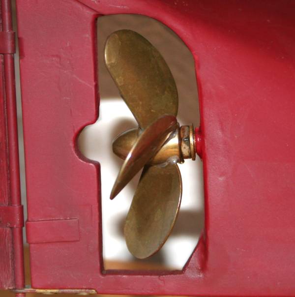

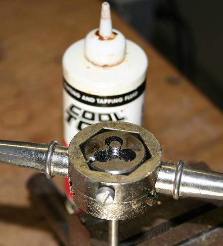

1. cutting a #10 thread on 3/16" steel rod
2. a 2-3/4" prop on a #10 thread hand cut on stainless shafting, has run for 10 years.
Pat M

Well patman, this morning I went to lowe,s and saw a chart #10 = 0.190 and I knew the 3/16th was 0.1875 so I figured when Dumas says 3/16th shaft with 10-32 thread they really mean 3/16th shaft with a die of 10-32, used to make the threads. I wanted to verify this when I got home and found you "allready" vearified this to a tee, thank you.
I have two more questians:
Do I have to use the $4.19 cutting fulid, or can I use something else like oil, ect.
Will the die stay perpendicular to the shaft due to = friction or, do I just have to be very carefull. Thanks, Randy.

Randy, you can use oil. Cutting fluid is normally used with powered machines.
Yes, you must be careful when starting the die to keep it square. Once it has threaded on a way, it should remain square but there is always the chance you can cock the die so just take it slow and keep an eye on the squareness.
