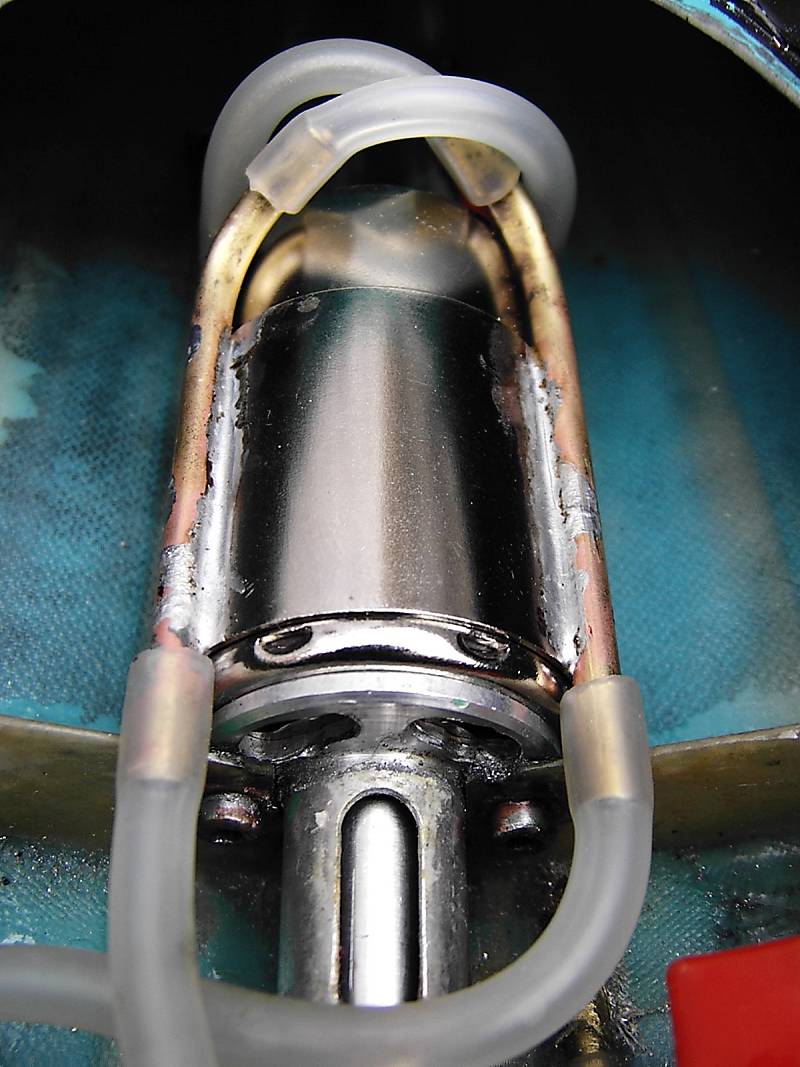

Well, I recieved mine today, looks pretty good, I have a stupid questian. Is this a good way to cool. Run the intake tube from just behind the prop and run it threw one of the cooling tubes and make a U turn with the tube and then run back threw the second tube on the other side. Thanks Randy.
I assume the tube you mention is soldered onto the fluxring of the motor?
If so, the cooling will be minimal, but, if your motor doesn't get too hot, it will do.
We run thid type of cooling on our 600 motors, which run for 7 minutes flat out on a seven cell pack sub-C.
Regards, Jan.
