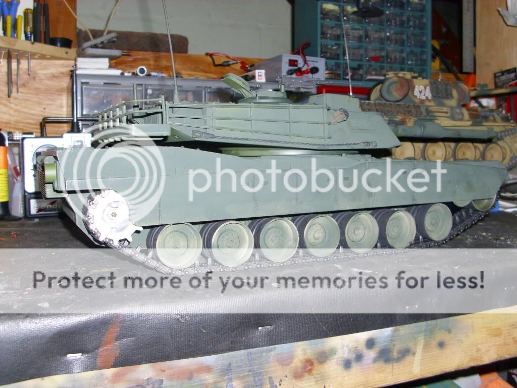

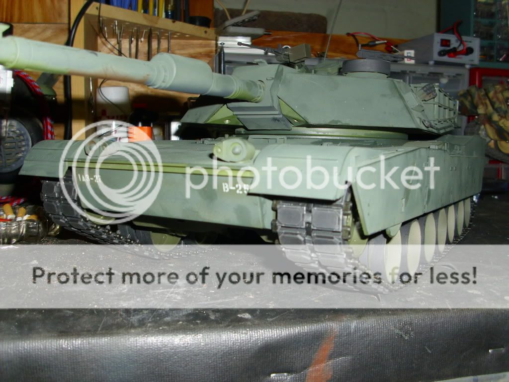

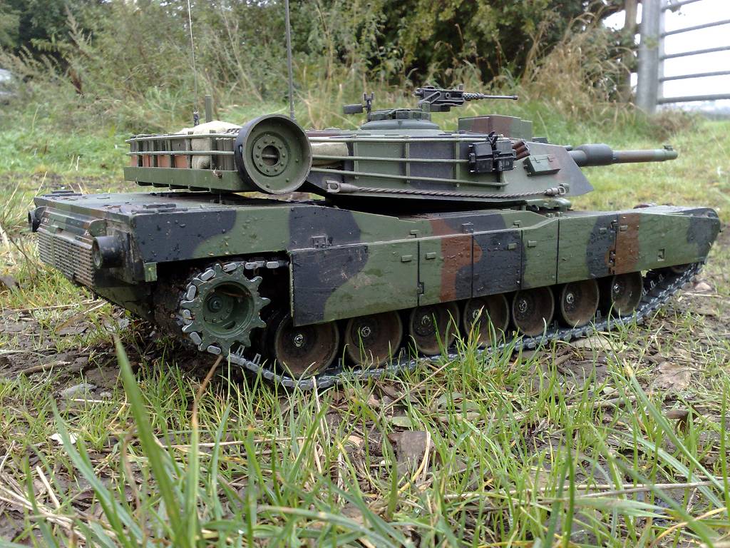

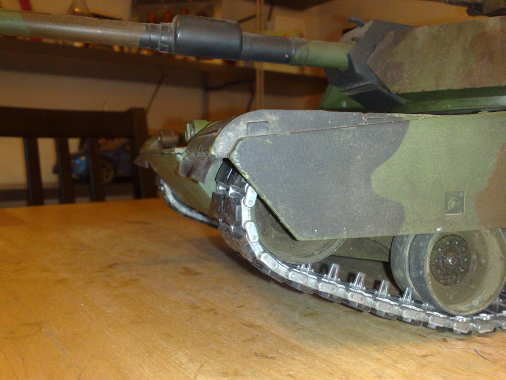

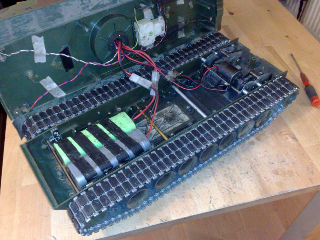

Well here we go again, its been a while since I've done any work on the abrams but since I purchased these new metal tracks and sprocket off ebay I'm ready to get to work! First I must say whilst being very expensive these tracks and sprocket are excellent quality and I think you'll agree no 1/16 Abrams is complete without them. I was also very surprised that when installed I've noticed almost no loss of speed but i will have to upgrade to 2 x 5000 mah batteries in series as the run time is quite a bit shorter now due to the added weight and beleive me these things weigh a tonne! Another positive is that the suspension sits at the correct height now and the ride is really soft just like the real thing. Anyway, the to do list is as follows and i'll hopefully be doing this over the next few weeks.
1. Finish milling out holes in sprockets, then paint
2. Correct rear light position
3. Correct front of chassis (Already did this but not happy with the angle. However will have to cut into original hull and may lose a little strength. Will use lots of epoxy!)
4. Install washer bushings in suspension arms to make arm movement more vertical and eliminate any play.
5. Check how metal axels have held up. Started to notice a small amount of play in wheels. May try to install bearings.
6. Install an inner rim on wheels in order to add strength and appear smaller. Paint original rims black to appear like rubber.
7. Somehow make the road wheel gap narrower as the track guides are narrower than previous. There's now about 3mm of play.
8. Install servo for barrel recoil
9. Install ARM module with flash to eliminate track recoil.
Please let me know if I'm missing anything important.
Cheers
Gareth

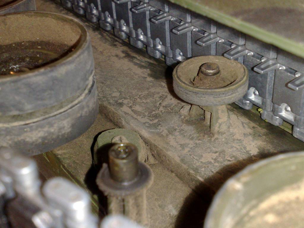

Good news, I removed the wheels and the brass tube sleeve I made for the axels hasn't worn down at all on any of the road wheels. Theres a small amount of play but is acceptable. I think once I've put bushings in the suspension arms it will hardly be noticable. I therefore won't be installing bearings so can scrap that from the to do list. I would recommend doing this to all HL tanks as well because the plastic axels are the first thing that wears out causing the wheels to wobble leading to alignment issues. Much cheaper and easier than BBearings too!

Yeah, once you've added metal boxes, sprockets and 2 battery packs like mine you'll find it rides perfectly. I actually just stretched the springs gently instead of changing them but it'll have the same effect. I did as you have done but the first wheel is slightly softer than the last but harder than the rest. This I find is the 'sweet spot' for the suspension as the back will sag under throttle. I can't wait to see what you guys do with yours. It seems a fair few members have got their hands on these hobby engine tanks now. I might even get a leopard one day.

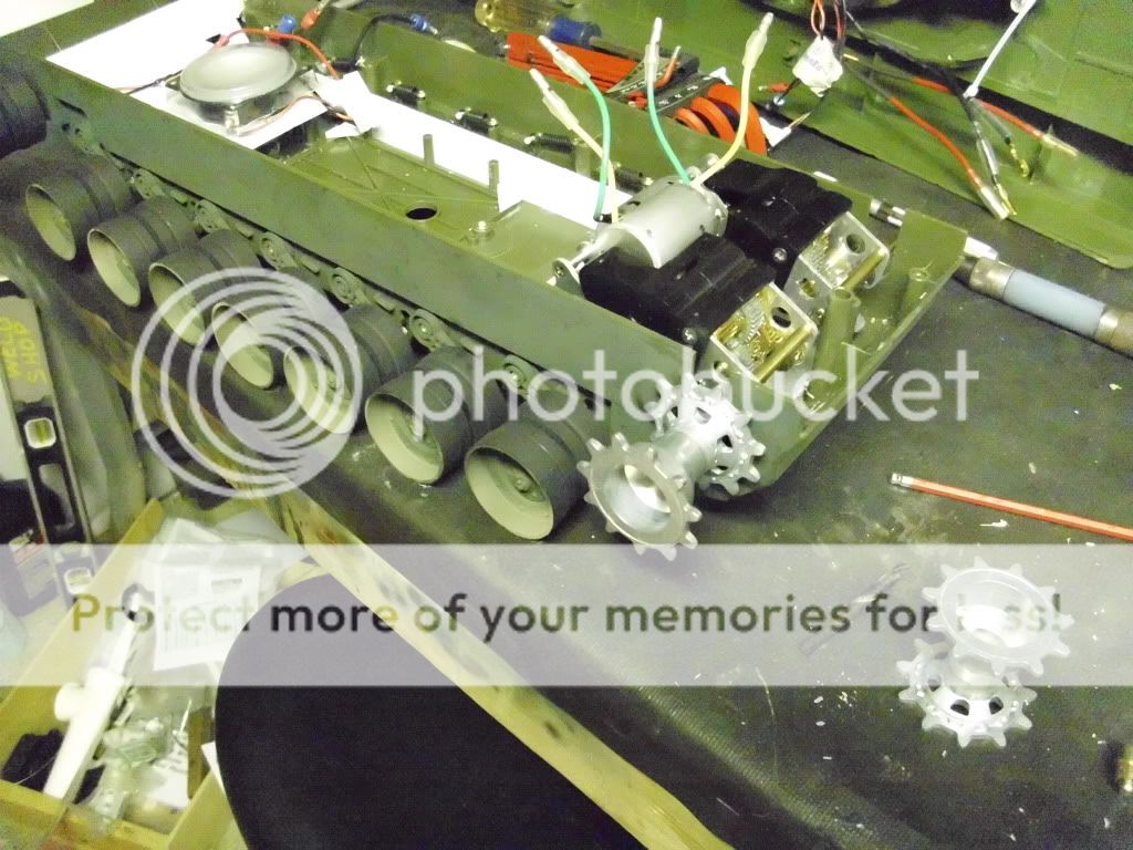

I've managed to do some of the tasks on my list. Pictures attached. I finished the sprockets and installed some bracing for the chassis useing metal tubing. I also corrected the front hull angle as well as raising the height of the front idlers. I narrowed the gap in the idlers but I'm not sure whether to do the road wheels. Don't think its really needed. I'm still wondering whether to correct the rear lights because they will be a pain to do but I guess I won't be satisfied till they are right! Fitting washer bushings in the suspension arms is posing a problem. I need very particular size washers as thin as possible and I don't know where to find them, anyone have any suggestions? Cheers

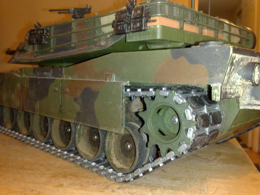

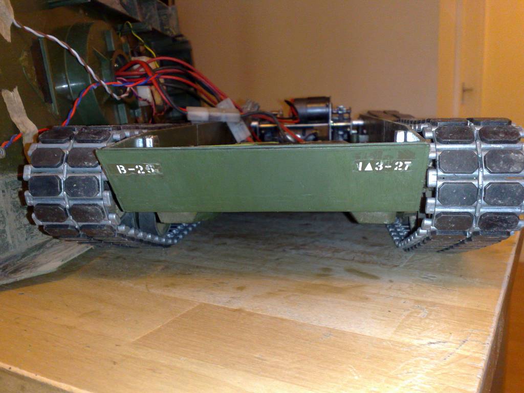

Just some new pics after taking it outside for a test run. The new tracks worked really well although with the extra weight I only about 20 mins runtime out of 2 x 2200 packs. At least if I get 2 x 5000 mah packs I may get up to 45 mins which is acceptable. I had the track come off the sprocket once but luckily due to the rear skirt being removed I was able to remove the outer sprocket to replace the track. Just like on the real thing eh!
