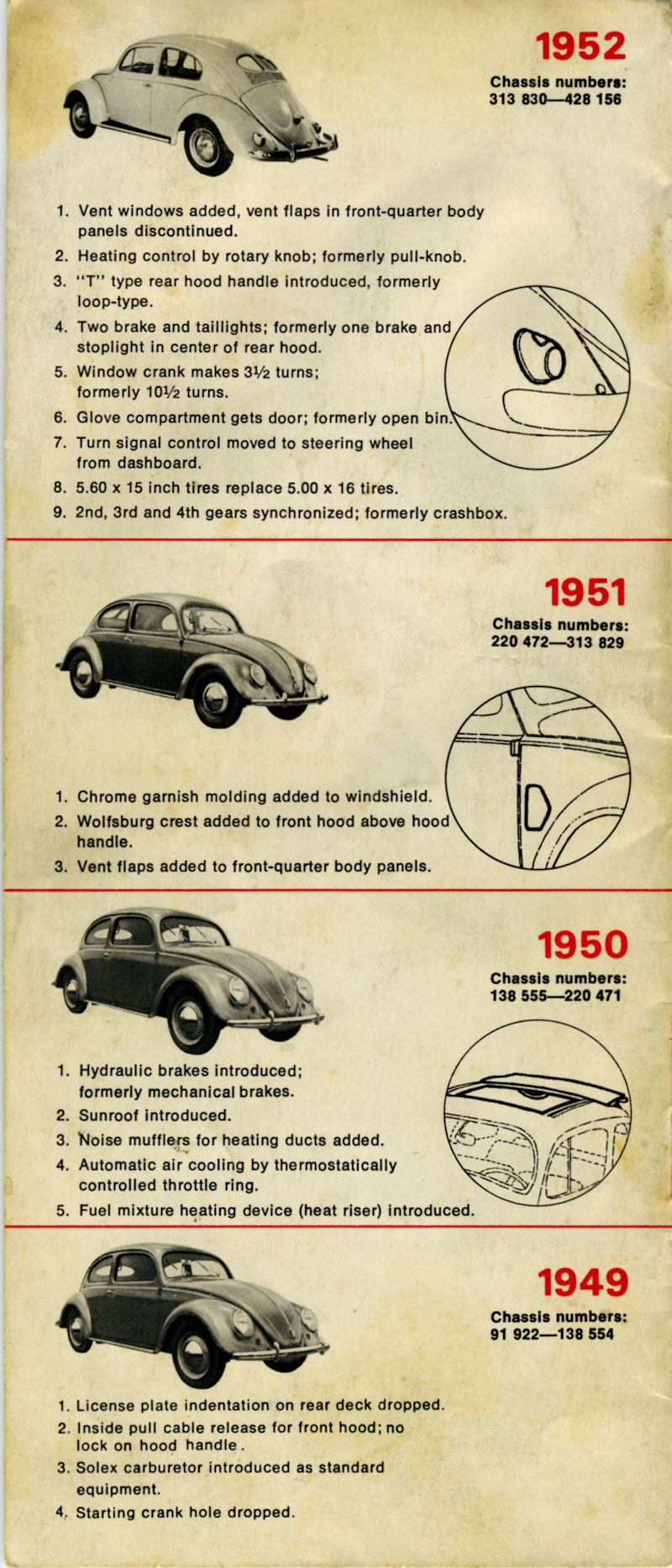

I thought I would throw this out as a little historical info. This was given out by Volkwagen of America back in the 70's ( I used to own several VWs back then).It shows some of the changes made over the years since the war.
Steve
Steve

Wow ... Nice find !
